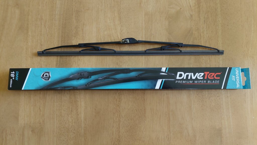

I don't know what everyone else has been doing about sourcing wiper blades but I just bought 2 blades from "GSF" (they have branches all over the UK):
P/N SMEDMW18 (GSF939NA0050) 18" Universal Single
Price £3.30 each (inc VAT)

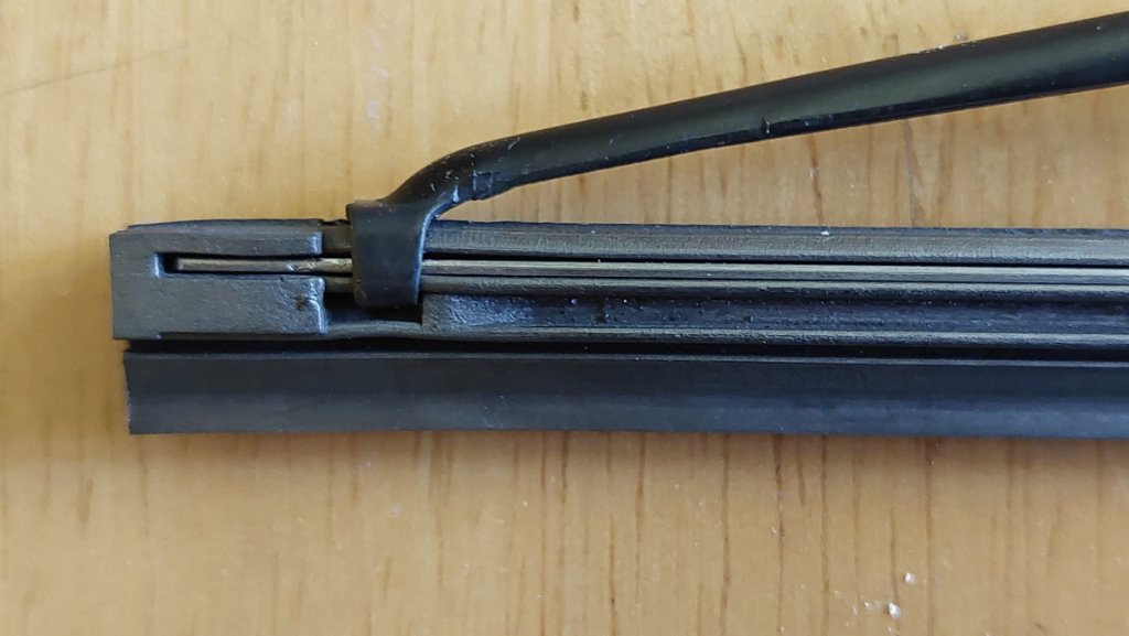

I can confirm that the rubber from this blade can be removed from the blade and inserted into the RX-7 blade. It is the same construction, with a pair of s/steel metal stiffeners and the locking arrangement is the same.
