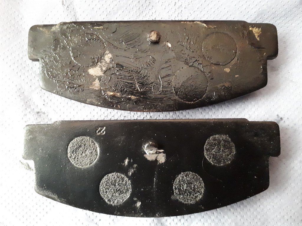

I had a slight issue on reinstalling, in that the notches in the new pistons were not as deep as on the OEM pistons and my pads had deeply inset pins so wouldn't engage. I just had to file off a portion of the pin to sort. Probably unlucky that the brand of pad I used (Eicher I think) had a pin set that far"inboard". Other pads I've used were in a better position.

Pin position, so you can see what I mean. Old pad top, versus deeper pin position on new pad, bottom. Both would work on OEM piston, but not on replacement piston.
