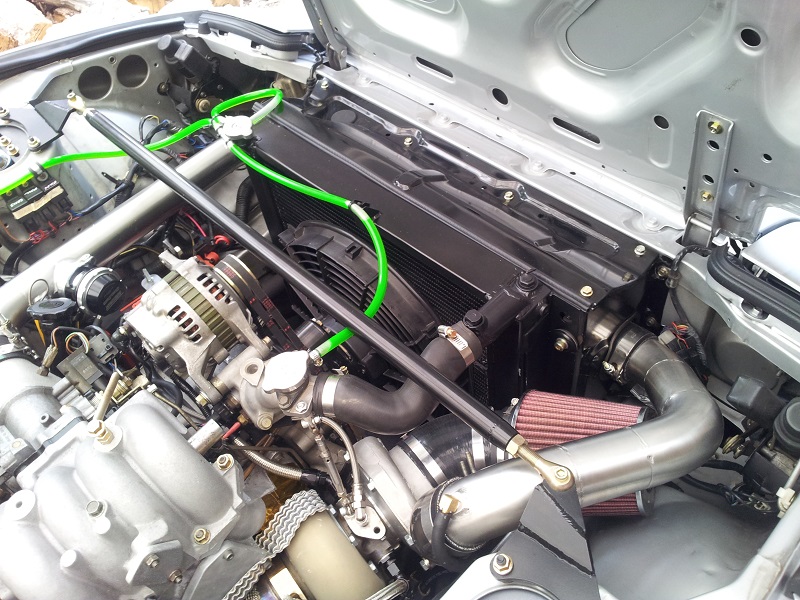

Ive got one of these Davies Craig set ups, except single 16". They work great, just follow the instructions. I've got mine set up to come on a tad above normal temp, runs until a tad below normal temp which takes about 30s on a 30c day when stationary. My hot tip is to use thermal conductive paste on the probe (if it is an "insert into the cooling fins" style one), like they use on computer heat-sinks. Get the best one you can find. I can't remember where I grabbed my ignition source as i wired it up a couple years ago and its all wrapped up now, but it doesn't matter as long as its a turn key ign source because its just a trigger for the relay. The power should be wired direct to battery with a fuse and a good clean earth.

Joe Blow wrote: My hot tip is to use thermal conductive paste on the probe (if it is an "insert into the cooling fins" style one), like they use on computer heat-sinks.
thermal conductive paste on the probe should not withstand cleaning the watercooler with highpressure cleaner and the paste sucks mud and oil. Better you put the probe inside of a watercooler.
But as i can see on your fantasic car picture th: you have finished the heatshield for the turbo. Any update in your thread?

Yes you are right, a probe directly into the coolant is ideal, but i had this e-fan set up on my old radiator and i knew it works so kept it (for now). The probe is completely captive in the core as there is a cap either side, so not too much danger of contaminating the thermal paste, and i dont let pressure washers near my car lol!
Thanks for kind words, yeah i've been keeping a low profile, will update my thread soon!
