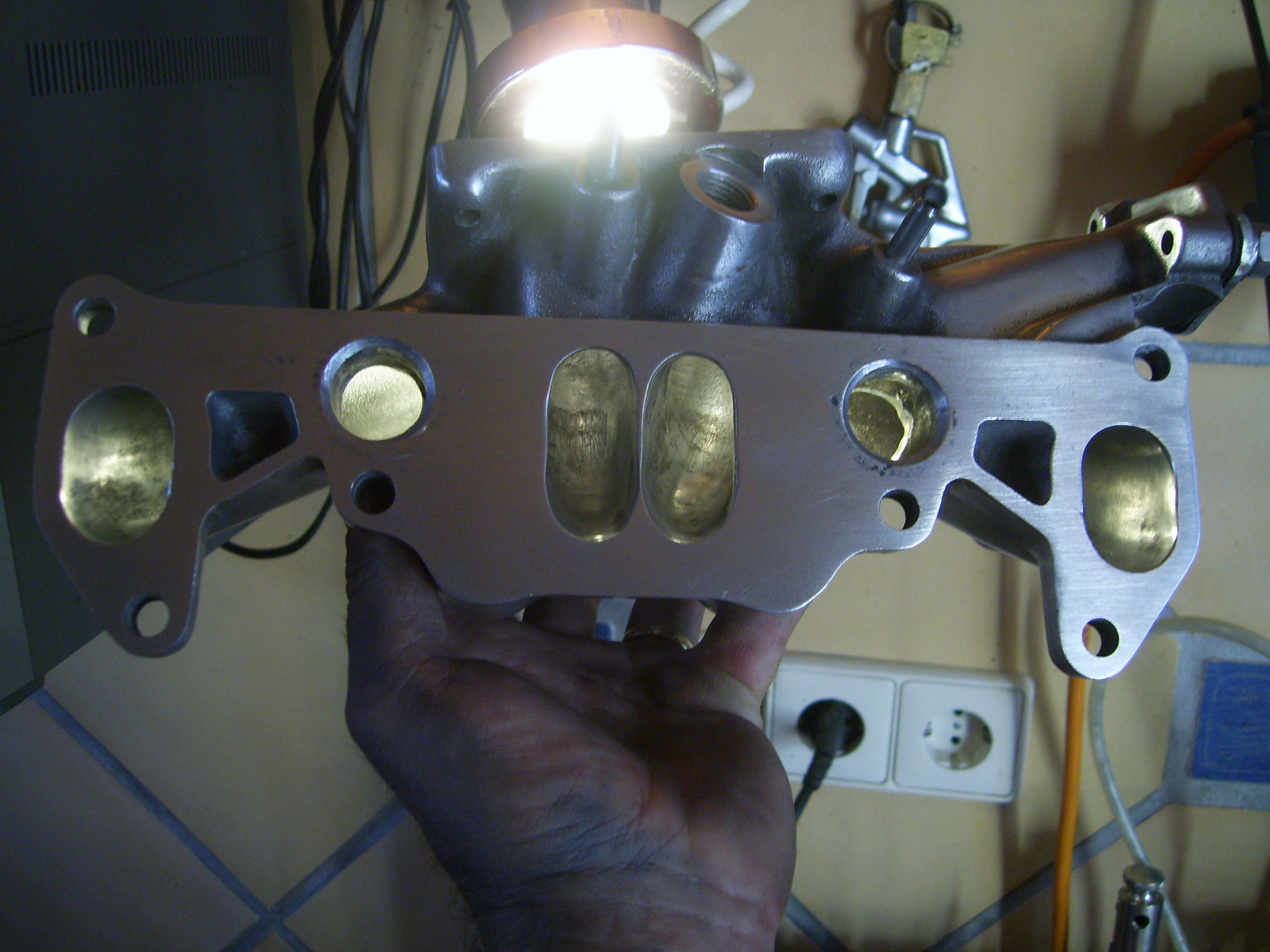

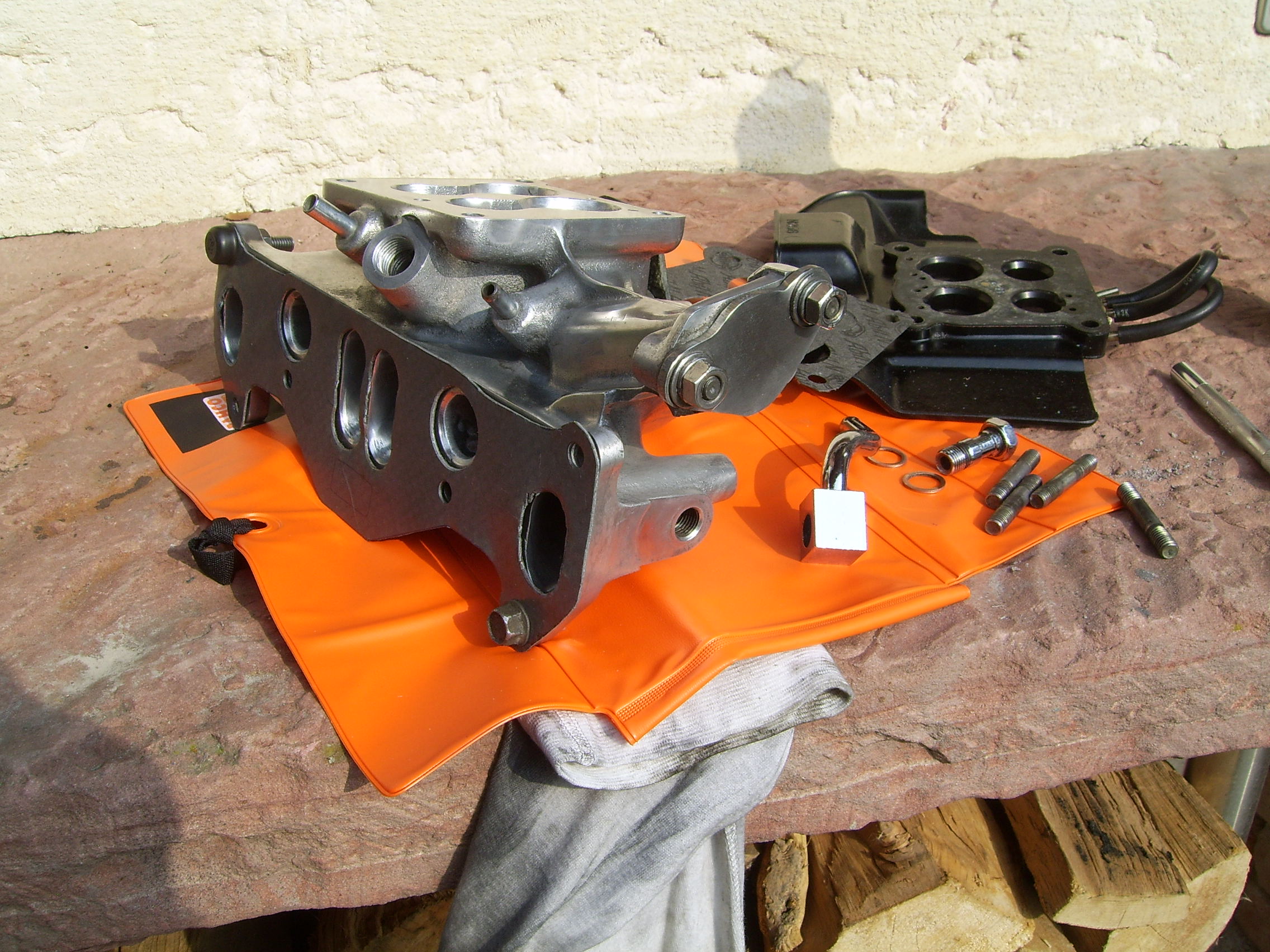

I have made the same experience. So i go the long way of pain modify the nikki. Fuel injection 13B is a very good choice. But i like the simply mechanical of the carburator 12 A. Here are some pics of the Holley 6 Port 12A. Sure not a daily driver.

douple bumper Holley 650 mechanical secondaries,dual accelerator pumps,2 corner idle adjustment, built in 1981. RB never built 12A intake manifold with semi port so you have also made them by yourself?

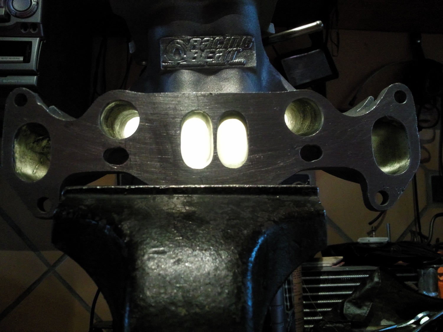

Yes but mine does not look as good as yours,i see you have opened up the coolant passages also
SE Survivor wrote:Yes but mine does not look as good as yours,i see you have opened up the coolant passages also

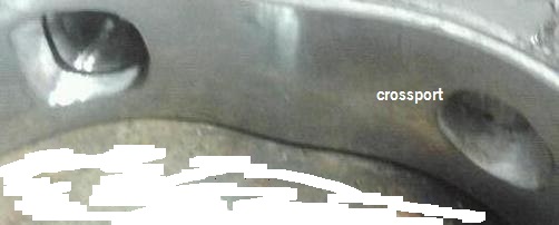

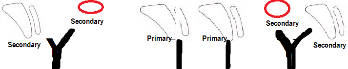

You are wrong they are no coolant passages anymore. The passages feed two hungry little periphal ports. Active it seems i am going to do what no one else do before. Building a nikki intake manifold to feed 20 mm cross ports and bridge ports with the nikki 2 x 31 mm secondaries.
crossport Nikki.jpg (23.51 KiB) Viewed 9410 times

Sounds very interesting Thomas, good to see you are experimenting. Are you going to separate the runners in the manifold so one runner is for each of the 4 ports? ie Nikki primary serving rotor 1 is for bridgeport, Nikki secondary serving rotor 1 is peripheral port. Or is this modification for maximum power at high revs with side bridgeport and peripheral port sharing the airflow?

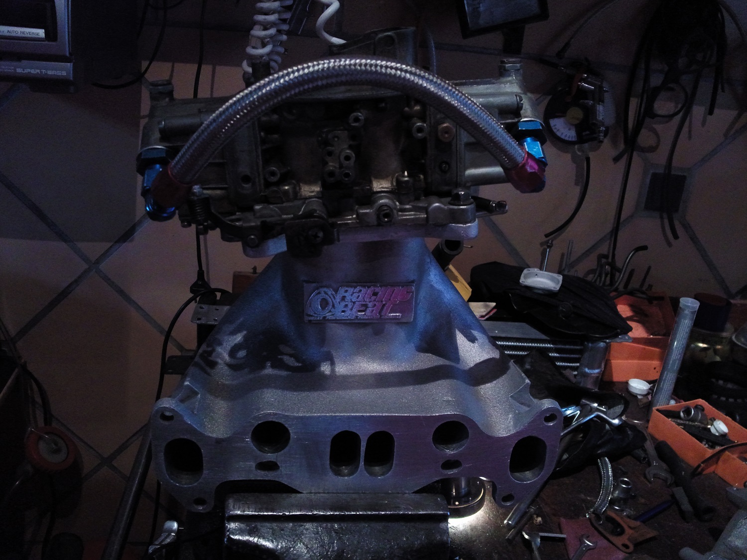

Now that's an original idea Thomas. How far along on this project are you,are you doing the mods to the engine in your car,or another engine? Mike.
I am in austria visiting the 6 international Rx 7 Meeting these weekend. Test my engine so i back at home finished the carburettor jetting.
Nikki Manifold.png (28.99 KiB) Viewed 9347 times
