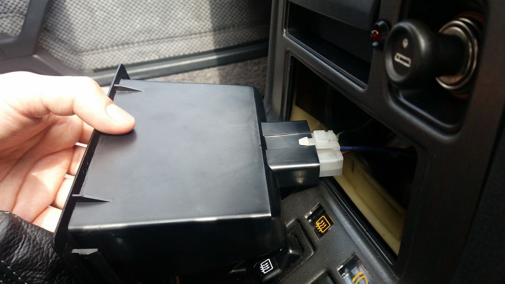

I had an annoying thing happening where my sidelights were always on. I found out when people mentioned it on Nik's thread that it went away when unplugging this connector from the centre console cubby-hole
The problem with unplugging this on my car meant that my excuse of a headunit had no power. Wasn't hard but I finally got around to finding another connection for the headunit power, meaning I can unplug that cubby-hole plug. Woo no more permanent sidelights! The little things aye :lol:

That cubby box connector/sidelight thing is one of the weirdest things in a long tradition of Mazda weirdness :? It makes my feeble brain hurt :lol:

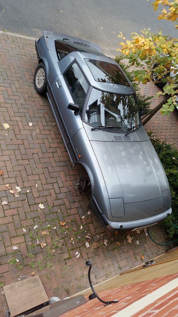

Went for my MOT a few months ago at a garage I done some work for last year. Passed but was mentioned I may want to change my track rods sooner rather than later ;). Ordered whole new ones from Rockauto for pretty cheap. Also got an Exedy clutch kit and rear caliper rebuild kits since I was placing an order. Love that website!
Changing track rods is a fairly straightforward thing to do. Bang the old ones out with a hammer, try to get the new ones looking similar length, put new ones on with the supplied hardware. Got an alignment done a few days later with that flashy Hunter system. Sorted.
