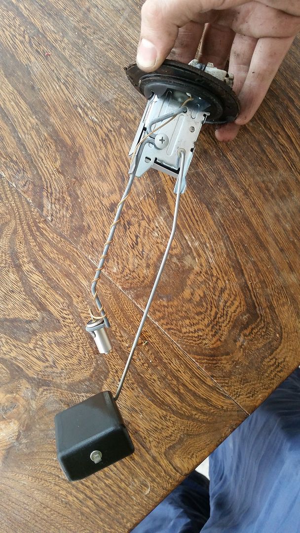

I took a drive over to Holden Vintage and Classic in Bromyard a couple of months ago for some POR15 petrol tank sealant. GT_James came along for the nice 20 minute drive also :). Knowing how the tanks for our cars get I thought it'd be a smart idea :!:. My dash gauge has always been wrong also. Reading half when the tank was full and empty when I assume its half a tank. :lol: Not sure if I'll need to replace it or what?

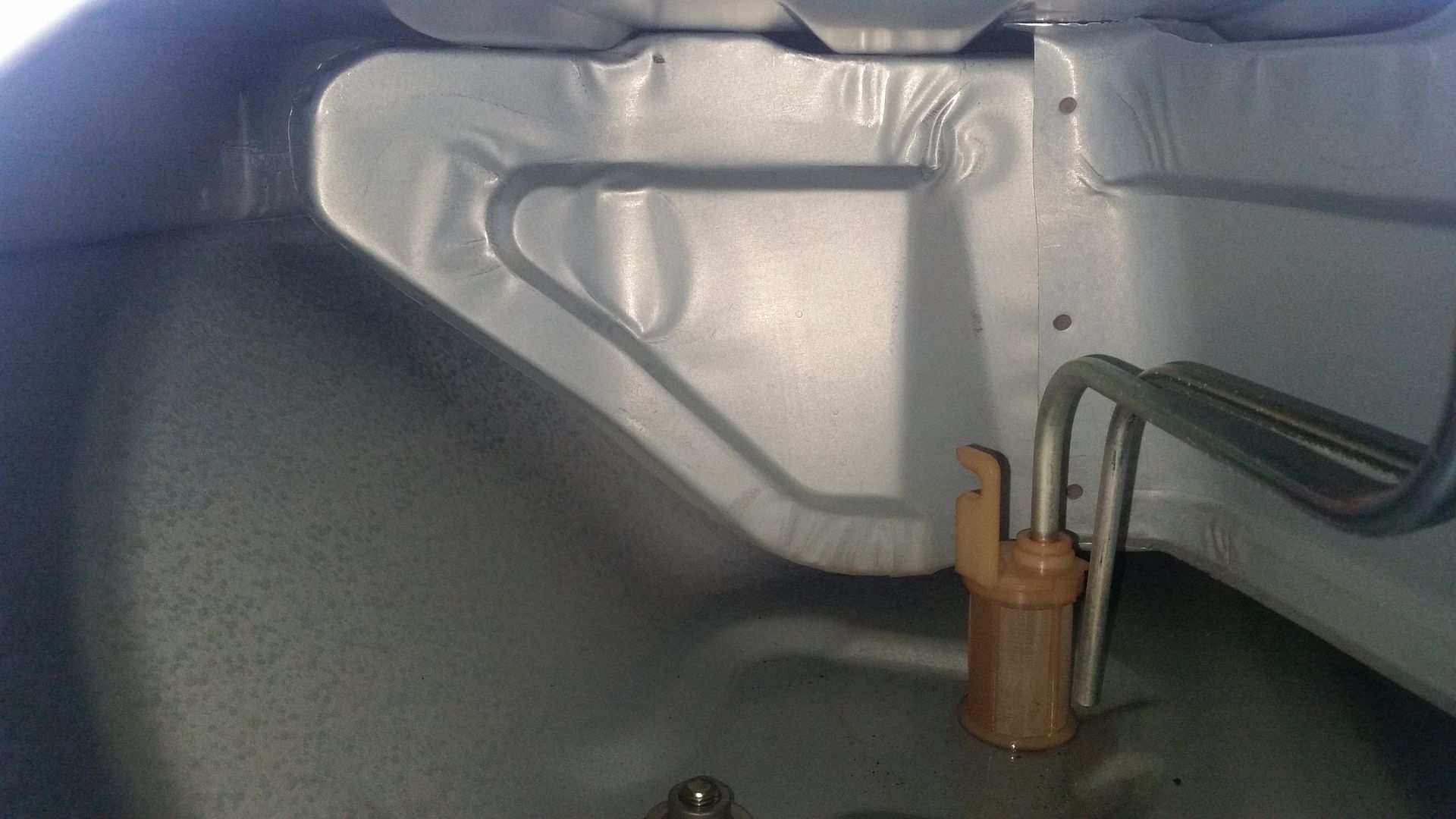

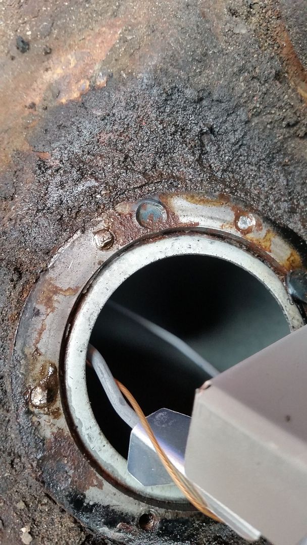

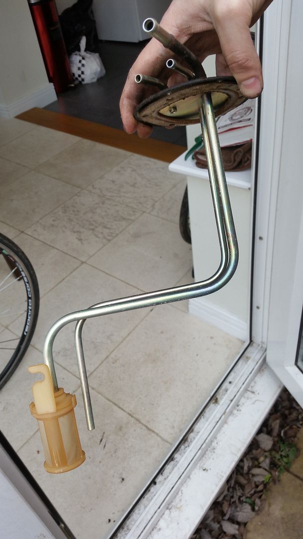

Mmmm tasty :roll:. Plenty of gunk and rust flakes. 3 of the screws holding the fuel level sensor sheared off. Does anybody have any ideas how I can get them out? I'd like to try and avoid drilling haha. Took the fuel level sender and pickup/return/vent lines out of the tank. The filter on the pickup was surprisingly clean?!

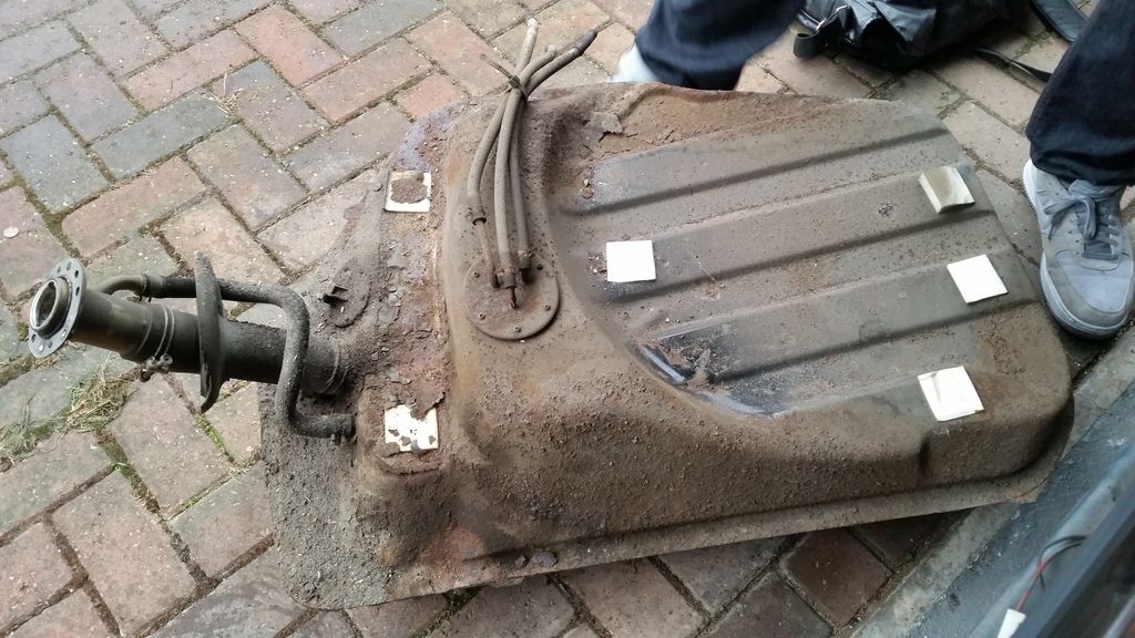

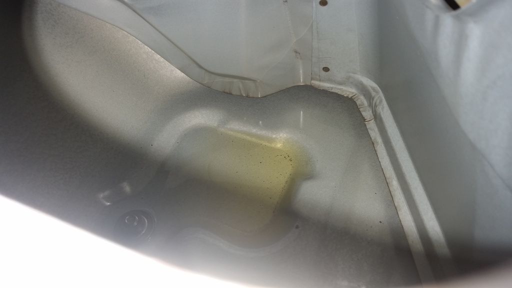

Reluctantly had a look inside the tank to see the horror that awaited :(. Sludge, grime and stale petrol yum yum.
Wait, What?! Clean as! :shock: I think the grit is from taking the sender/pickups off. It has me debating if I should even bother using POR15 tank sealant. Probably still is worth it but hmm hahah. What do you guys think?
Re: A Kiwis Series 3
that's the cleanest fb tank I've seen..... they tend to rust out from the inside out and on the top corner behind the filler.... that seems to be where the condensation forms.... to get the broken screws out I'd drill the centre of them, soak them with wd40 and then use an easyout.

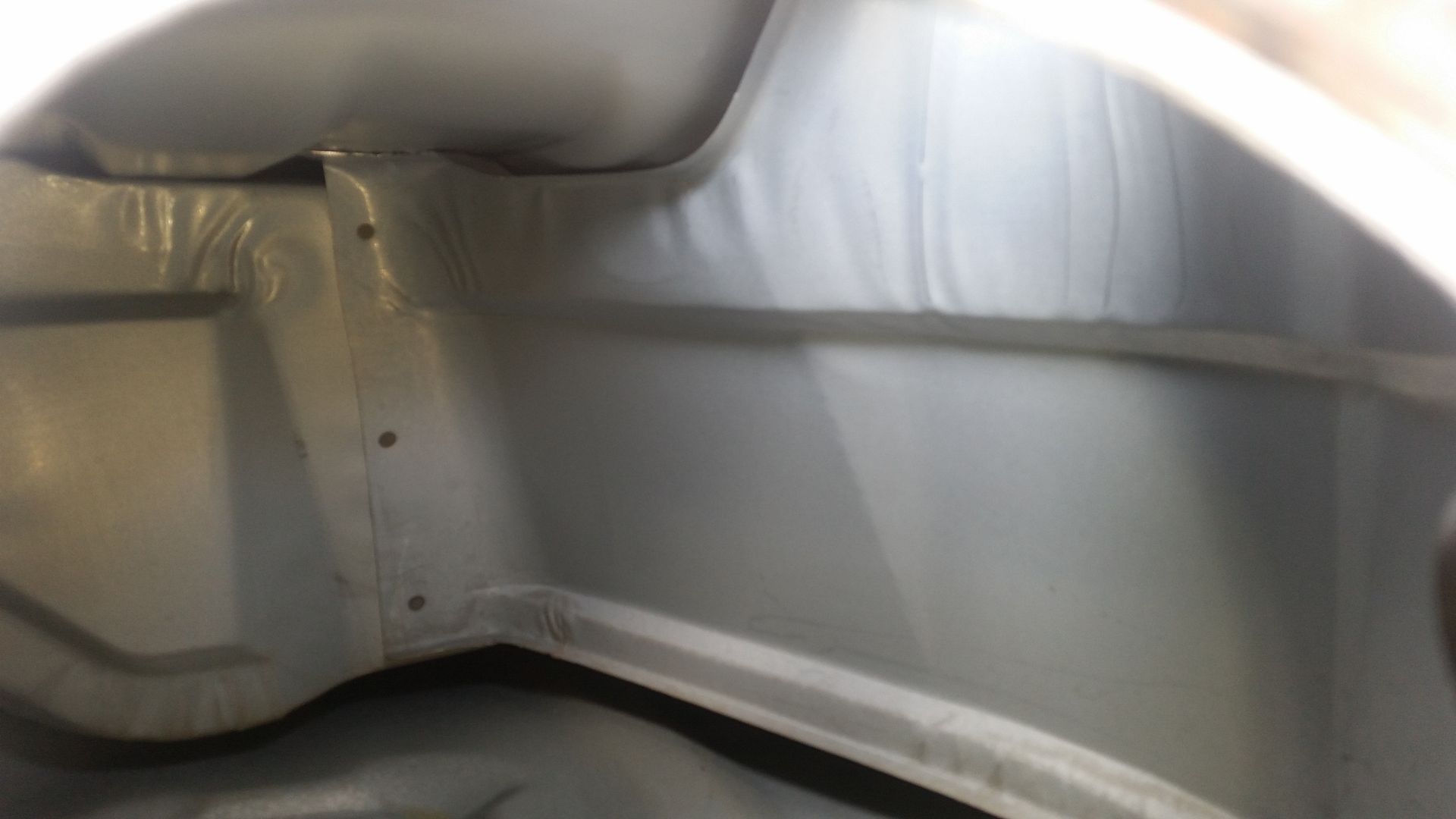

mine was the same as your, very clean and very much no rust. I threw away the screen filter cos it's old news. you can make a better sucker out of sheet metal.
find thin sheet metal .9 or 1mm will do.
Circle the diameter 30-50mm with centre punch in the middle.
cut or shearing it round shape
Drill the centre the same as the inlet tube's o/d.
put the drill onto the vice, grip it tight and panning the sheet metal into a shape of a bell( 20-45 degree will do).
Throw the old news screen in the bin.
Weld/ solder the bell into the inlet tube and deburr to blend in the remained tube/bell
it'll suck petrol lots better than a straw tube.
Fuel filter near the pump will be dirty very quick and must carry a spare at time. Easy to notice that when the engine's rev goes poorly at 5-6thousand rev and wake up to change the filter.

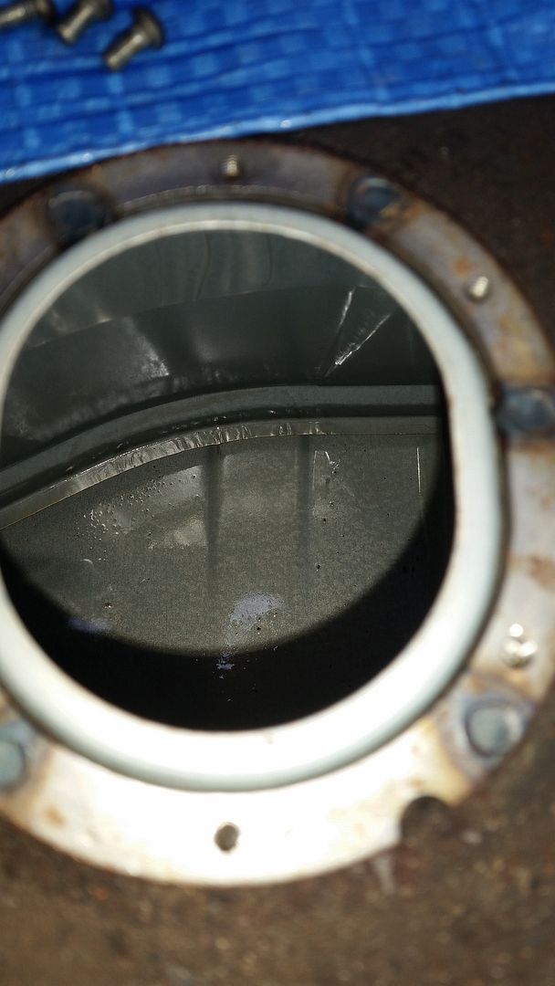

Made a little progress. Had to drill and tap those few bolts in the petrol tank. Here are a few more pictures for reference of how clean my tank is inside :o I will still POR15 the inside before it goes back together.

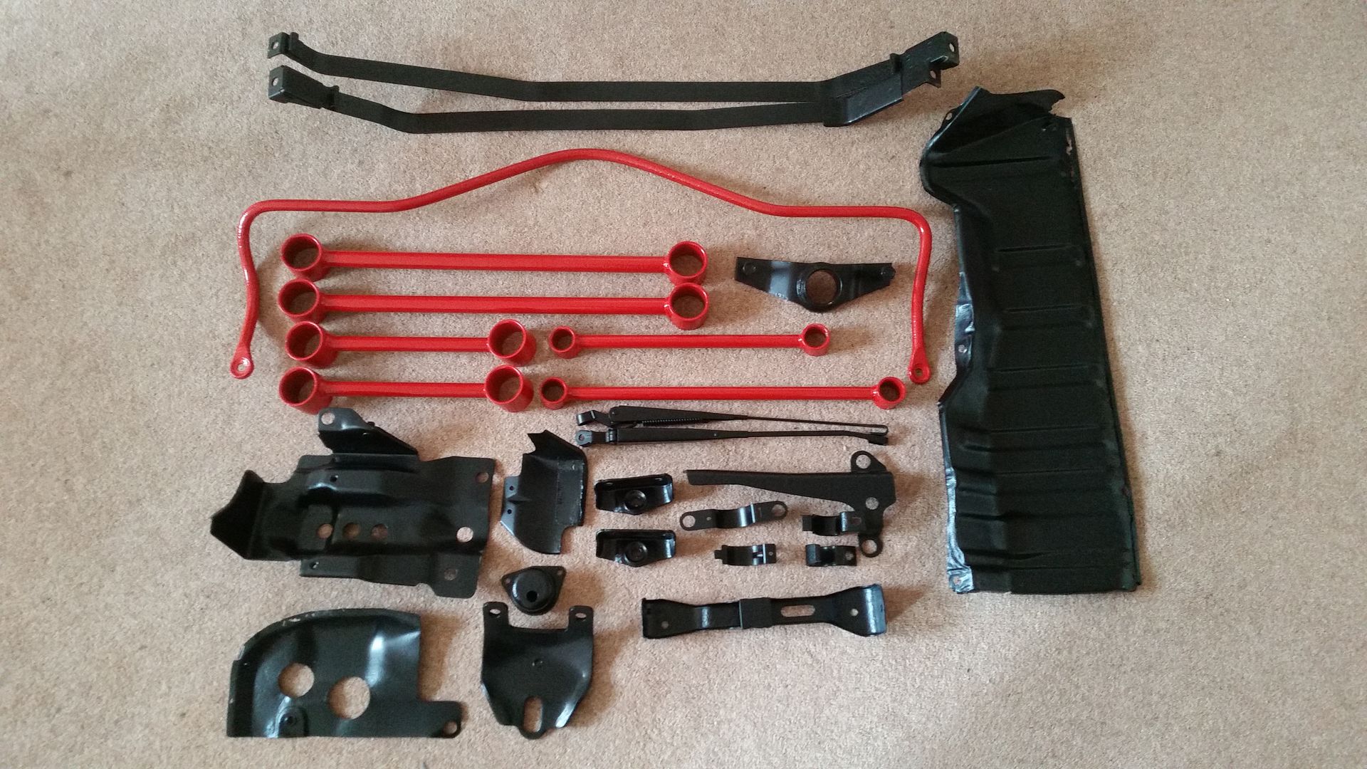

Had a bunch of rusty/grubby parts that definitely needed a cleanup and paint. I was curious to how much the local powder coaters charged for a few pieces and it ended up pretty reasonable. So I found plenty more I could take over to them! :D Before and after:
Really happy with how everything turned out. They didn't mask off any threads thought so I need to get the tap and die out. Although I half expected that'd be the case. Red makes a nice contrast I think. Probably give me a good HP boost also :lol:

Nice side mount Jesse h[b[ ..... I like the clean look this mod gives...... powdercoated parts look the biz too.... much better job than painting them
Been thanked: 187 times
The powder coated parts look the dogs s(c) I will be interested in seeing the side mount fitted, well done Jesse g-l
