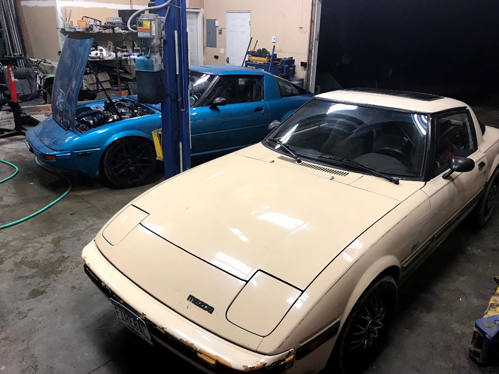

looks different ofr different lighting haha
