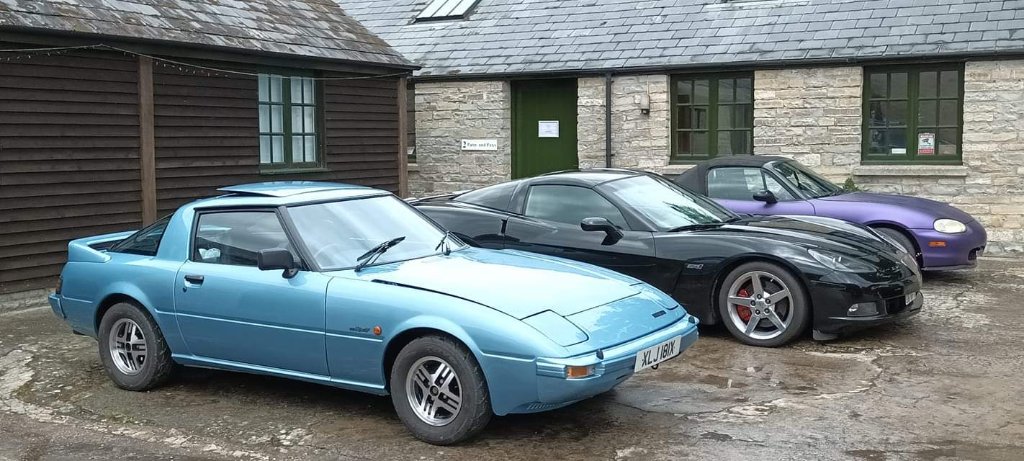

Car is finally back, it's still clunking from the rear when you go over a bump. Tim reckons the springs are wrong for the shocks, but he has other work to do, so the car is home. I did buy the racing beat lowering springs 2 years ago to go on the car, so have ordered a set of kyb shocks from the USA, so hopefully that will be it sorted and I can get back to driving it.
Hopefully get to see some of you at shows and car meets later this year.
Justin
