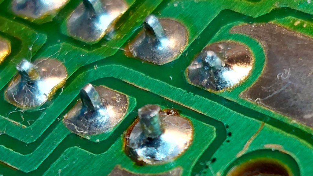

I have now fixed the current CPU with a flasher fault. A weird one. Apart from a dodgy looking dry joint to one the connector pins and a strange looking solder blob on another, all looked visually OK.
Note the cracking around the solder pad joint, top-centre, and the rather awful "blob" of solder on the pad just below. Both connect to the wiring loom and are associated with the flasher operation.

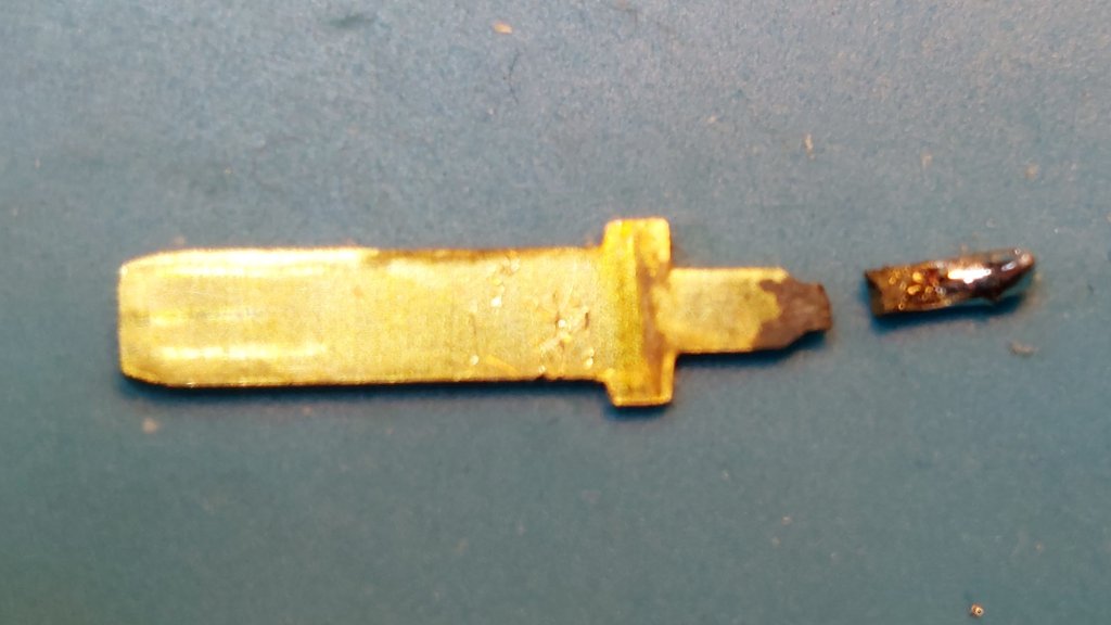

After some further testing I realised that the pin on the PCB side of the board (under that horrible blob) which goes through the board to the connector blade to supply the indicator lamps was open circuit! There was a break between the back and front of the board - very unusual.
Here is the connector blade removed - in TWO pieces, no wonder there was an open circuit, it has corroded through, probably accelerated by the high current flow to two indicator lights (or four, if hazards are on). This fits exactly with the owner's report that the indicators starting working intermittently, before failing completely. The quality of the gold plating leaves something to be desired too!

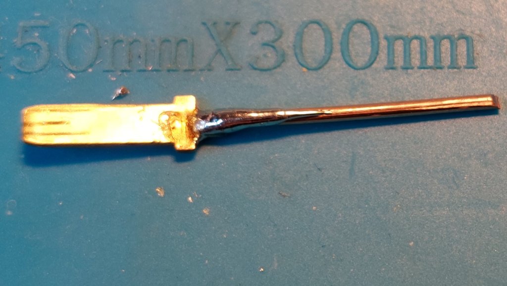

Repair involved soldering a copper leg to the connector blade and shaping it a bit with a Dremel to fit the connector housing. Ignore the 50mmx300mm on the workstation mat!

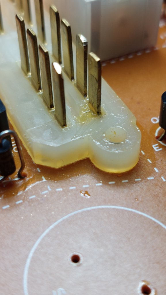

Some opening up of the connector housing was required to get a good fit, this was then back-filled with epoxy resin
Next, solder the new the copper leg to the PCB pad and re-flow the dodgy joints around it with fresh solder and flux.
