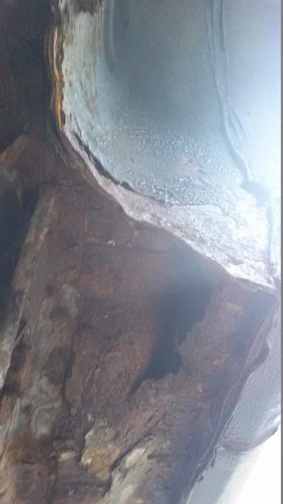

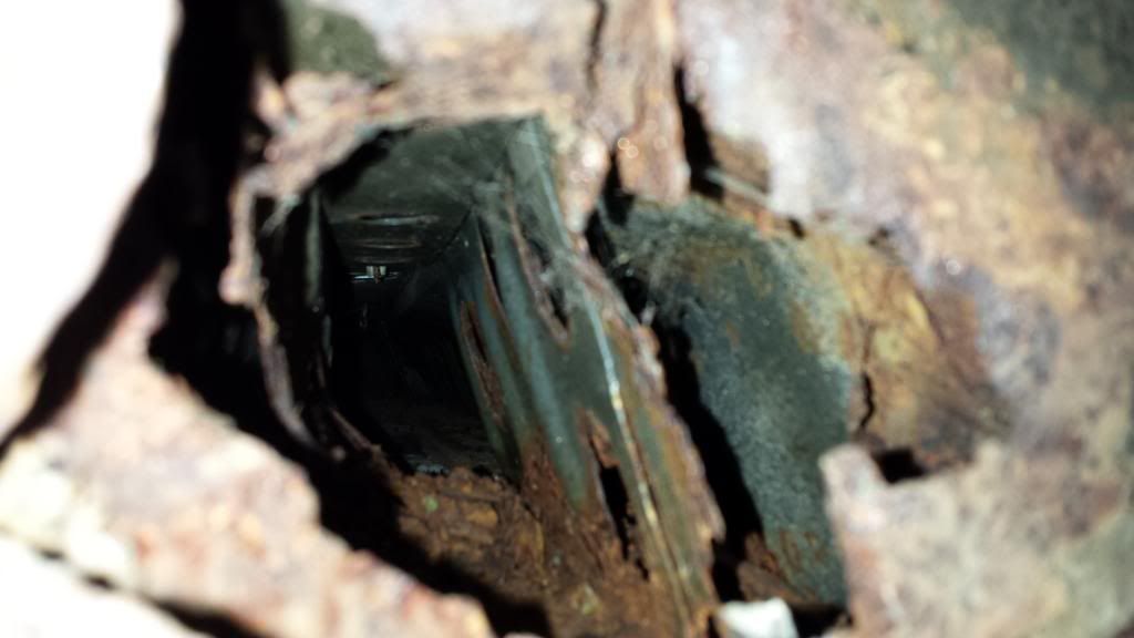

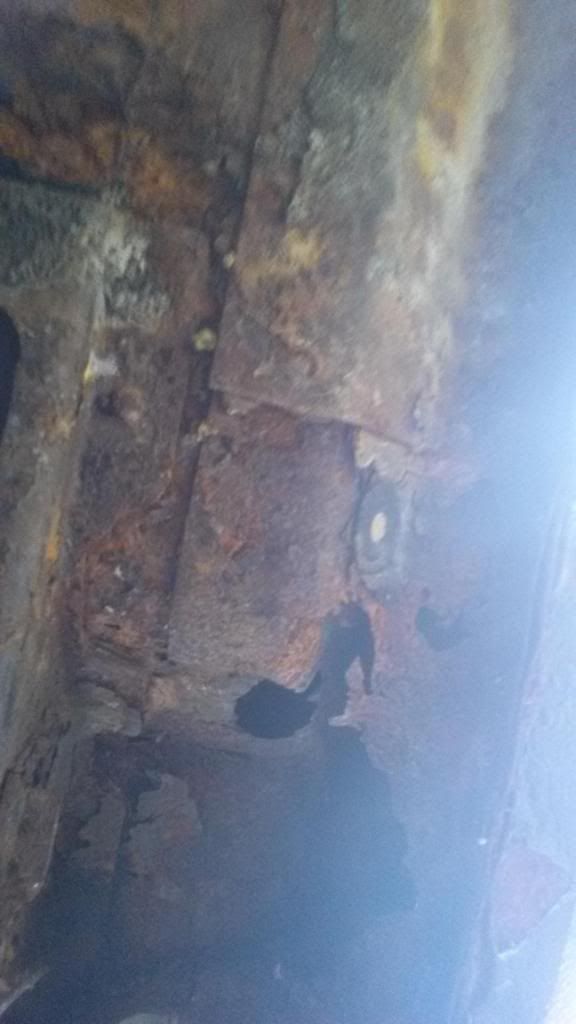

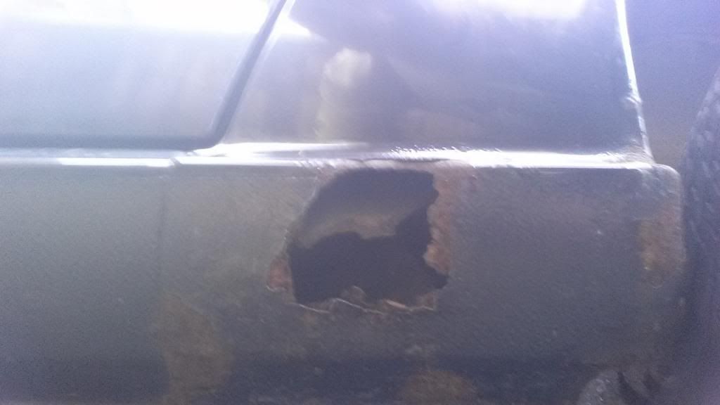

Now you know when I said I thought it didn't have much rust? I was very wrong.
Right side in front of rear wheel arch
Left side in front of rear wheel arch
Left side sill
Left side wheel arch hole with a view down the sill!
Any thoughts on way forward? I'm still thinking I will scrape off all the flakey rust then aqua steel as much as possible so it all hardens up, then get someone to come weld some patches in.

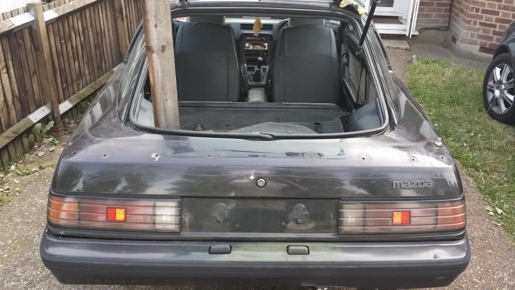

Also as a side note I've taken the rear spoiler off. I like the look better..

Pretty heavy rust there but still nothing that can't be fixed with enthusiastic welding. Regarding the starting - if she's been sat a while might be suspect solenoid. If you've got a test lamp/multimeter then unplug the small cable with the spade connector off of the starter and with a glamorous assistant see if it is getting voltage when key is turned. Then you know which direction to take your investigation.

ooohhh, lot of rust, the guys on here will know more about repairing rust like that.
i doubt that stuff you were talking about would be more for surface rust as it's very deep in those pics
and i think the fb was 1.5-2.0 mm thickness of steel in those areas, but salty roads and the years are against
you with these cars.
steve was good at repairing his gold fb and it was in similar areas, so check out his thread for an idea of
what to do. you need to cut it out and weld it all up, you can get rear sills and panels for the outside.
keep us informed of your progress and add pics as you go along. best of luck mate.

the sill is a simpler repair than the floor but both need doing properly. The end of the sill below the B post has a strengthener inside it which needs repairing as well.... a common bodge is the just do the outer sill but the strengthener is in there for a reason and should be part of any welding work.
The floor is more tricky... it's double skinned and can only be done from below.... I'll dig out some photos from when mine was done on my old car.
Any corrosion within 300mm of a suspension mounting point like this is an automatic mot fail so repairs need to be spot on .... the mot tester will have a good poke around any repairs within the fail zone.
