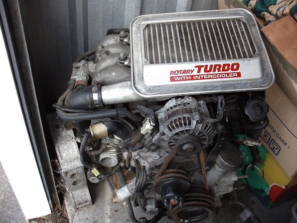

If the 12a doesn't work out I have a backup engine sitting in storage that will do the job. I got this for a series 4 I sold before I completed. Its a Jap import series 5 motor I bought around 1997 its been in the garage with the red car. h[b[
The names Plan B .... 13B

Well, what are you waiting for? 8-)
Re: Red RX7 Resurrection
There's plenty of series 5 turbo motors floating about on this forum. Between me, Ramon and Tim we must have 10, I reckon.

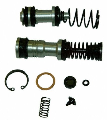

Some progress. As I'm painting the brake master cylinder and booster I intend to reco the brake cylinder at least at this stage.
located a reco kit on Amazon for $24 + $7 postage to NZ . AC Delco 18G1250 which according to the Mazda parts book is correct for the car I got the booster from. Also ordered a spray gun so I can fill and prime that rust. This weekend I will have time to get the turbo off and see what the next step on the engine is. Have had a tight deadline at work, no fun. I also want to get the engine bay cleaned and see what needs repainting.
Brake parts good
Brake parts good
I looks right, but depends if they've given you the right diameter.

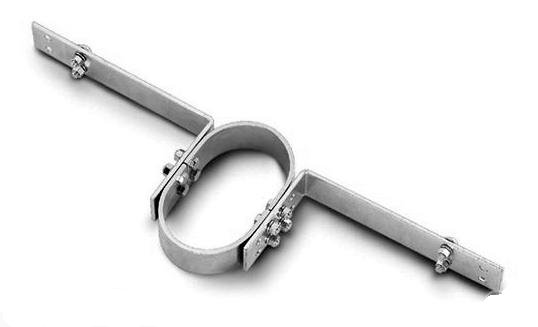

I almost forgot one item I'll have to include for the certification.
It will be item 54a. To comply with the Low Volume Vehicle Cerification rules here in NZ as the 12a Turbo produces more than 35% more power than the stock motor (105 HP for the 1978) I'll need to fit a driveshaft loop. You cant claim the the motor was fitted to the 1983-85 Rx7s as they were a different model. The only difference I can find is that the driveshaft bolts attaching to the diff are in from back to front instad of front to back as in the series 1. Also the flange on the diff the driveshaft mates to is smaller. Otherwise all parts are common. Still the driveshafts I have are likely to be as old as the car. This stuff isnt getting any newer so there is a sound safety aspect to the rule. These are ususally between $NZ50 ans $NZ70 here for a good thick item.
Chunky piece of kit

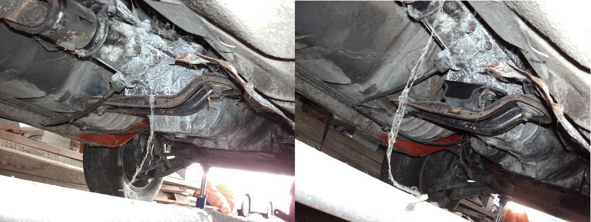

OK, finally some real spanner turning. Put the car up on stands and installed the gearbox mount properly. I didn't have one when I put the car together so just bolted directly to cross mount..
Before and after
Before and after
Raised the gearbox quite a bit and gave extra space to get turbo off. Still needed to undo the from engine mount and raise the car on the drivers side. At last it came out. Easier to put back in, can remove O2 sensor and heat shield.

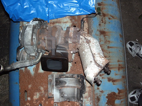

As documented turbine side of turbo is small. Smaller than earlier model. Good spoolup but poor top end and limited for high boost applications.
compact but deadly!!

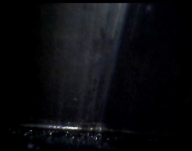

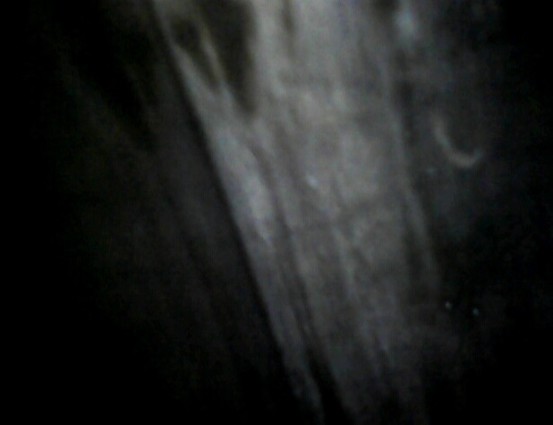

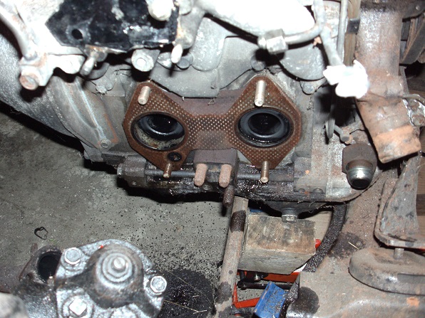

Inside of engine looks good on camera. Its quite hard to assess condition until you get used to looking for the transitions between sides, seals etc. Following are vidcaps.
apex, rotor, rotorhousing and side housing.
This one shows the apeax seals as the bright shiny line, you can see it reflecting in the shiny side housing. Camera is about 300 mm inside engine on spark plug side looking up.
side, rotor housing transition
This is the transition between the rotor housing and side housing. Looks good , no corrosion on edges. Oil/fuel mix makes assessing surface of rotor housing difficult.
I think for now I'm gong to start the engine, But I'll do a water jacket pressure test. If the water jacker holds 12psi for 12 hours I'll start the engine.

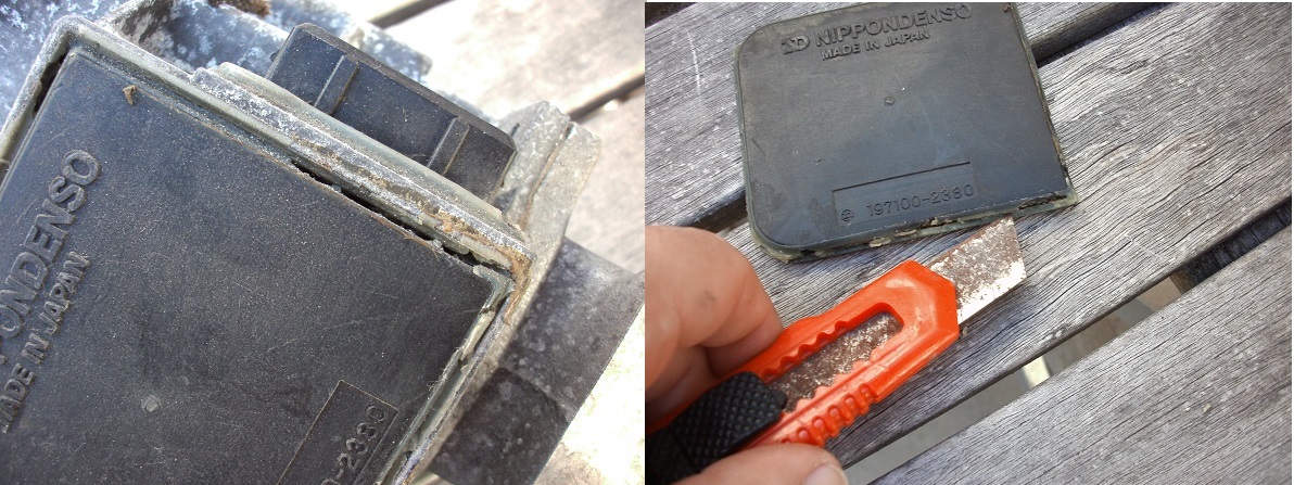

Sealing Airflow Meters
You may at some point need to open an airflow meter to determine for example if the variable resistor around the idle position is worn.
Keeping dirt and moisture out is a must so the module must be resealed. Luckily it appears that the older airflow meters at least are simply sealed with contact adhesive or a very similar hotmelt of some kind.
Certainly using contact adhesive to reseal the meter gives an almost identical result.
There will be a slight crack around the seal where you have opened the meter. To reseal a meter firstly remove all of the old sealer from the aluminium meter box and the plastic cover.
Open seam, cleaning gap

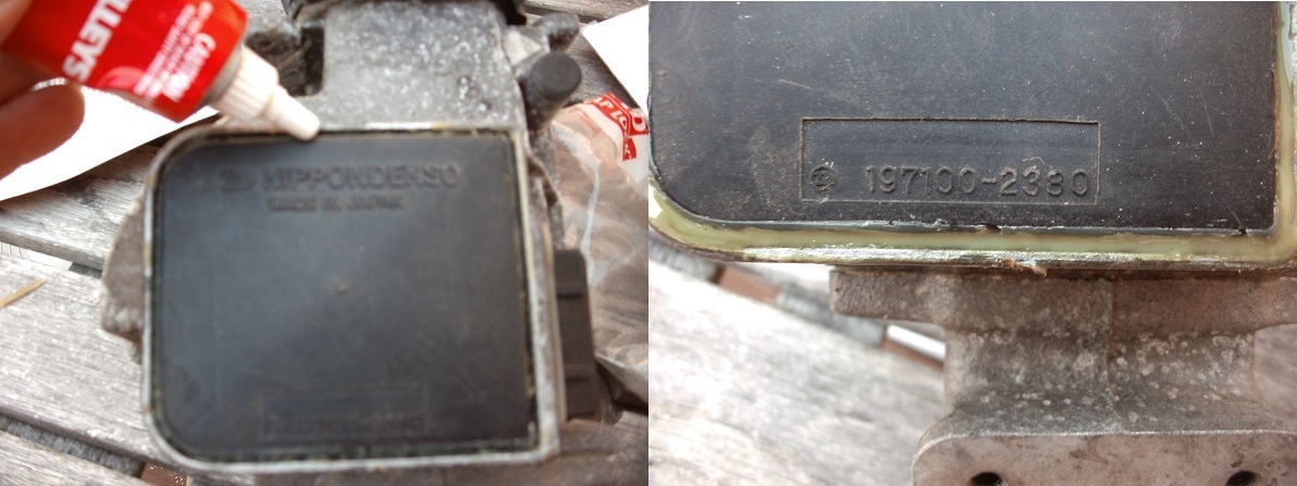

Then get a suitable solvent/rubber based contact adhesive in a tube. Start at one corner and apply a smooth continuous bead around the seam until you fill in the gap and get a smooth result all the way around. Clean any excess.
Sealing the meter and the finished item
Leave to dry before cleaning or painting meter

I'm not sure how much you can tell from those pics up the ports. Pretty hard to make anything out.
you can't see the spark plug area either, which is a must I would say.
