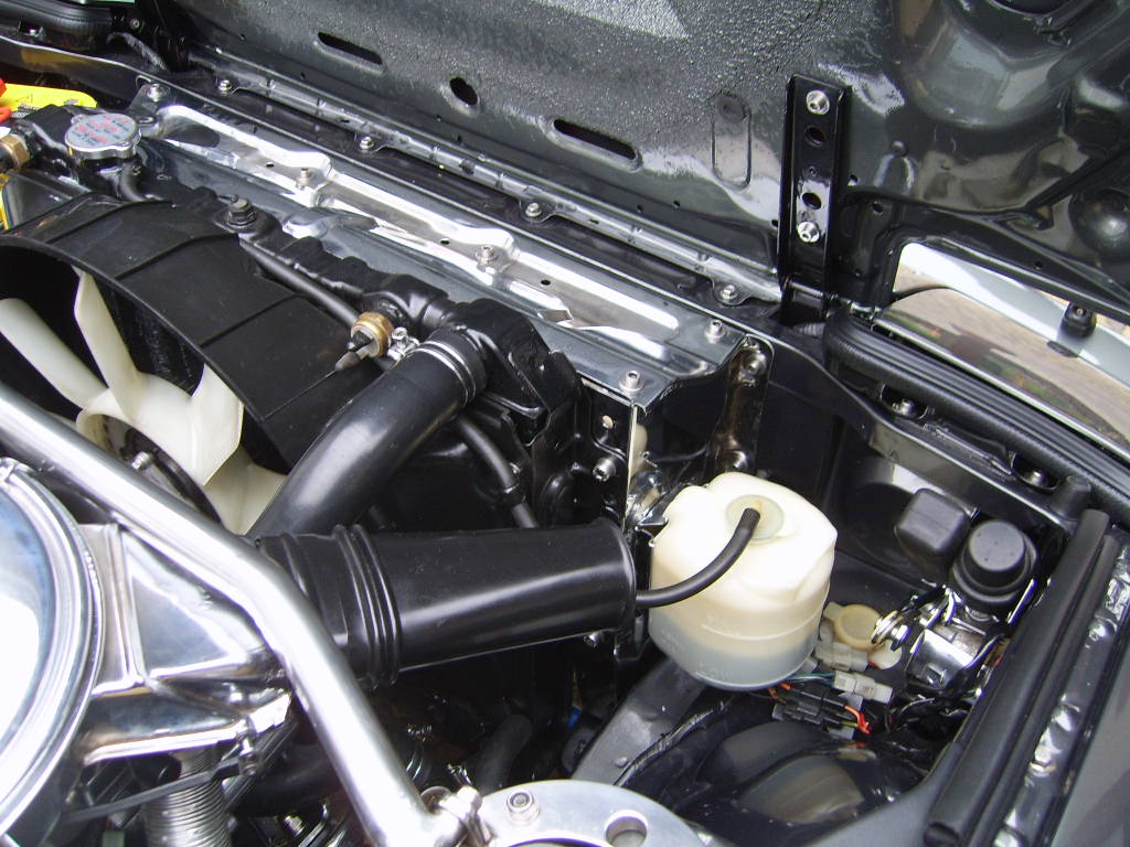

Right, I've got a new problem now.
I've re-done the wiring, exactly as I first described it but with the suggestions in Pete's post regarding which relay terminal goes where. I've got a new fan. It all works.
BUT as soon as the negative terminal is attached to the battery, there's high-pitched whine coming from inside the cabin. Is this the coolant buzzer? On the FD all you have to do is bridge the low coolant sensor to earth to stop it. This makes no difference here. As far as I can tell, the wire from the sensor isn't broken. The whine sounds whether or not the ignition is on, literally as soon as the negative clamp is put on the battery. There's coolant right to the top of the rad.

Some further troubleshooting throws up these facts;
The fan works... it comes on at the preset temp and goes off perfectly happily.
The coolant level sensor seems OK; if I disconnect the wire to it, after a few seconds the "add water" light comes on the dash and it goes out if I re-connect the sensor. But the bleeping carries on regardless.
Could it be an earth point I missed re-connecting when the battery was out? Where does the coolant level sensor wire go back into the loom? Is it earthed anywhere?
Baffled

Disconnect the Rad sensor & Earth through a switch in cabin. You can control the Fan yourself in Traffic etc, that will work to get you to RR, perhaps we can then sort out.
It sounds like it is conflicting with low level sensor.

Having now had time to study the wiring diagram it looks as if (I could be wrong) that the low level sensor is just part of a much larger control unit which controls the light/buzzer & relies on the radiator/water temp & resistance via coolant Earth.
The Fan sensor operates through the water temp & there is some current interference/leakage between the two hence BUZZZZZZZZZZZZZZZZZZZZZZ
Solution 1:- Replace Rad sensor with 2 that has a inbuilt switch (type with 2 terminals) that is isolated from the radiator & is earthed direct.
Solution 2:- Manual switch as previously mentioned above.
A second opinion/conformation would be helpful.

Something like the inbuilt switch sensor left from the water pipe or left from the radiator cap!!DKWW2000 wrote:Solution 1:- Replace Rad sensor with 2 that has a inbuilt switch (type with 2 terminals) that is isolated from the radiator & is earthed direct.

You could find the buzzer unit and disconnect it ... either under the dash or in behind the center console. If I recall correctly, the coolant buzzer is intermittent. If it's constant, then it's the 'headlights on' buzzer.
Is it sounding even with the ignition off?
