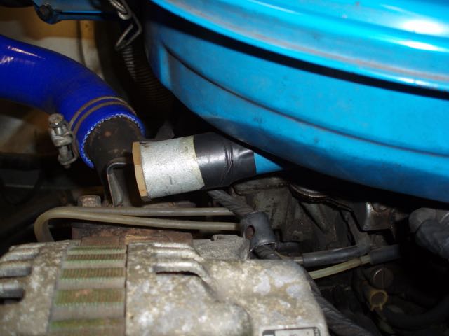

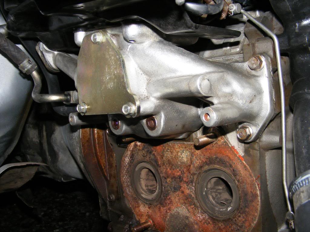

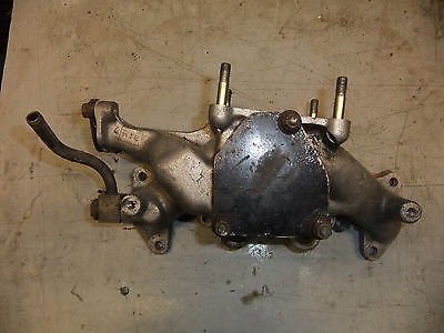

Here you go Boggy Bog:-
I don't think there's any other pipes to blank. I couldn't bring myself to crush the pipes in a vice like it said to do. Instead you can see I'm electrical.......Ha Ha. Works fine though.
Hope that helps
codge (Dave)
Hope that helps
codge (Dave)
- Reactor Blanking - 1 (3).jpg (41.52 KiB) Viewed 4934 times
- Reactor Blanking - 1 (2).jpg (32.5 KiB) Viewed 4934 times
- Reactor Blanking - 1 (1).jpg (41.73 KiB) Viewed 4934 times
- Reactor Blanking - 1.jpg (44.65 KiB) Viewed 4934 times

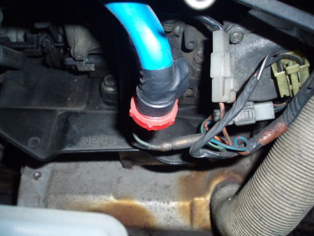

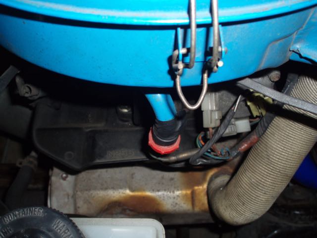

Hey there, thanks for the info and the pictures!
Sorry I am still not getting this, I have blocked the ones you have said. But I still have more underneath.
One tube is still attached to the engine just above the carb, and the other has a tube just hanging in space. Do I block both of them off as well?
I also have a tube coming from the air pump, so do i attach that to the tube coming out the side of the manifold?
I have tried to attach some pictures, but no joy sorry.

Blanking off the pipes from the air box is just cosmetic. Leaving them open isn't a big issue.The hoses to the air box are mostly connections from vacuum sources. It's the sources that need blanking off. You may well have a unplugged vacuum source that is leaking.
Also, if you've removed the thermal reactor then there is no need for the air pump. The air pump is only there to feed air to the reactor.
