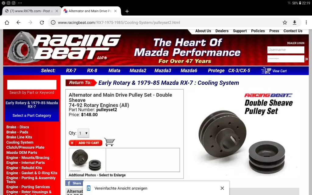

Pulley Set with timingmarks.

Got to say there a few design flaws on this pulley kit, it was a nightmare getting these bolts out quarter turn at a time, couldn't fit a socket in!
So next stop for the engine issues are fuel filter (of course I have to order it, no one local sells one), and see if removing the Gilmer and going back to the original pulleys has fixed my vibration. I'll test it with and without the viscous fan.
