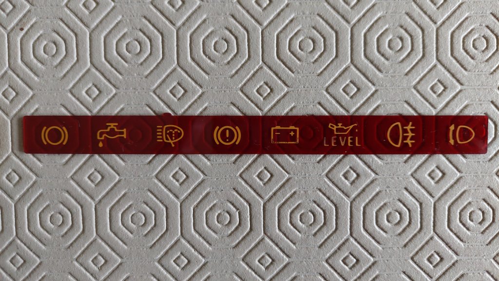

Just adding a bit more to this topic for reference. On UK models the warning light strip contains these items:
Warning light strip.jpg (171.87 KiB) Viewed 11027 times
From left; brake fluid low, coolant low, washer bottle low, stop lamp failure, charging failure, oil low, fog lights on, headlamps (flash as raised and lowered).

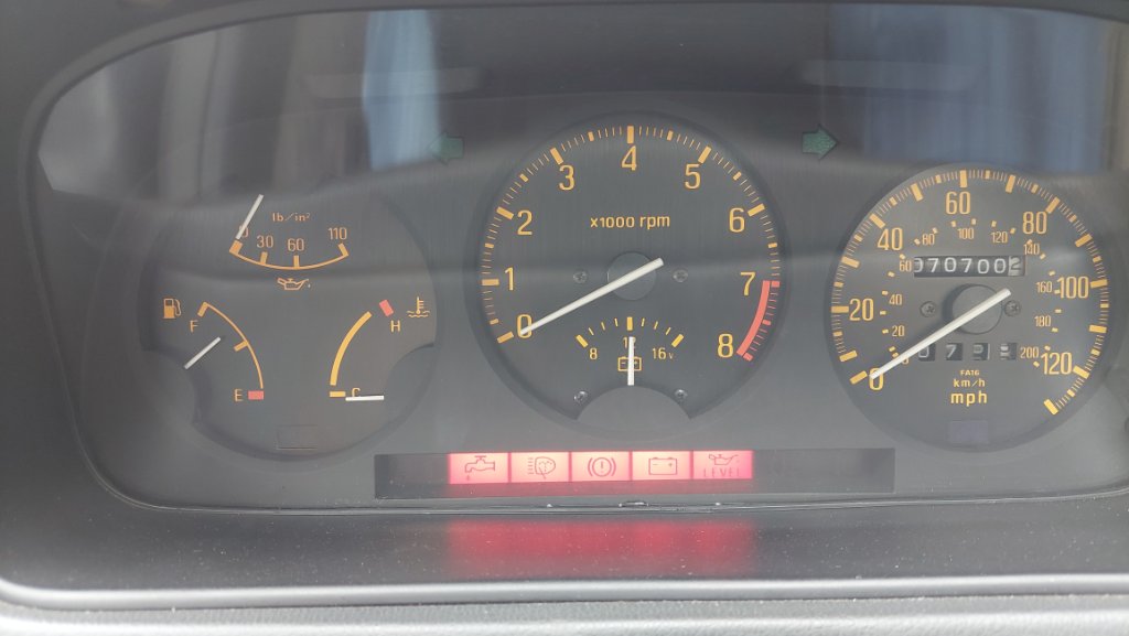

With the ignition on, this should appear:
Warning light strip illuminated.jpg (82.88 KiB) Viewed 11027 times
If I've mis-described anything, please post up :thumbup:
