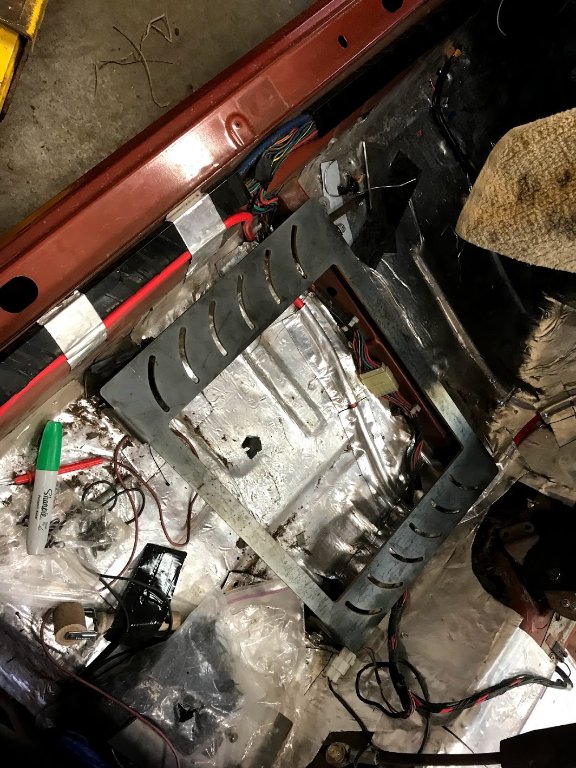

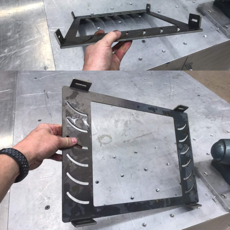

decided to use the rx8 seats I picked up for $100
so now to mount them.. paying $140 / mount seems crazy so I made 1 of my own...
