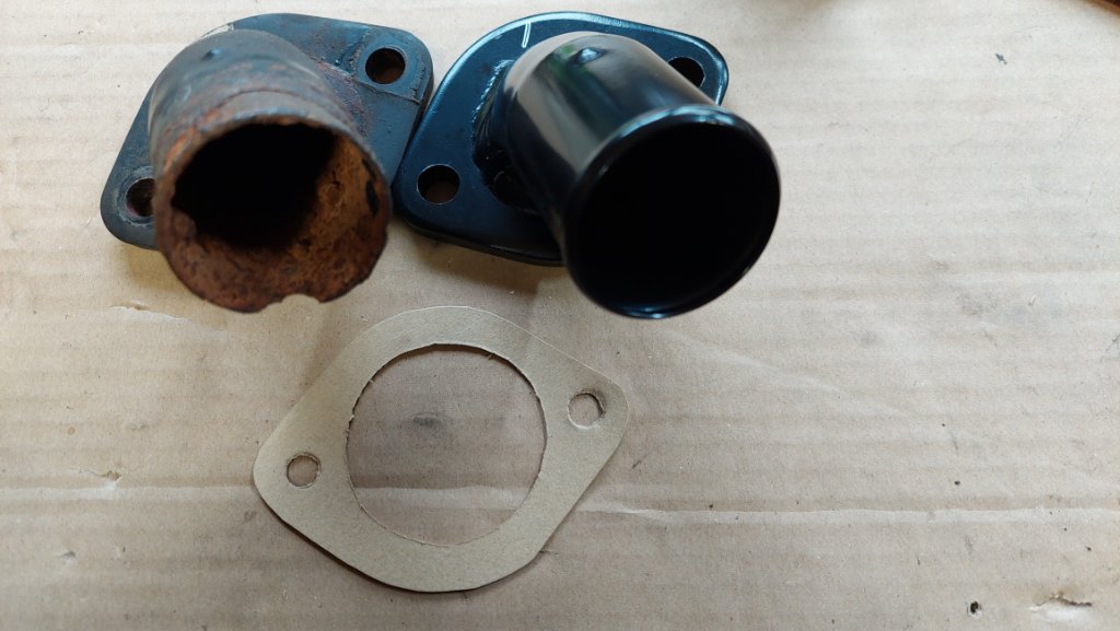

The new thermostat elbow, versus the old one, with new paper gasket - I hope this will be OK, as I noted from a parts list that it should be a metal crush gasket? Seems a bit overkill...?

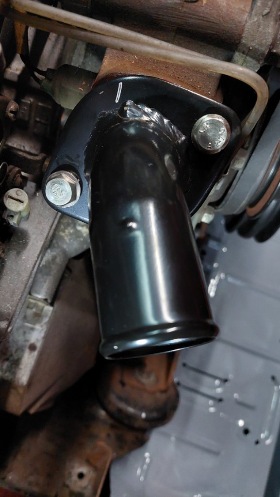

Now fixed with s/s bolts. I managed to tap 7 full threads into the bottom of the lower fixing hole. Using a slightly longer bolt, some careful measuring and a washer, I 'm maximising the use of those threads. Looking at the original bolts, it appears about 7-9 threads were utilised. Both bolts tightened up nicely. Proof will be when I look for any leaks later! I tested the thermostat too, which is operating to spec.

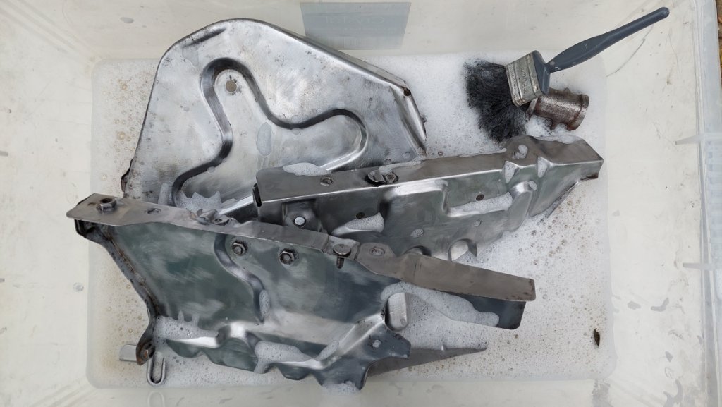

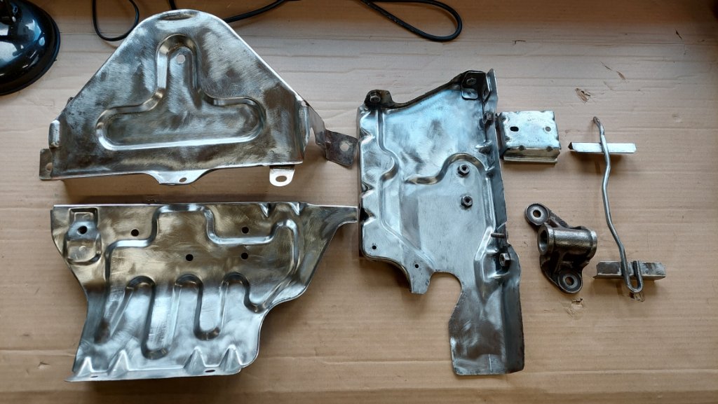

Rad surrounds, battery tray, battery clamp and idler bracket all returned to bare metal:
2021-10-19 14.27.13.jpg (127.24 KiB) Viewed 4362 times
First part of POR-15 full treatment, a thorough degrease in hot "Marine Clean":
2021-10-19 14.46.52.jpg (102.95 KiB) Viewed 4362 times

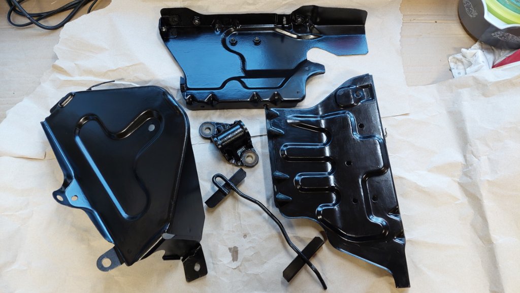

That was followed by 30 minutes of soaking in "POR-15 "Metal Prep", thorough drying, then 2 coats of POR-15 "Chassis Black". The finish isn't as good as I'd like, but not much is visible, and I'm more concerned about keeping corrosion at bay then appearance:

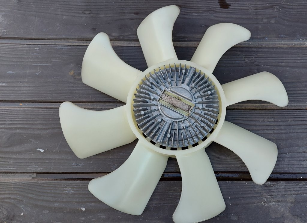

Cleaned up the fan and viscous clutch too:

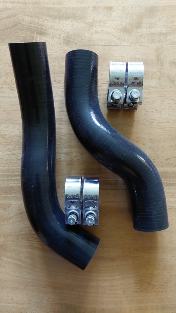

Silicone hoses and Mikalor clamps arrived yesterday:
2021-10-21 12.04.45.jpg (111.02 KiB) Viewed 4329 times

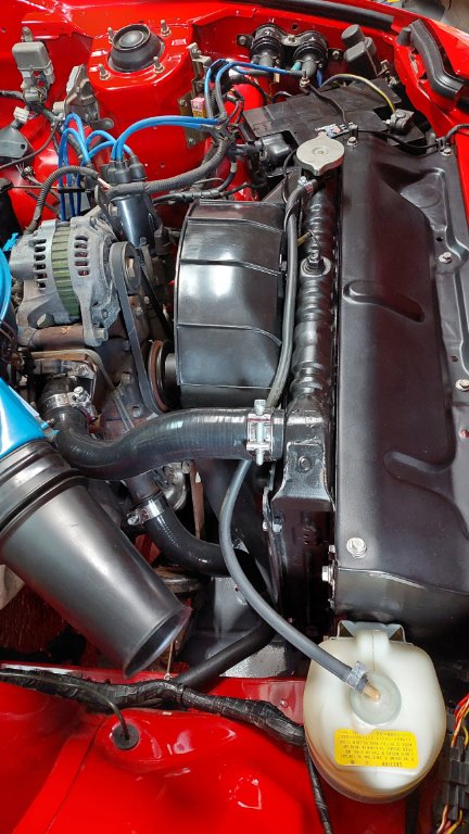

Everything now back in place in the engine bay. Fresh grease in the idle arm mount. Stainless steel bolts used where possible around the radiator.
I've run the engine up to temp today whilst constantly looking and saw no apparent leaks of coolant. I then went for a spirited drive for 20 minutes and checked thoroughly again. There was the tiniest of dribbles of coolant from the top hose connection to the rad, so nipped it up and will check again on next journey. The drive out was most enjoyable!
Engine bay getting better, but still nowhere near DKWW2000 standard ;) :D
