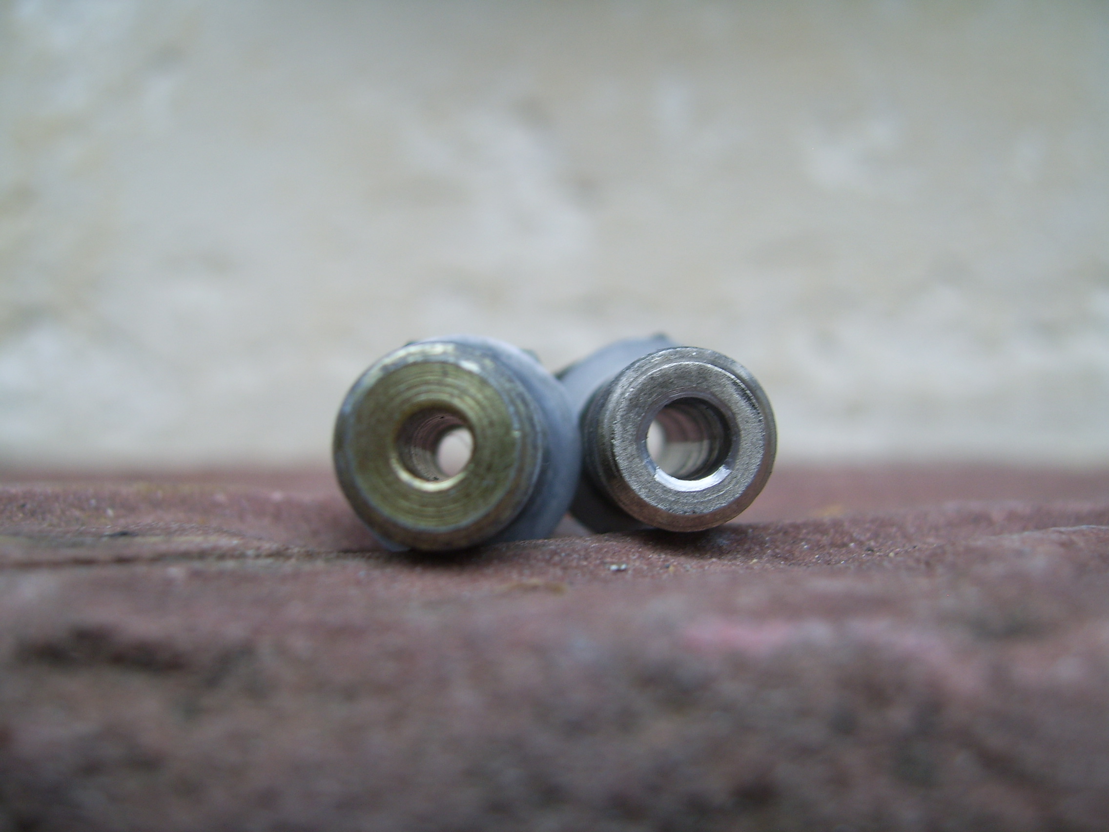

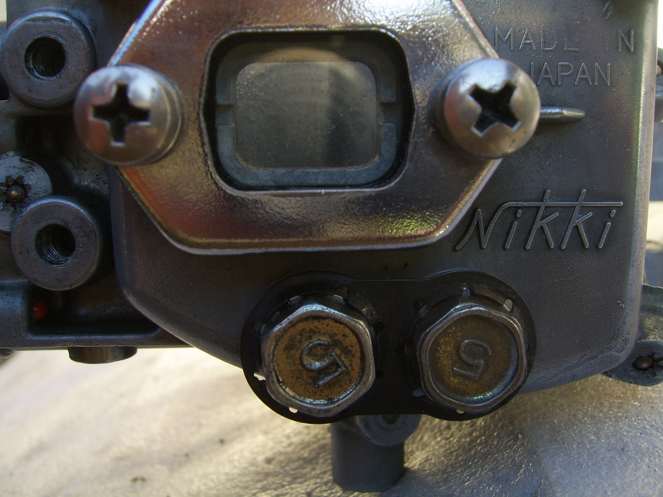

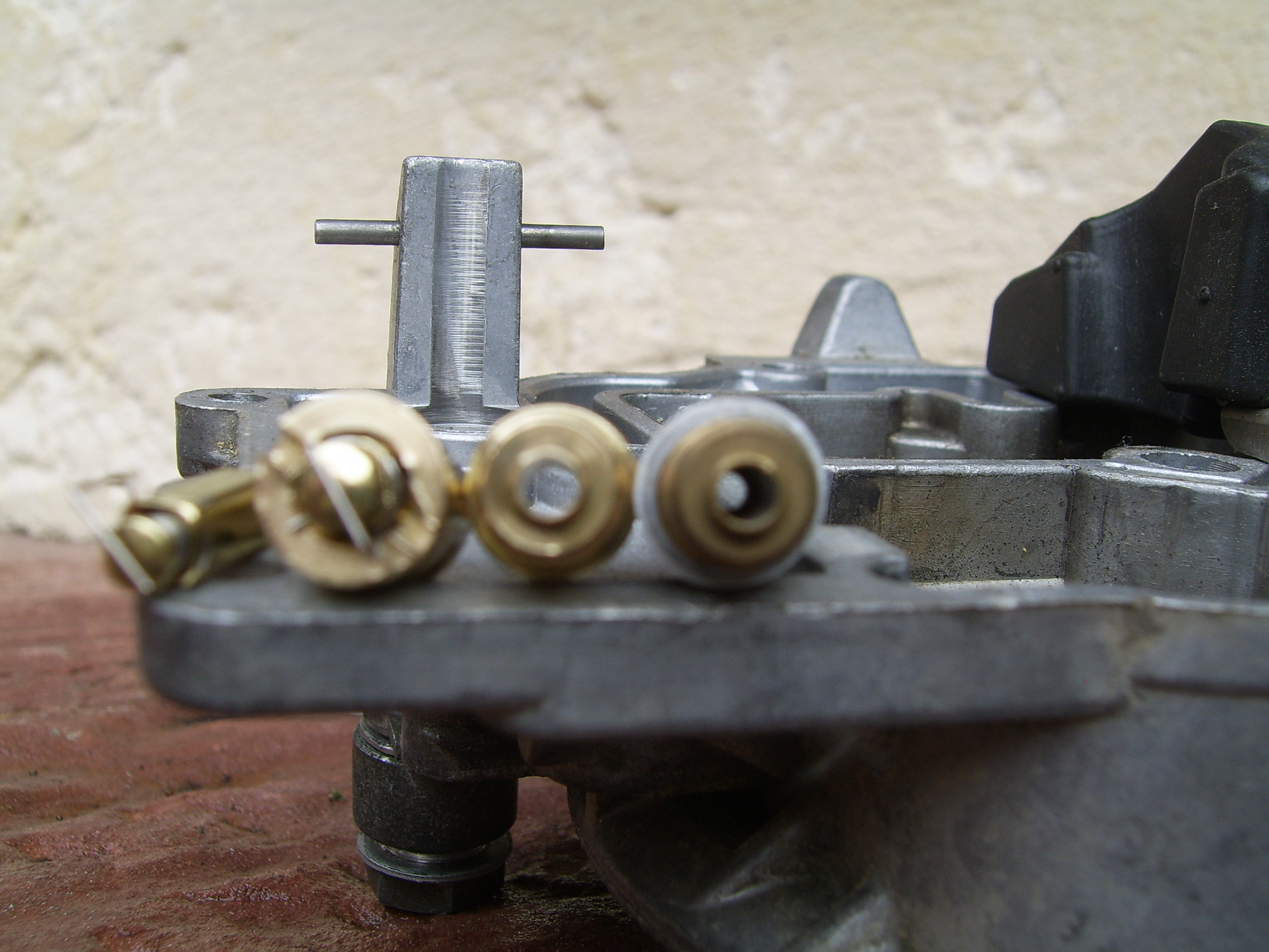

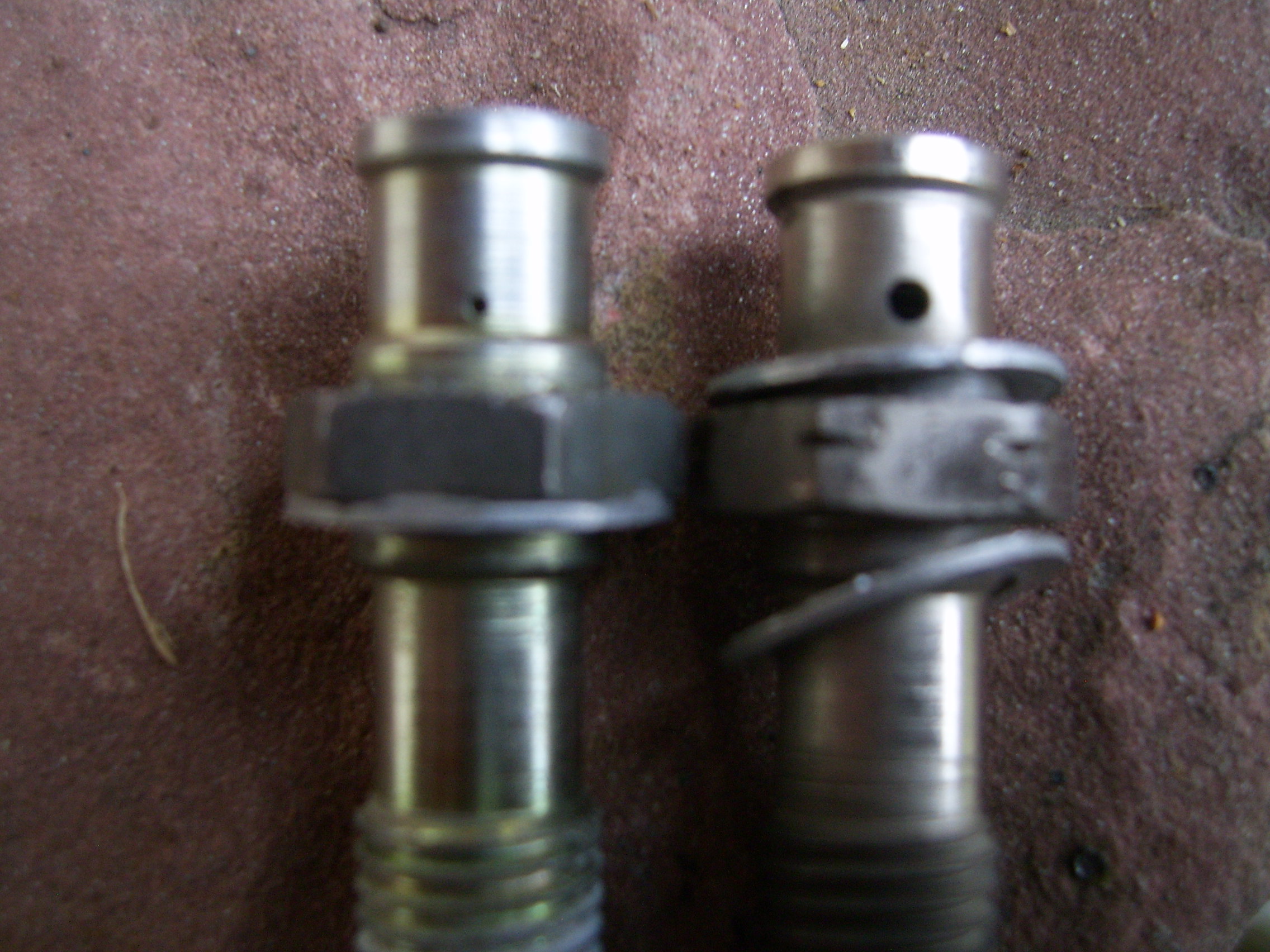

Gernot here are some picture what else you can do to mod your nikki. 1mm primary jet seams a good joice.

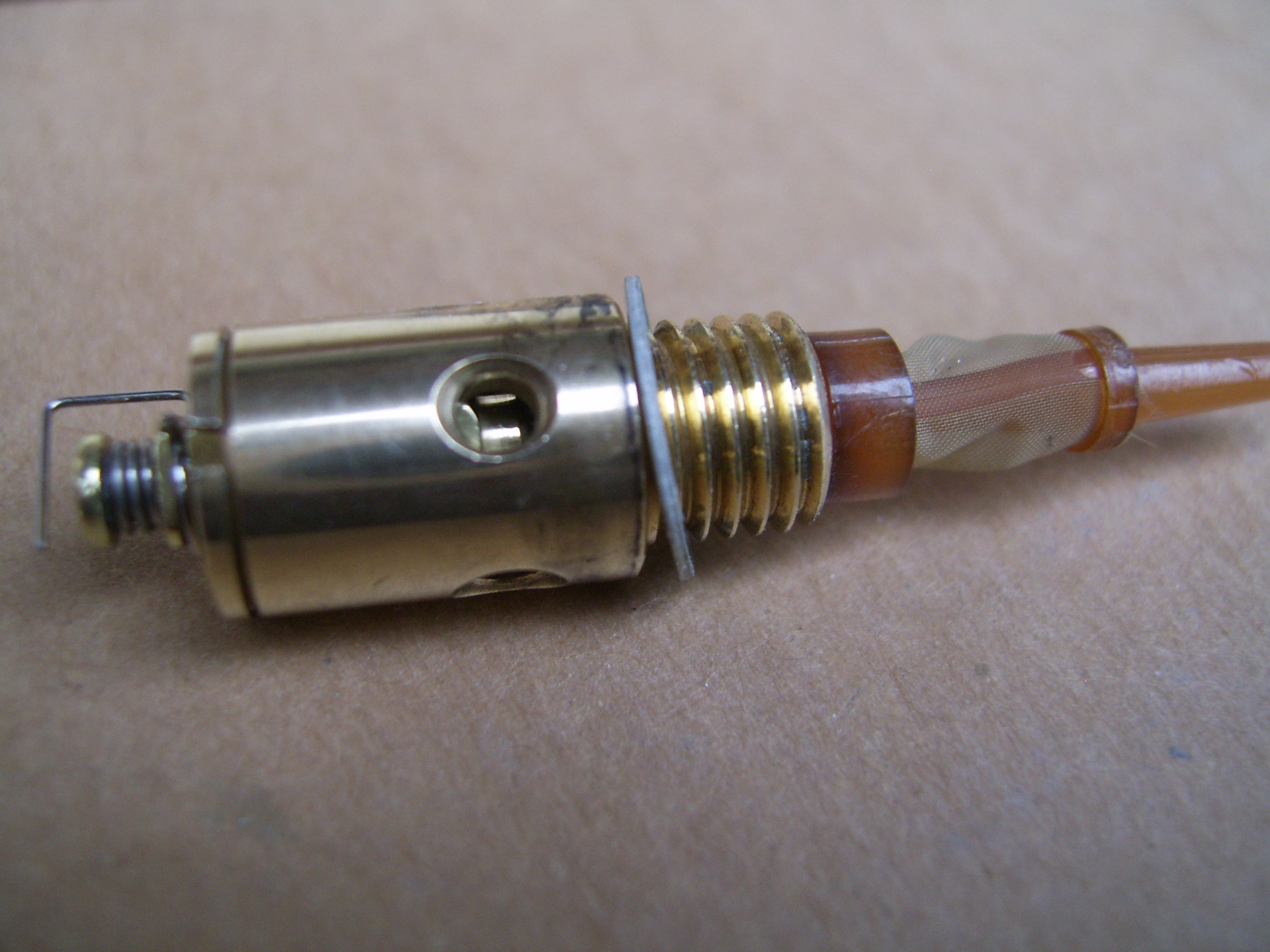

Here are the pics of the bigger fuel screw and float valve.

thanks a lot for the pictures! Well, I will try to widen these screws (there are several lying around in my garage). Do you think, my Nikki needs more fuel than it can get through the stock screws? Shouldn't I be afraid of overflooding?
Thanks alot for your tipps concerning the exhaust. So I'll try to get another back box for now (the long primaries exhaust system from RacingBeat is still a dream to me, but too expensive for my budget now :| )
Cheers
The bigger screw will ensure there's no restriction in getting fuel to the needles and seats and won't alter the carb performance in any way. It will help to prevent any starvation though.
The needles and seats will be the limiting factor as I understand it.

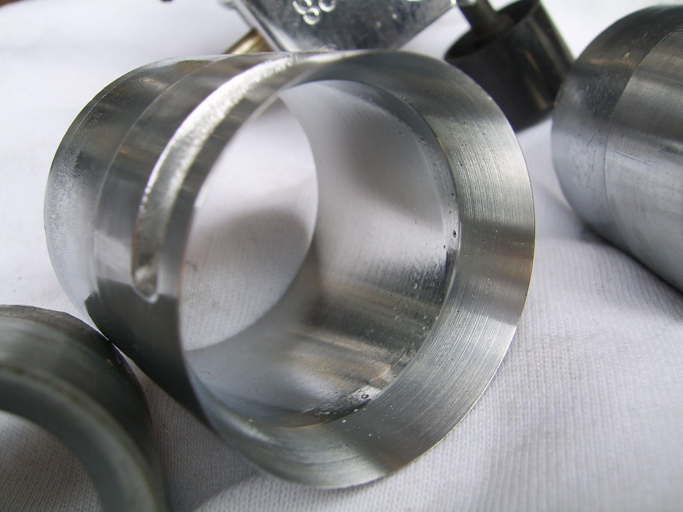

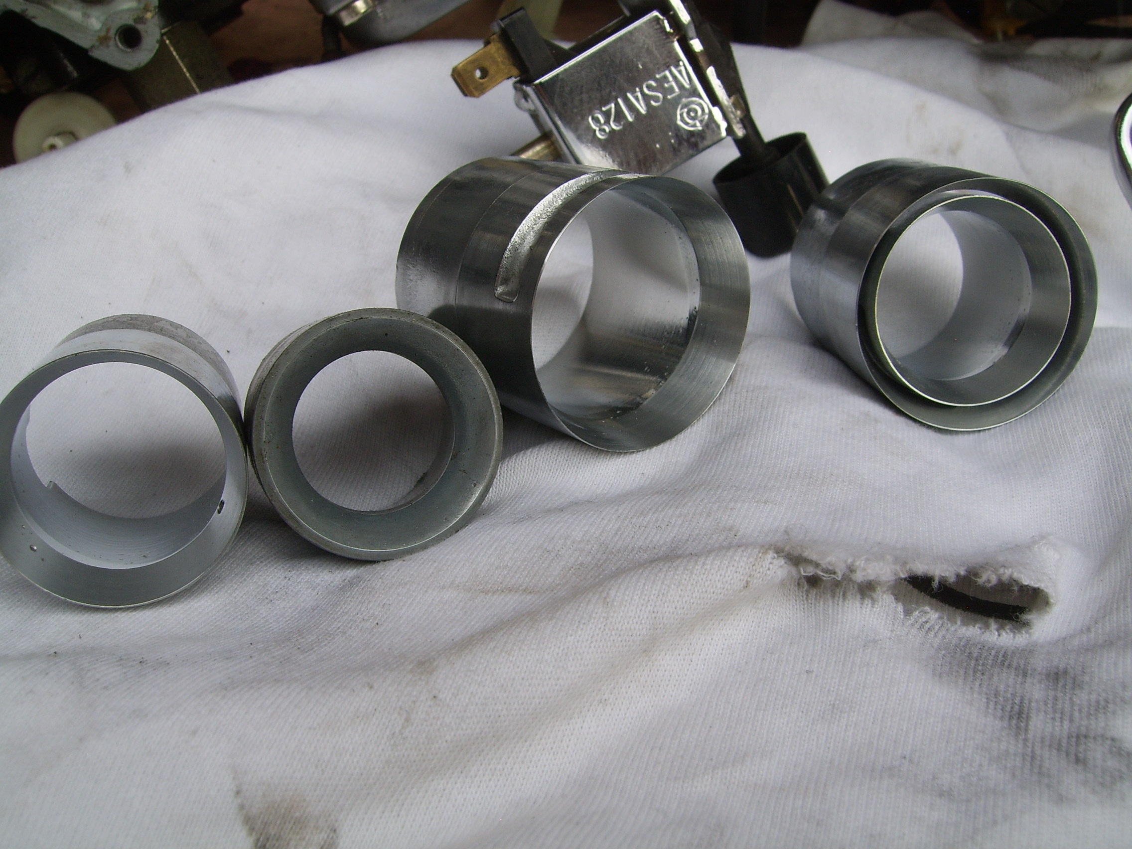

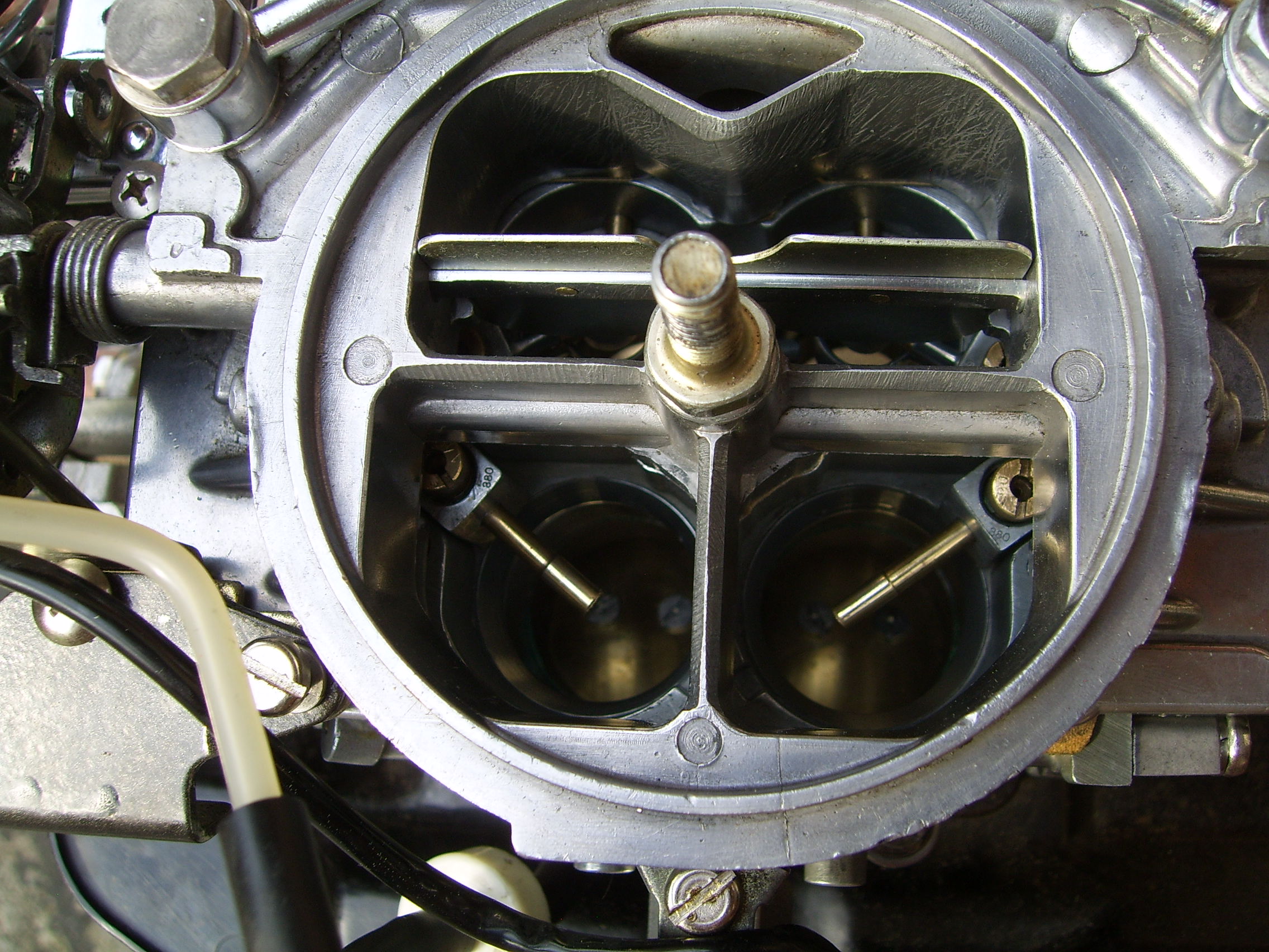

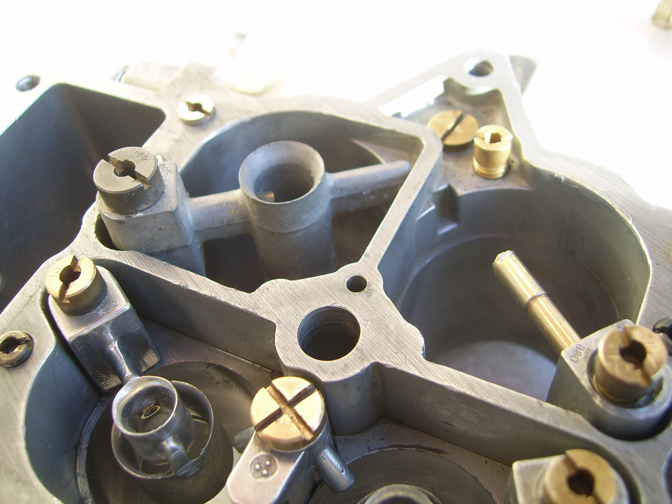

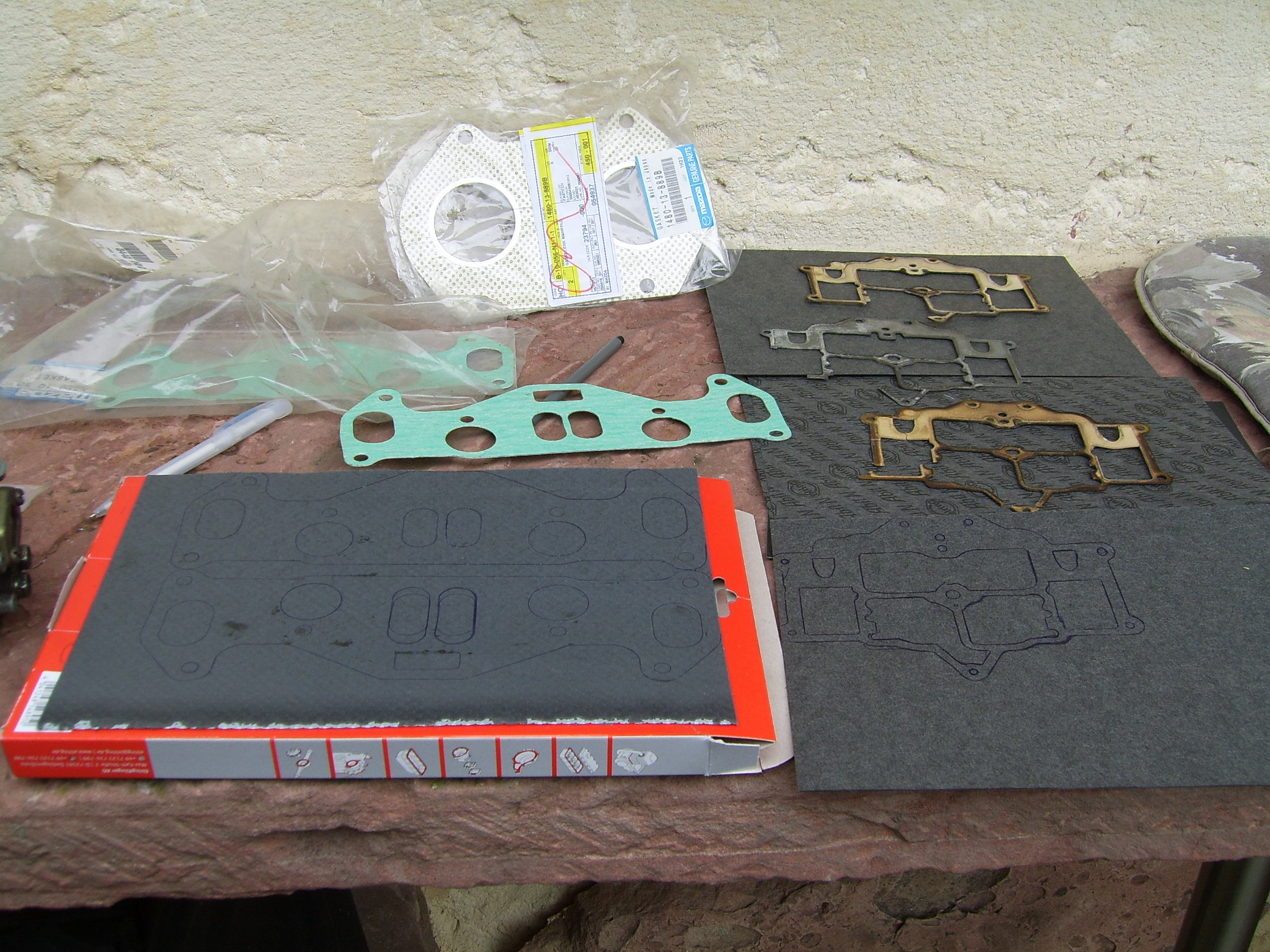

My nikki stage II carb is working very powerfull with 22mm primary venturi. Stage III nikki with 25,4 mm primary venturi is on work now. Some inspiration Picture:

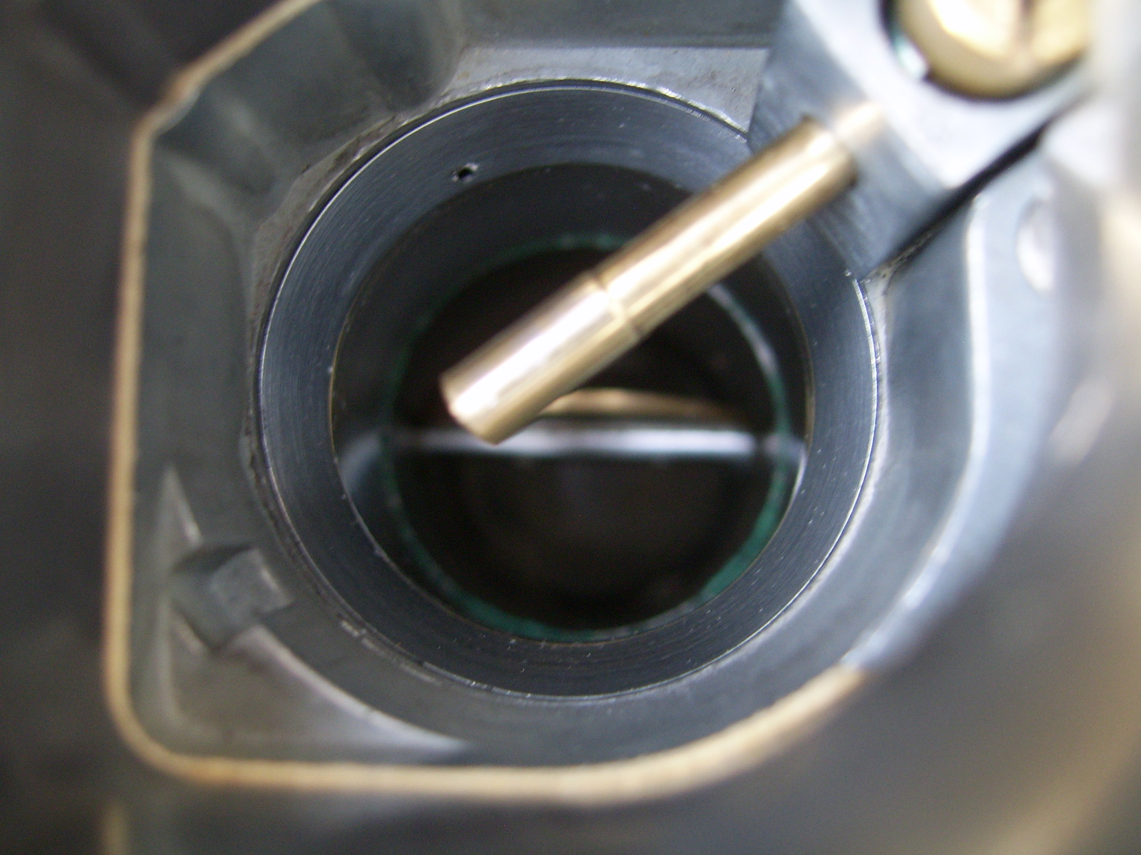

homemade secondary hardcore booster jet

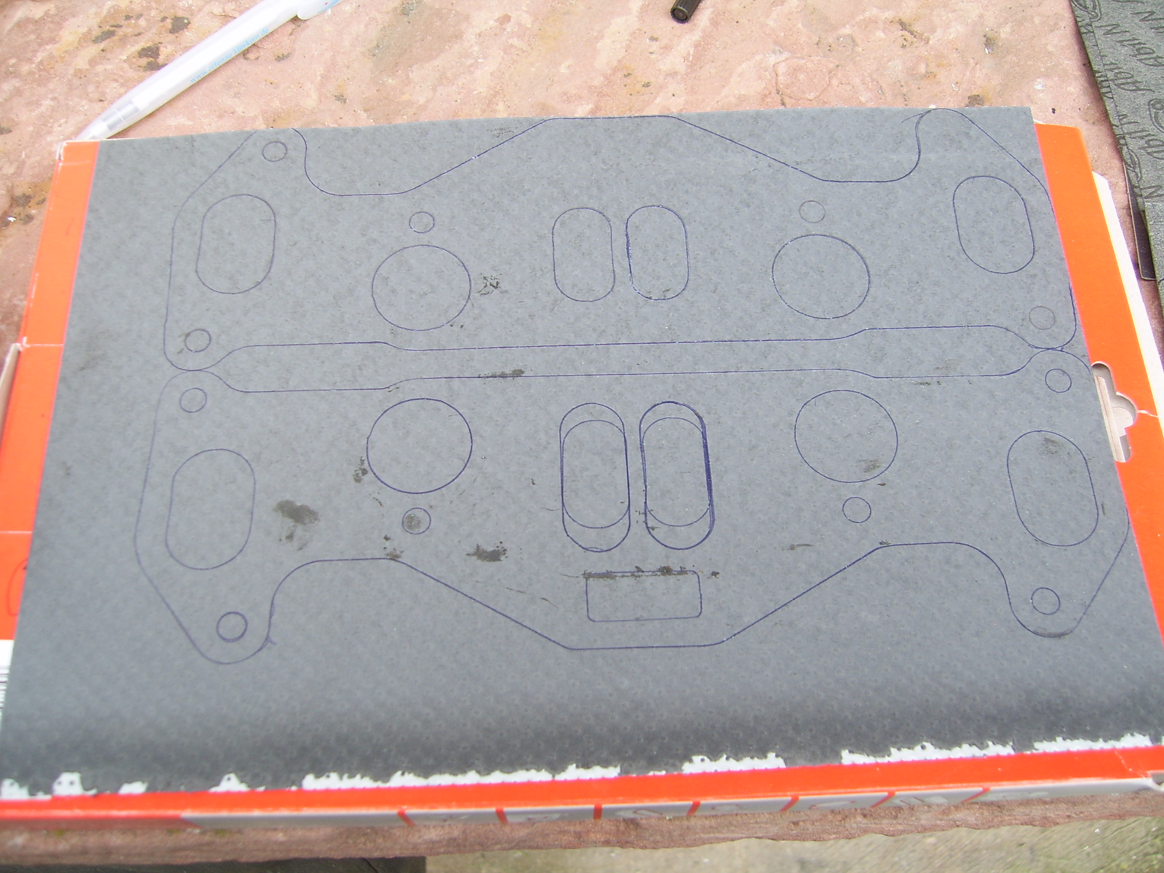

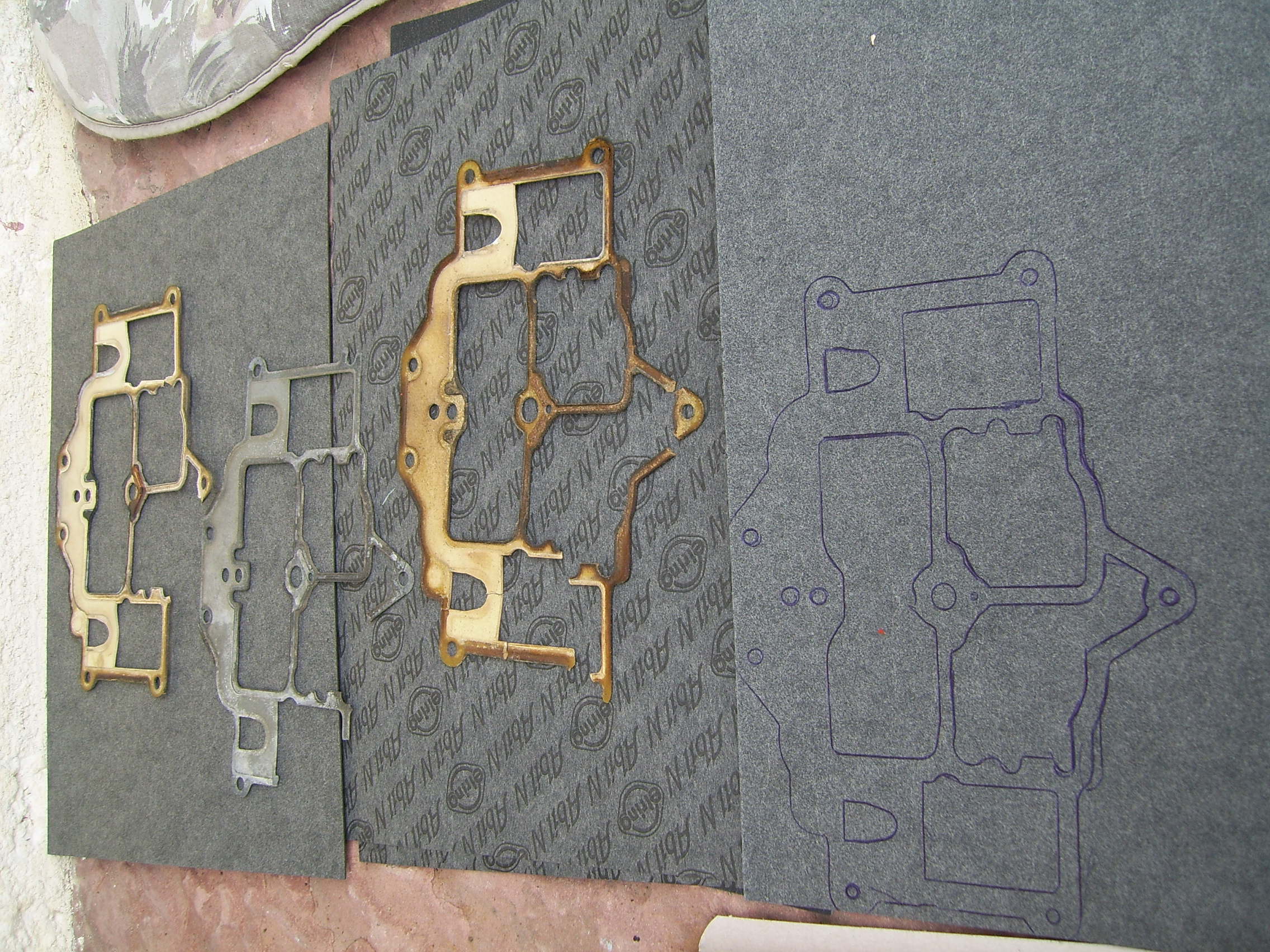

Paper seal of the carburettor top always breaking on the same position. I made my own and taking thicker paper changing the cut on the weak point. Elring paper seems the best for me.http://www.ebay.de/itm/like/27146242770 ... 106&chn=ps
