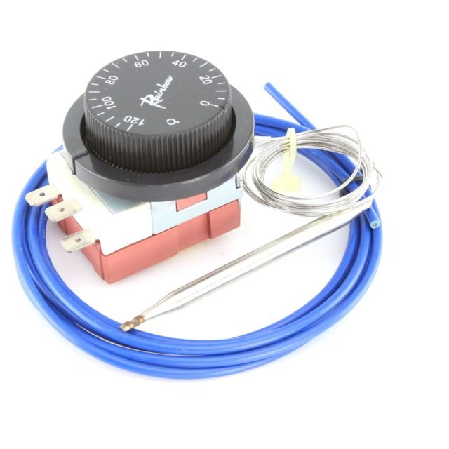

I'm using the cheap and cheerful "bulb/expansion" type thermostat. Not so neat to see, but it works superbly.
Like this one
Installed in KIMI 2:
Not as neat as the Davies-Craig thermistor types, but it does the job well enough :D
