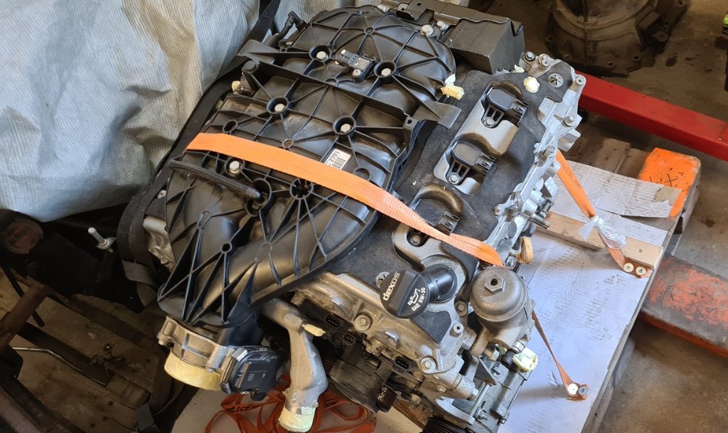

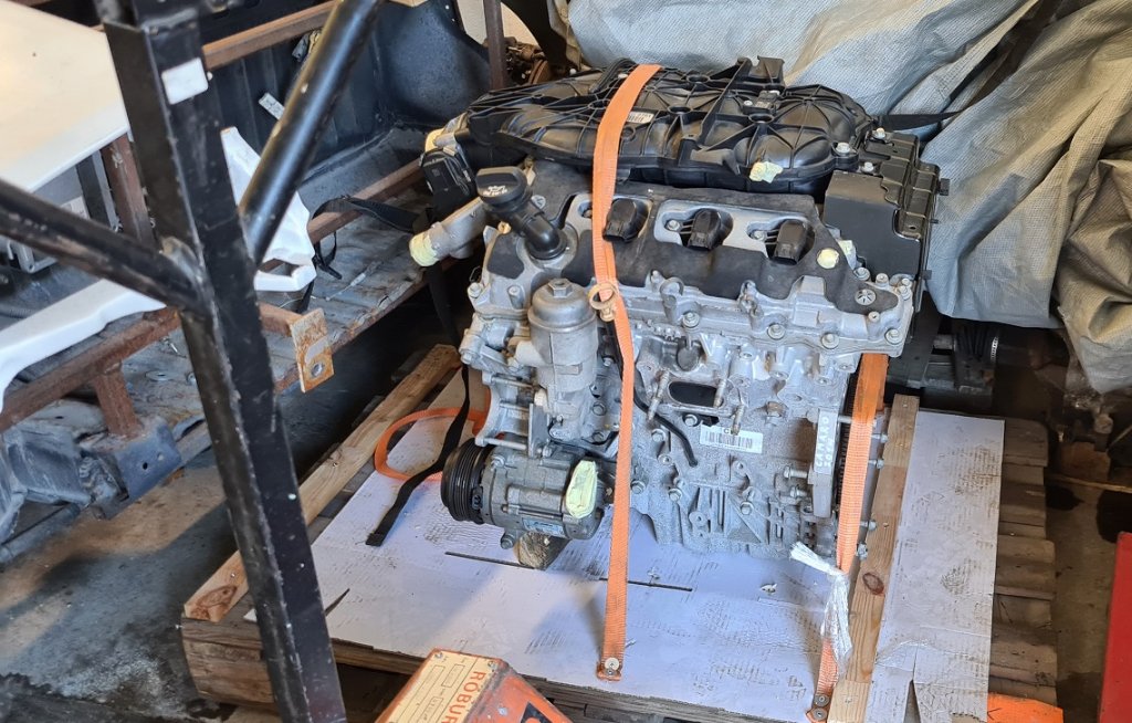

The engine I picked for the car was (sorry rotary purists) a V6, and even worse an American one. I apologise to the rotary purists, I really do. I've got a loft full of 13b bits, it was going to be 13b turbo all the way. But somewhere down the line I started to have misgivings about the rotary reliability & the skyrocketing prices for any of the parts.
In the end I settled on the American made LFX V6. Its a 3.6 producing 323hp at 7200 rpm. Yes its not rotary, but it revs higher than the redline on the existing 12a, is lightweight & should make the car fly.
Hopefully it suits the car as much as I think it will.
To the end of all the above I needed an engine & a donor MX5.
Here they are:

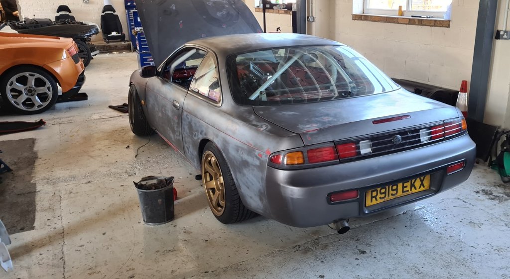

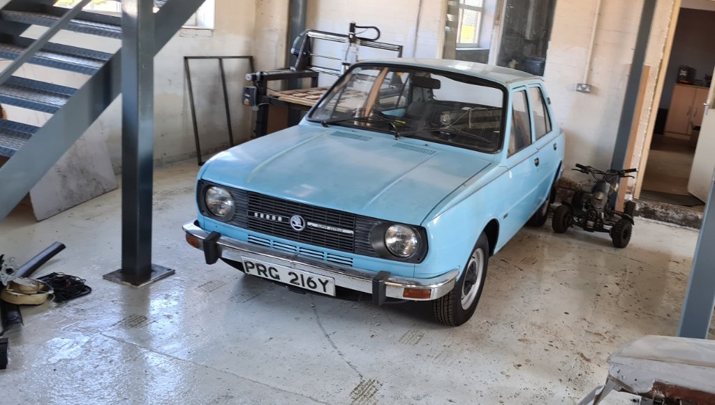

The guy doing the work has been entrusted with some other nice rides:
Here they are:

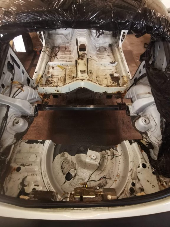

I'm only posting a few photos of the many that I have, the car is very much work in progress but much progress is being made.
Right now its welded to a chassis jig, and the rear is being worked on. Once this is rebuilt and stiffness restored to the body then work can transfer to the front.
Much care has been taken to locate the bits exactly where they should be, not just in relation to the body itself, but also in relation to each other as they would have been in the MX5 with the exception of the wheelbase being a little longer.

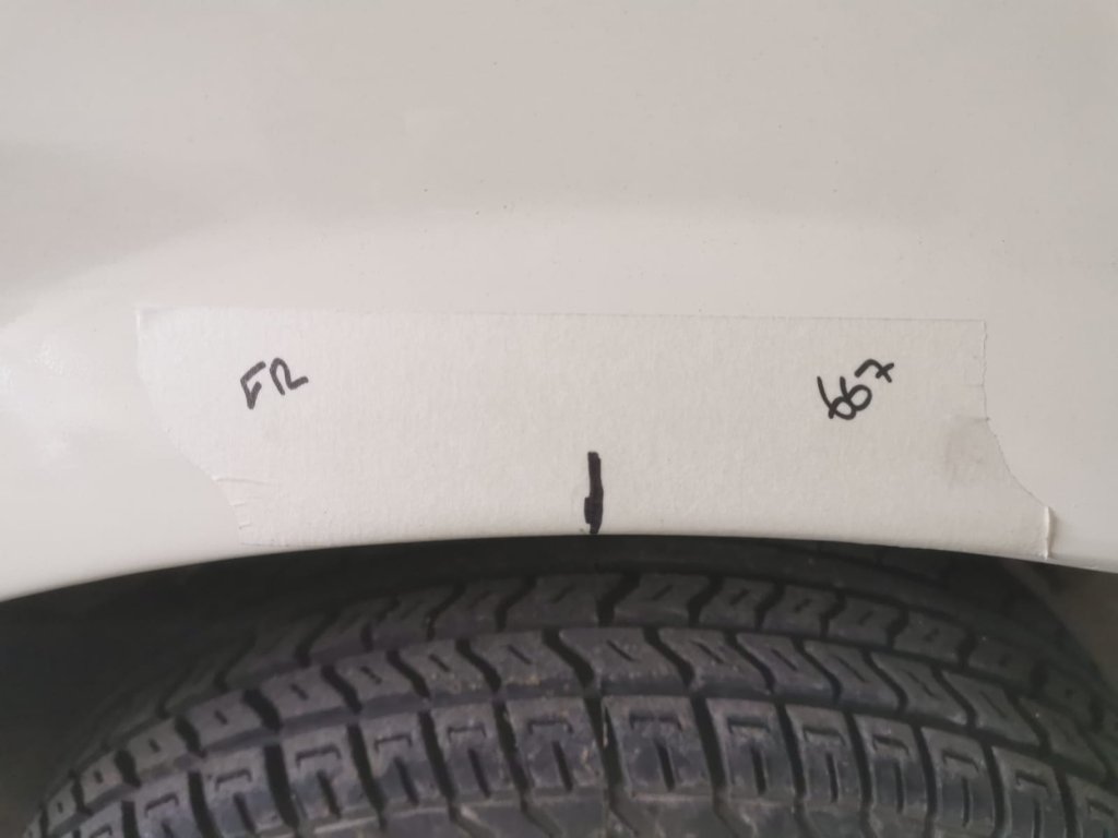

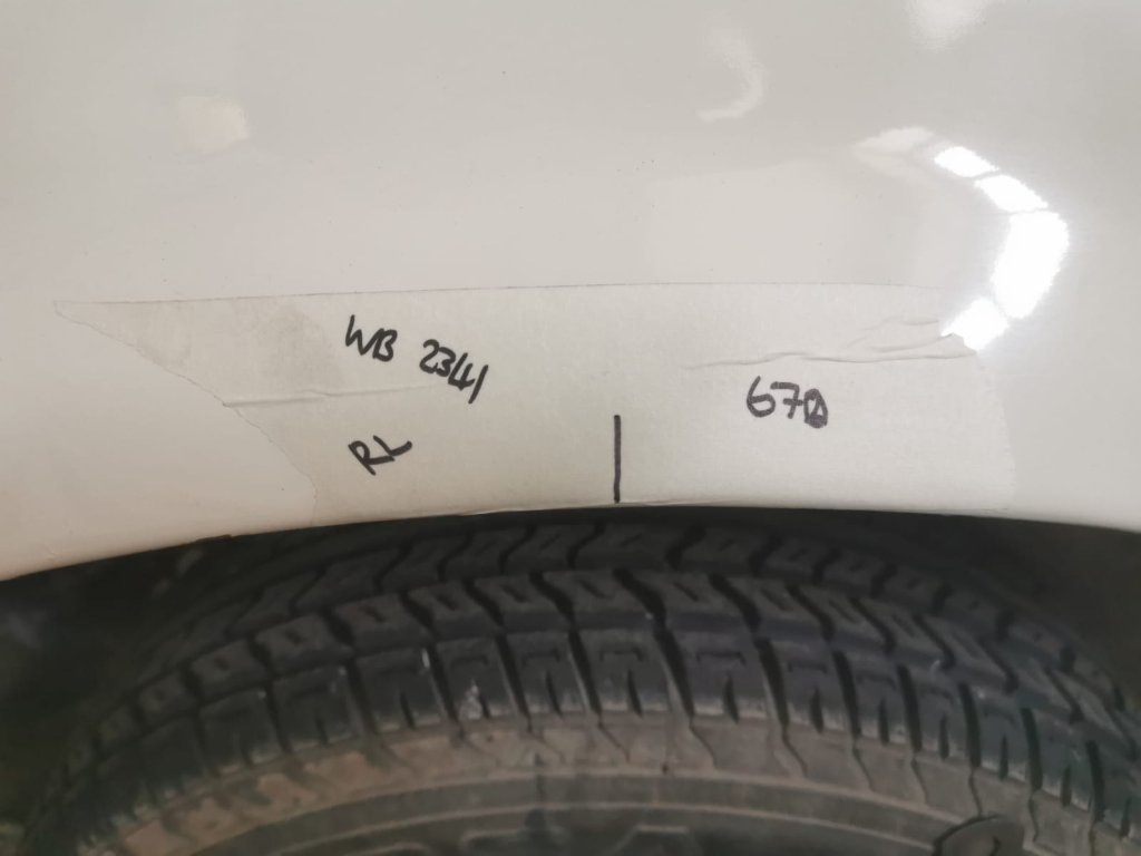

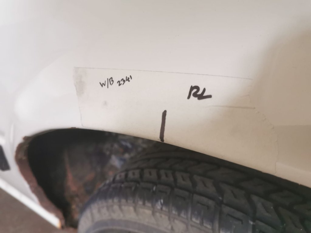

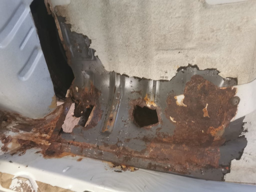

Car in the workshop: Some preliminary measurement taking: Some holes were discovered under the soundproofing. Lots of chopping:
