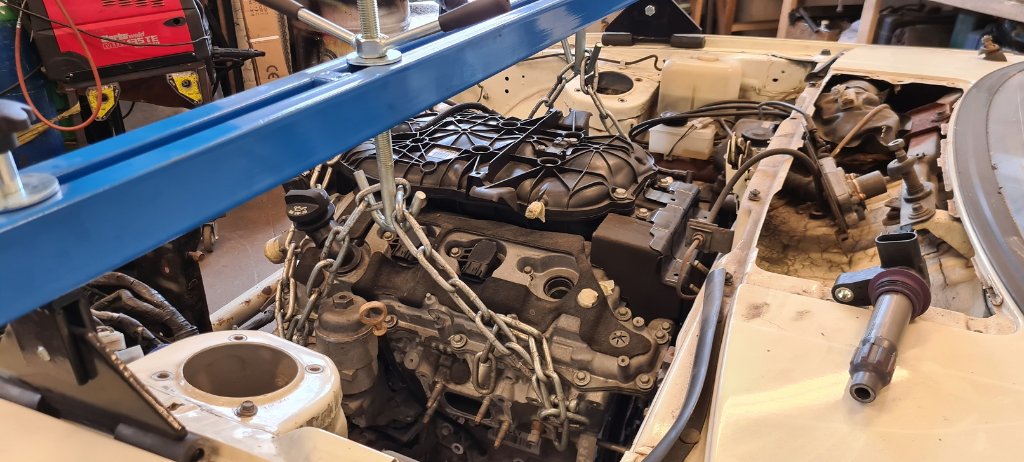

Rough position of engine. Very tight for top clearance but its possible without any bonnet modification (a red line of mine, if we can't then it gets another engine)
Room for the radiator is tight as well, although as we don't need the oil cooler we don't need to worry about that.
Also have to find room for the AC condenser from the MX5.

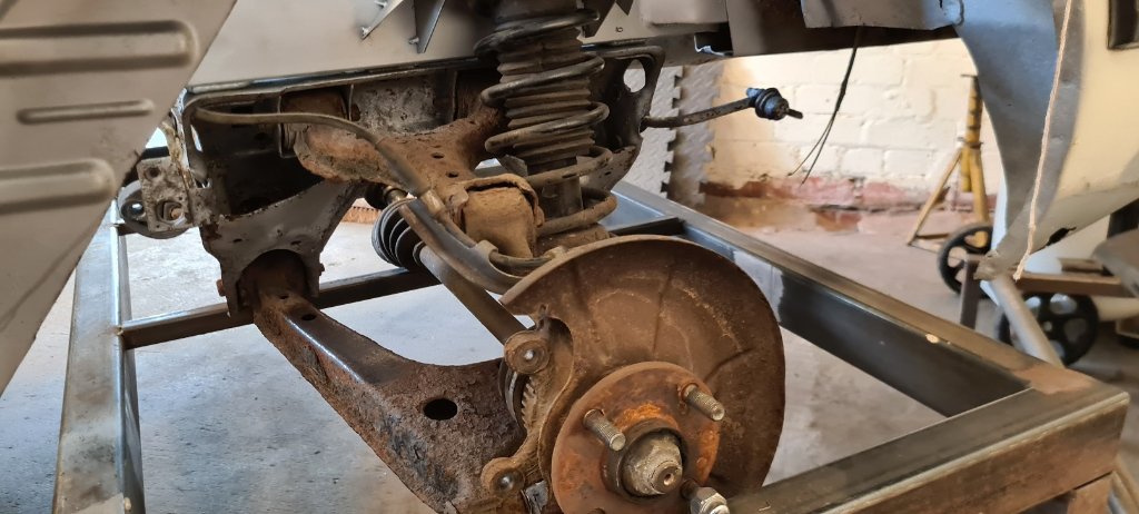

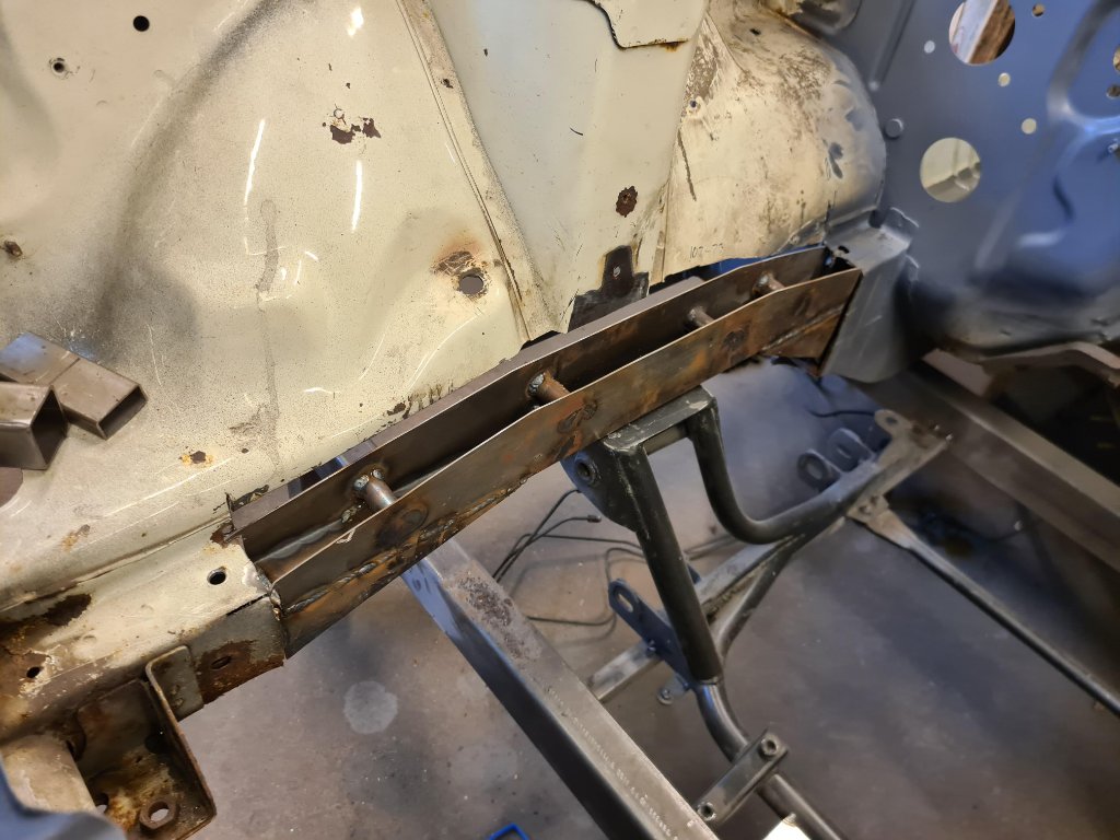

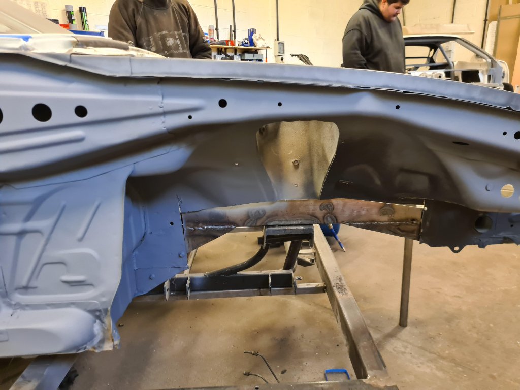

Bit of a photo dump.
A house purchase, boat woes and other financial bits and bobs meant that I had to ask Andy to slow down a bit.
However we're not far off a rolling chassis. All the reskinning will happen once the running gear is finished as the access is pretty good right now.
There was a crapload of rust everywhere though, in places I wouldn't have suspected. The bulkhead especially was riddled with it.
