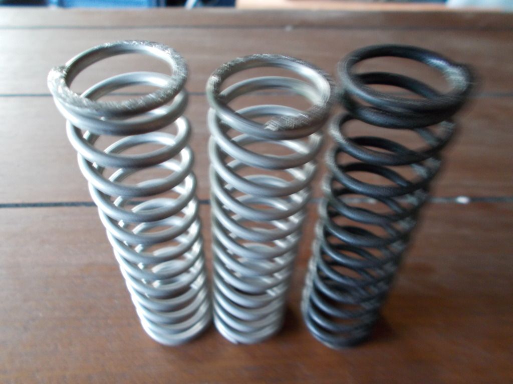

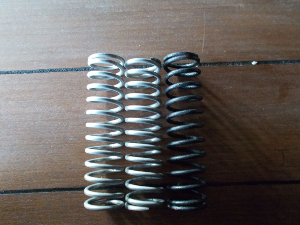

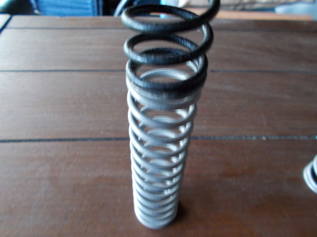

My original is the black one. Theirs seem to be exact replacements, except their quality control sucks. One of the new pair is shorter than the other. So I tossed the short one in my spare parts collection and installed the 2 that were the same length.

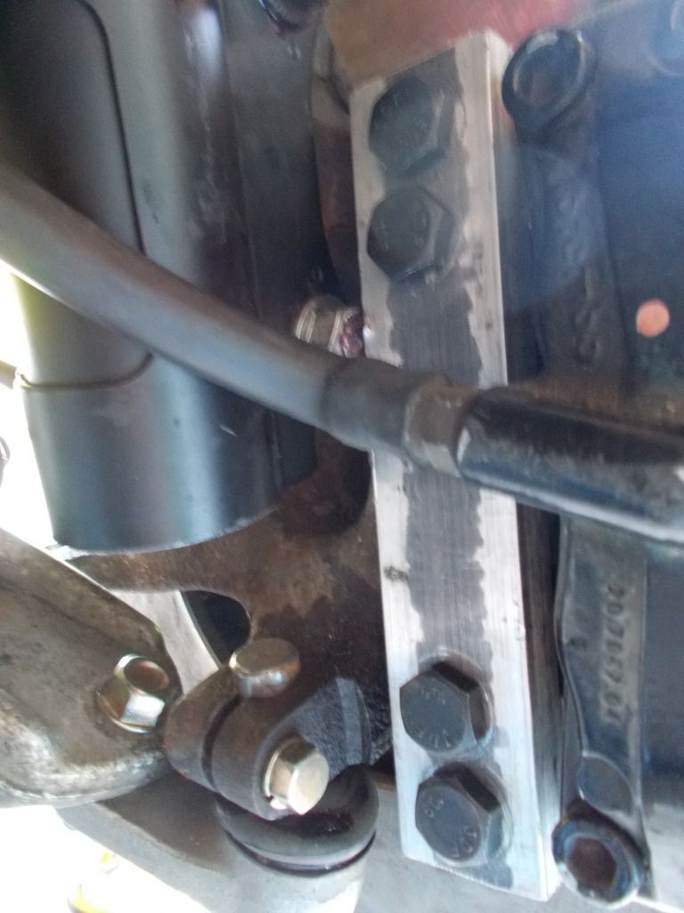

The new M12 x 1.5 x 30, grade 10.9 bolts arrived, so here's a better view:
that's 5/8-inch 6061-T6 aluminum, roughly 1.375-inch in this case, with an offset of 0.106-inch.
Knowing the brakes can never be insufficient is worth the couple hundred extra dollars. The tires may prove to lack grip, but that's a separate matter. Likewise boiling the brake fluid.
