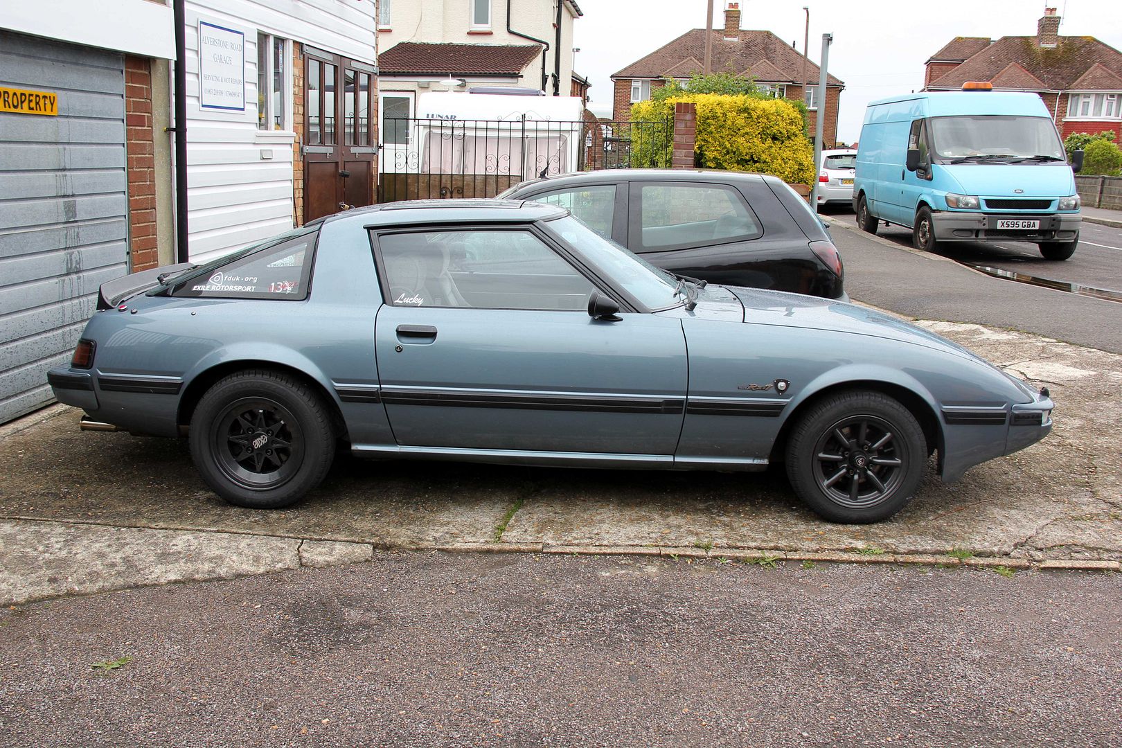

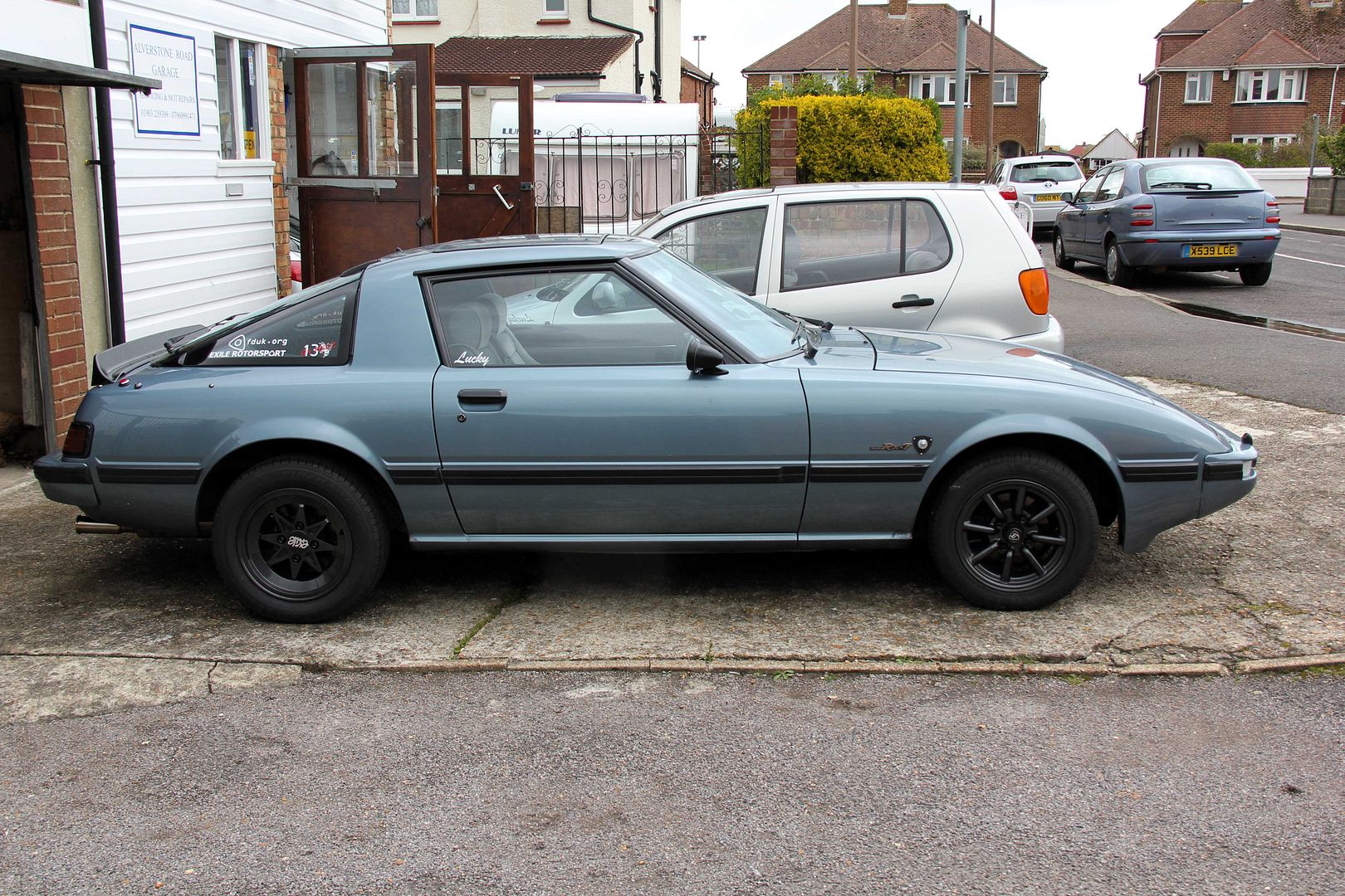

Before;
After:

Suspension before;
and after;
Hmmm. Is that an inch drop? It looks almost identical to me, but never mind. It's worth it just for the effect on the handling. I find myself wondering if uprating the swaybars would really finish it off or if it's end up getting too stiff and provoking the back end out too much. Hmmm, again. There's always something lol

Before;
After:

Suspension before;
and after;

it might settle a bit lower after a few weeks Nik. I actually quite like the 3 spoke s3 steering wheel but prefer the leather rim of the s2.... shame we can't have a mixture of both.

Yeah, you should find the springs will settle a bit over a few weeks and some miles, and it might drop a bit - I found the same when I fitted my spax -30mm springs, it seemed to sit at the same height, I figured it was a case of new springs instead of tired old saggy ones???
