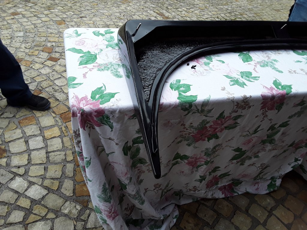

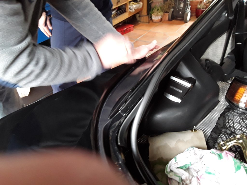

First i prepared the bodyshell with primer. And paint the contour of the spoiler with chalk before.
The water drain on the spoiler I've closed. I didn't need the antenna hole so i not need to drain them.

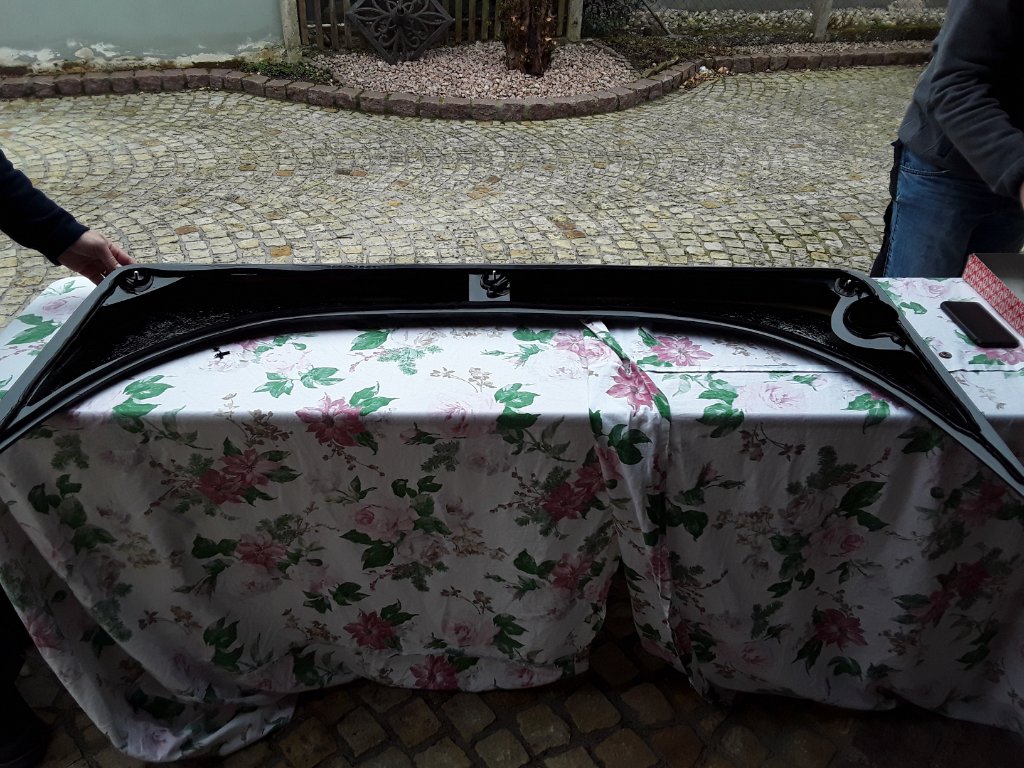

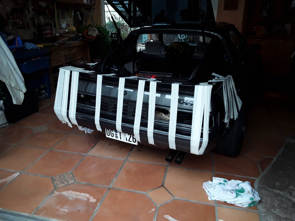

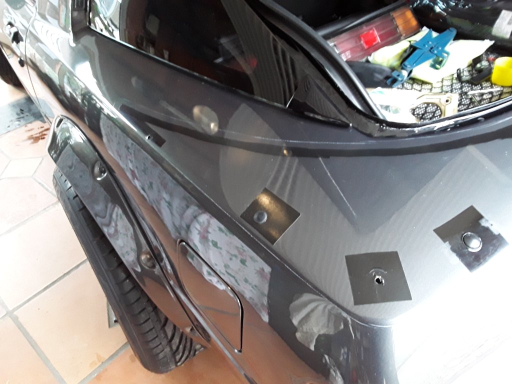

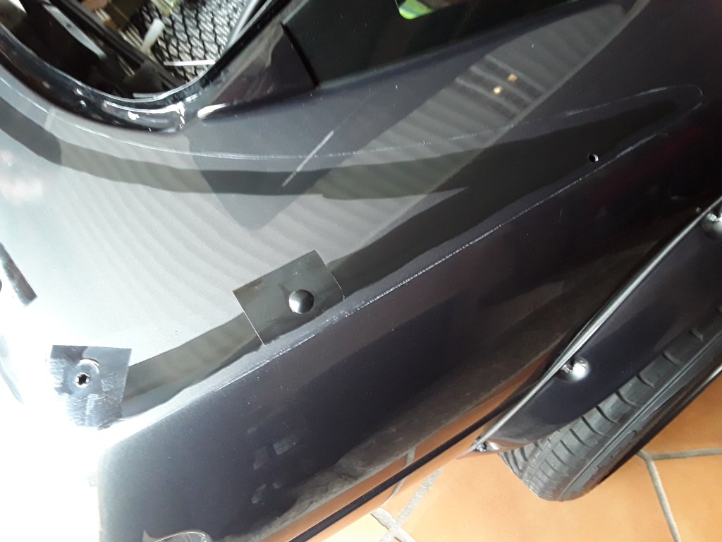

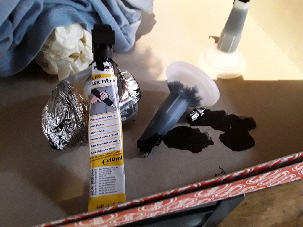

Next i prepare the spoiler took windshield primer and glue from förch.
I must wait now 2 days for hardening.
Hope you never want to take it off again Thomas :lol: Great work though, very thorough and professional. s(c)
Remember no speed limit on german highways.I want to be shure the spoiler will stay on the bodyshell without bore a lot of new holes.

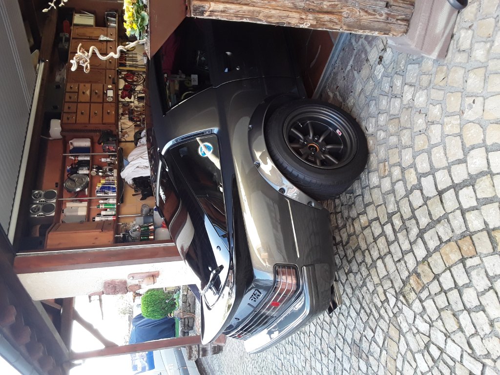

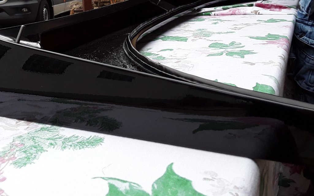

I like the same black like windshield trim, door mirror, hatchback glasses and so on. The very outstanding design of the elford rear spoiler got more intensity with the different colour to the bodyshell.
Thomas the finish on the spoiler looks very good, you are right the colour contrast works.
That is great work Thomas. I like that that very much. s(c)
You must be very happy with the finish Thomas s(c) ......Autobahn sya
