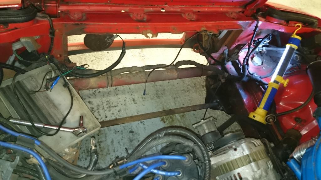

Remove the battery (cleaner under here than I'd imagined it to be)
Note battery tray with someone's technical height adjuster lol

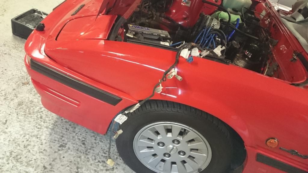

And wiring fixes to be going on with
And more

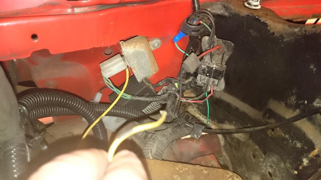

A yellow wire to nowhere bodged into a relay
Does anyone know what this relay controls? (engine bay in front of battery) Headlamps, indicators, horns?

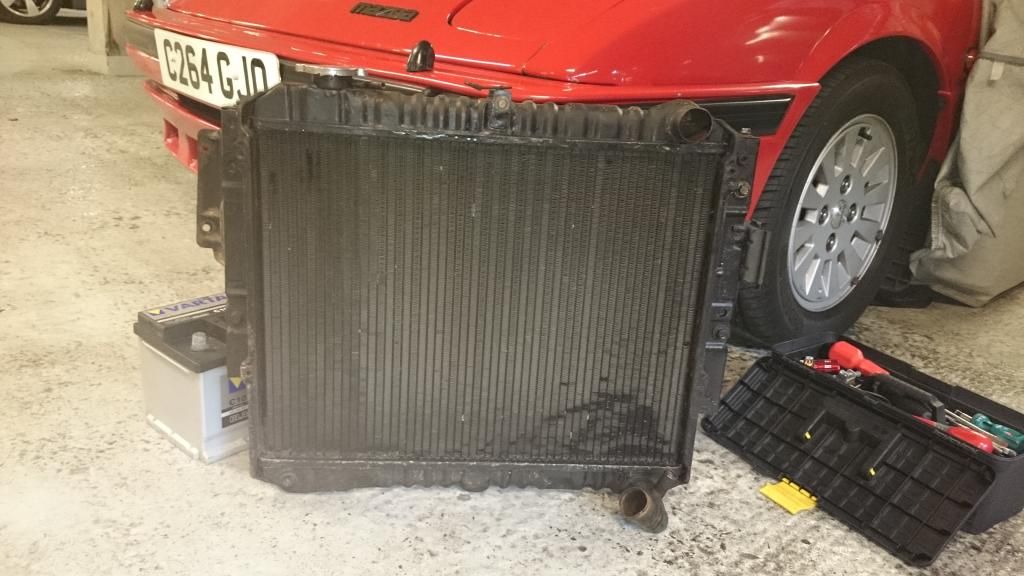

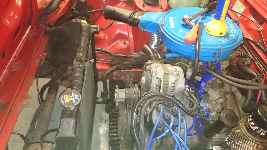

Removing parts like a boss now! Shroud, fan (extensive cleaning required) and rad hoses.
Bolts from shroud. They were all the same once Grrrr
Radiator removal ... it's only four bolts

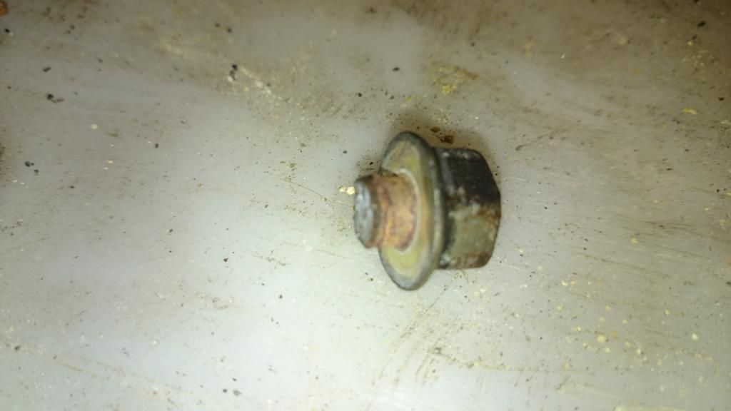

FCUK!! TWiR says hell NO

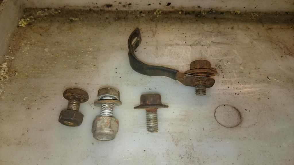

That's one of the four (well .. three now) bolts holding the rad onto the brackets.

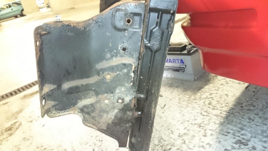

Plan B then. Remove the brackets with rad attached. Four little bolts come out surprisingly easily
Does anyone have any spare radiator brackets? I'm not convinced that the other three bolts won't snap too.
Radiator in surprisingly rude health
Hopefully, the next pics will involve an engine crane of some description!
And more

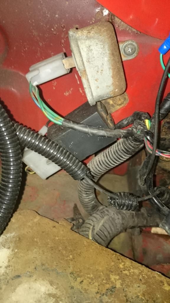

That's ignition relay, I think.

I have that same height adjuster too!

LOL I guess it's cheaper than buying the correctly proportioned battery?

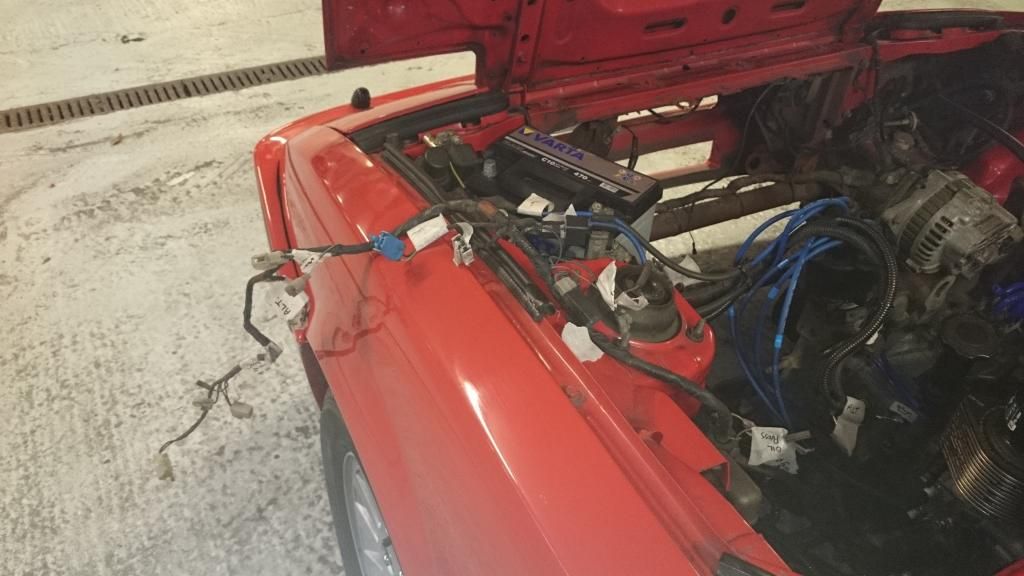

Disconnecting electricals. All labelled up just in case

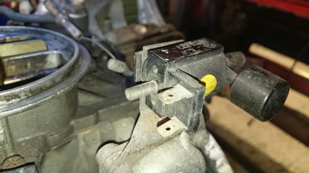

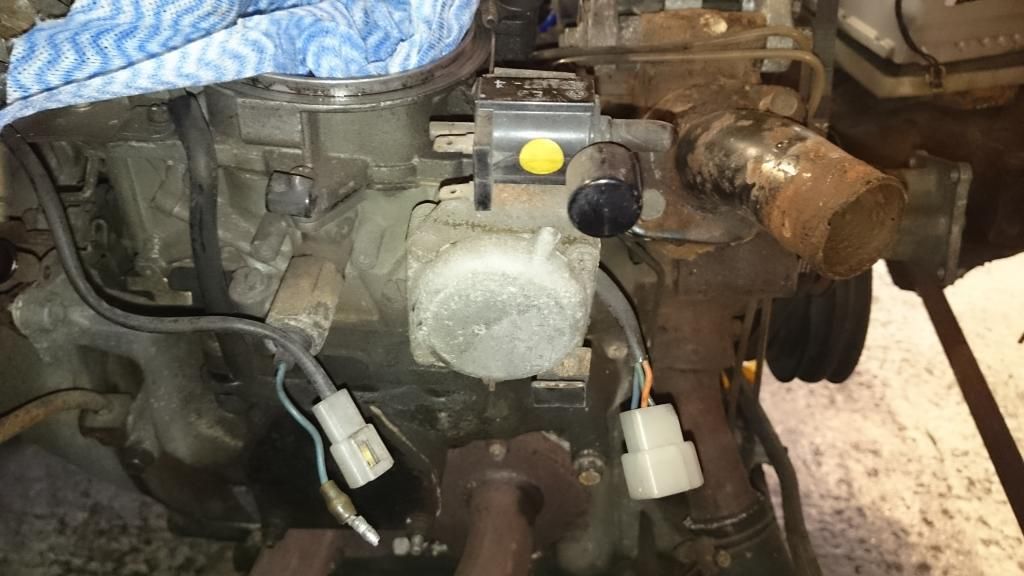

That liitle loom goes from the oil pressure and water temp senders on the left side to carb on the right side. I disconnected the electrical feed to this dashpot but interestingly,there was no vacuum line attached
Look no wires now

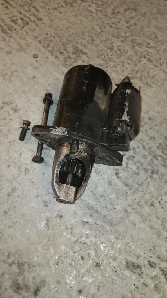

Starter motor out.
WTF

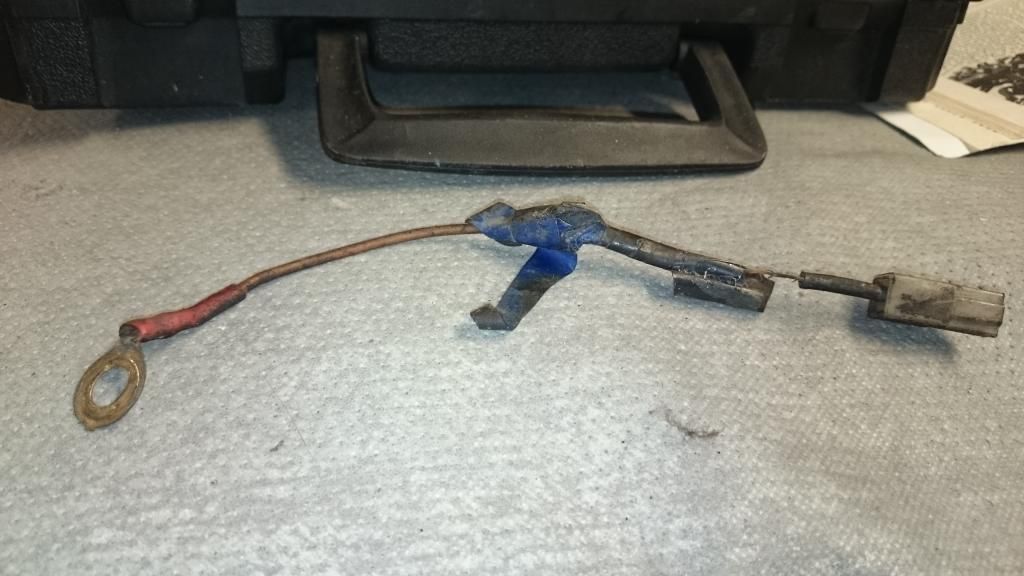

Bodge City Arizona. Round post goes to solenoid terminal and plastic connector to the loom. What is it's function??

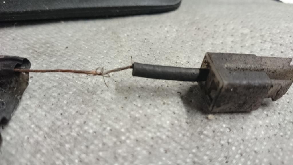

Very carefully unwrapped some tape .... Just hanging by a thread
Does anyone have a spare or can I just make one and retain the plastic connector. What guage for wire??
Look no wires now

That wonky wire seems to be a fusible link taking power back up to the hot start relay when the starter motor is energised. (That's if Haynes is to be believed).
I'd never realised until this morning that it's a fusible link not just a connecting wire.....Dooooh.
The reason it's fusible is because it's taking battery power direct from the starter main terminal back up into the loom; the volts are going up it so to speak not down it.
So yeah, it looks like you need to try sourcing the correct item Dave. It seems to be marked on the diagram 0.5F
On the plus side, if it is available it should come complete.
- Been thanked: 3 times
Re: TWiR 1986 S3 TWR
Or use normal wire with an in-line fuse holder? Even a slow-blow fuse would be preferable to bloody fusible links wouldn't it?
