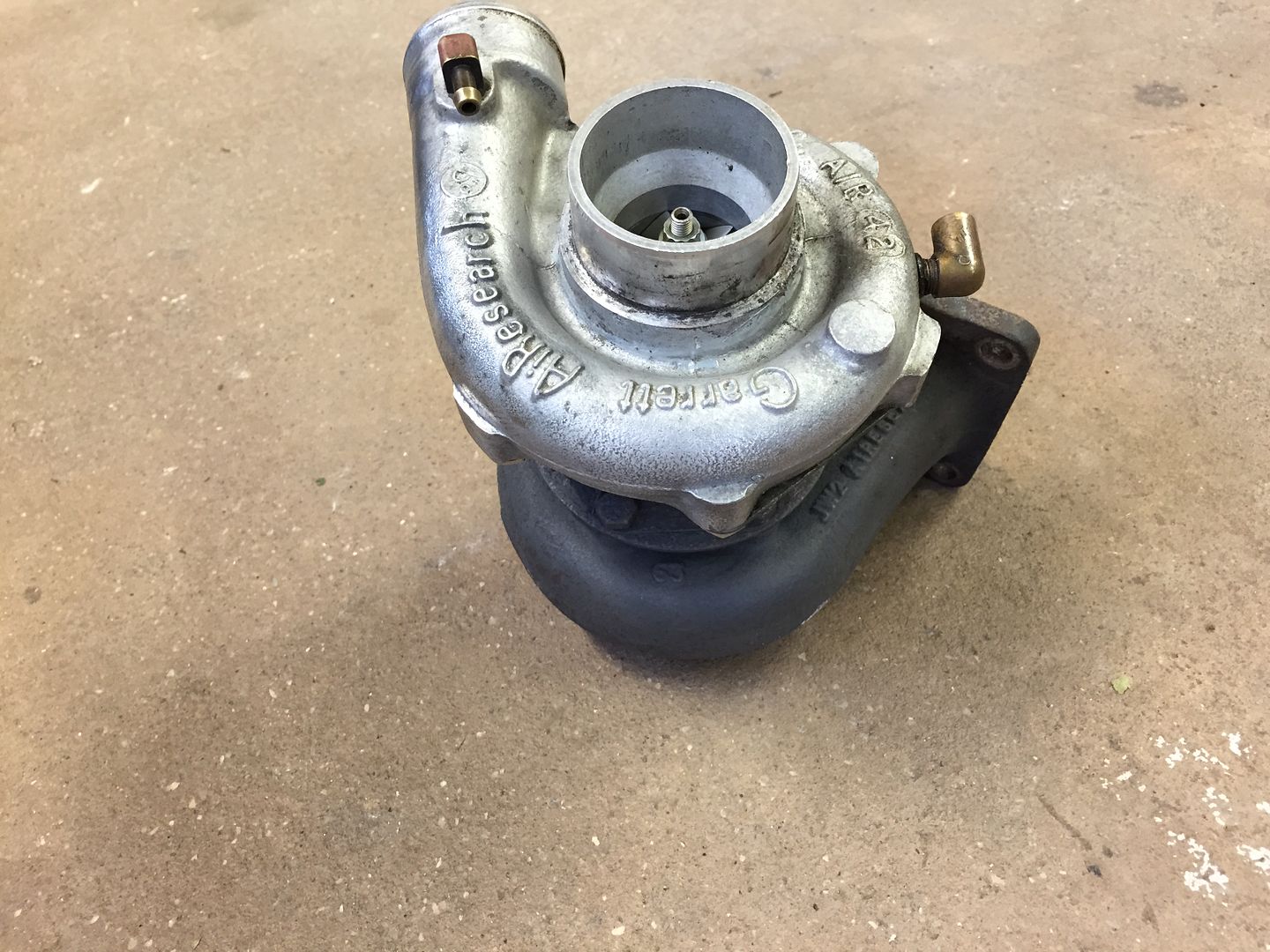

The first thing I needed to do was to send the smoking and worn out Garrett AI Research turbo from my Elford turbo off for repair to enable me to keep using the car while I prep the 13bt engine etc.
At the moment, my car is using a turbo borrowed off Keith but that going to be returned to him after the RetroRides gathering so my sick turbo has now gone to http://www.turborebuild.co.uk/ for a rebuild.... it should be back next week.

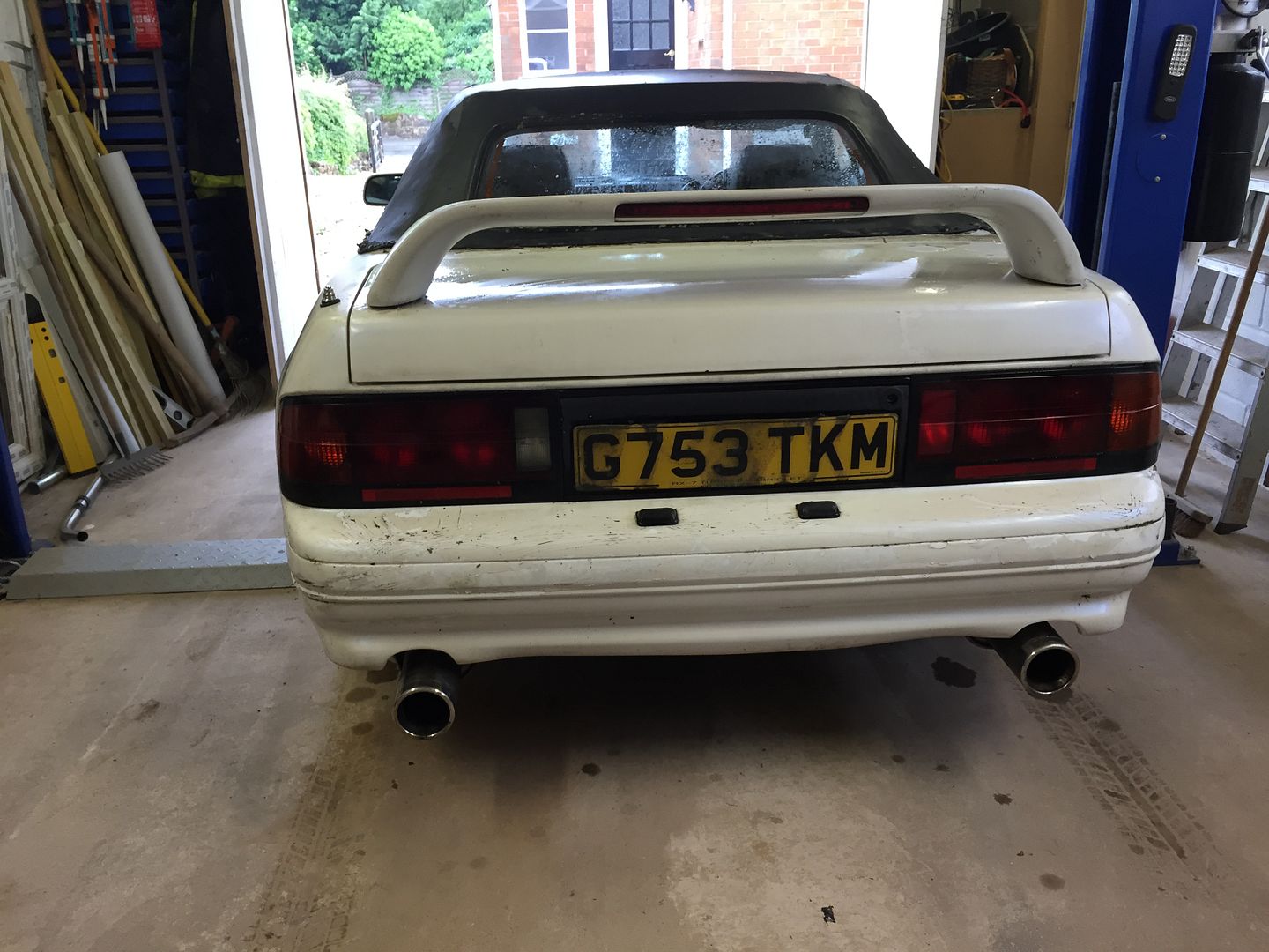

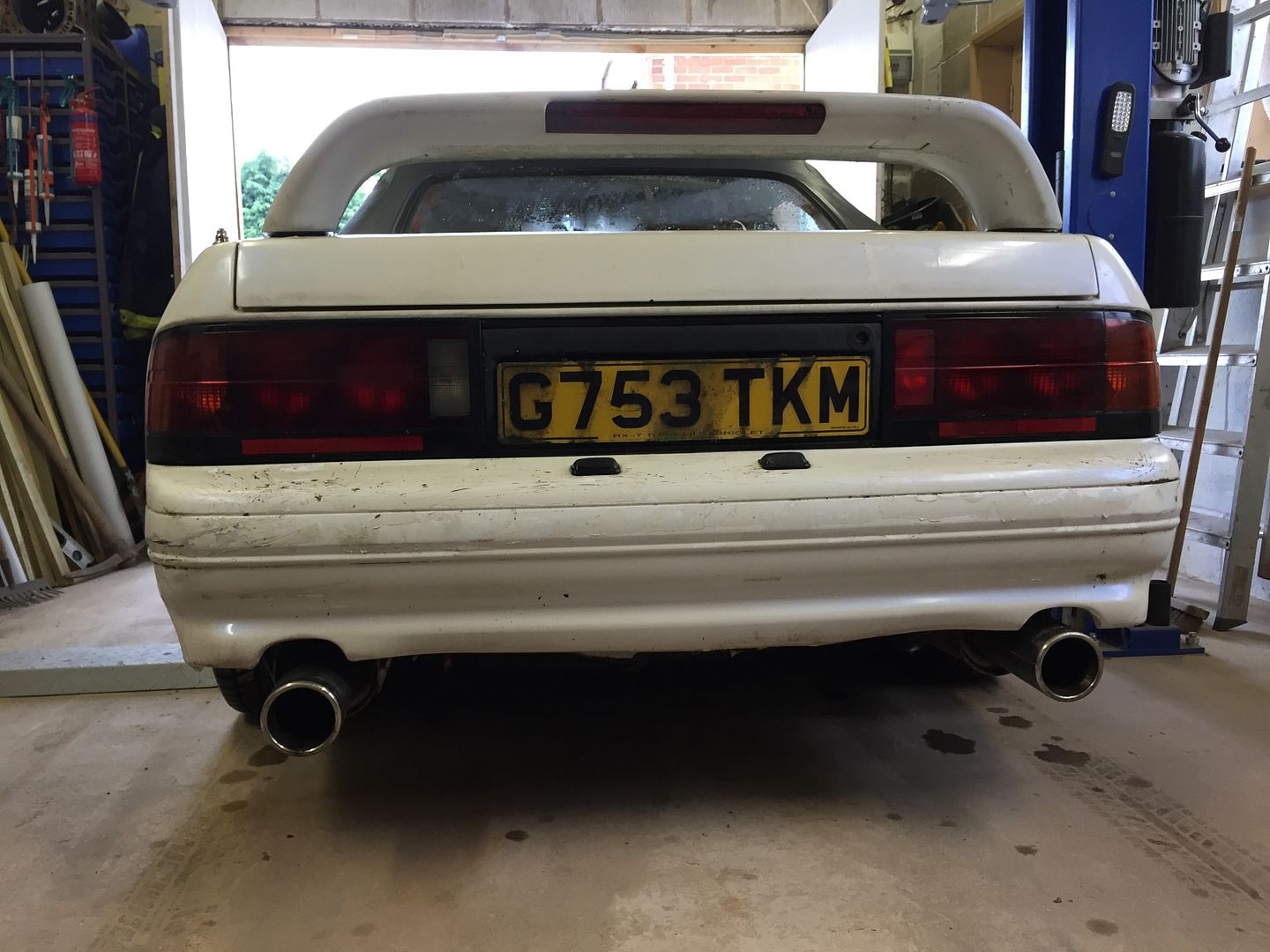

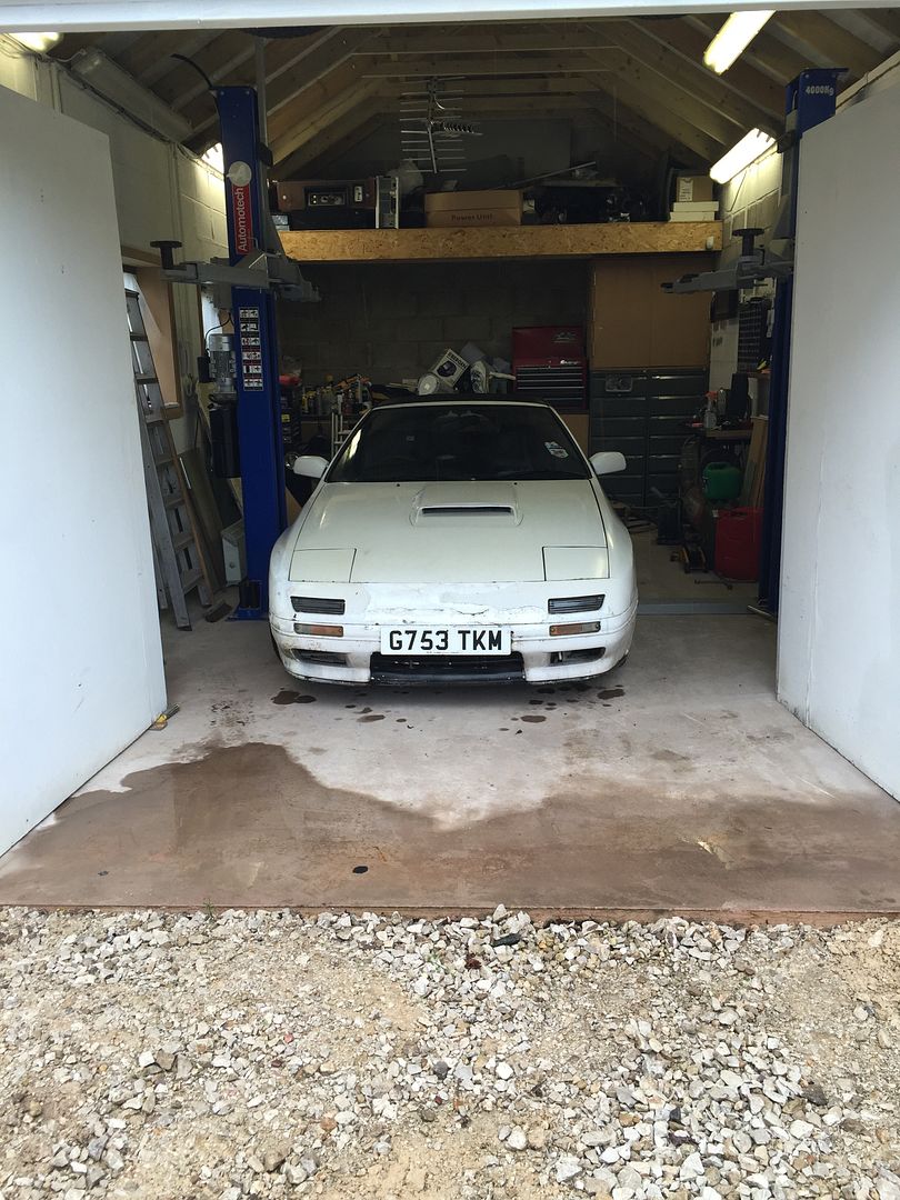

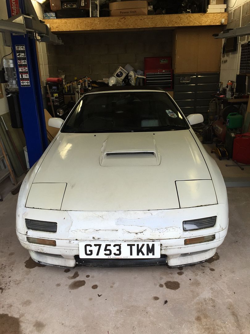

The first thing I needed for a 13BT engine swap is, well, a 13BT engine really so with that in mind I bought this.... a 1990 series 5 turbo 2 cabriolet parts car...
The seller told me that he had got the engine rebuilt 3000 miles previously as well as adding plenty more new parts... I didn’t have any paperwork for an engine rebuild but all the other new parts were there so things looked hopeful.
My first task was to get the car started to make sure it ran. This was complicated by the fact that it was fitted with a professionally installed alarm/immobiliser but the remote fob was knackered. Every time I connected the battery it armed itself and then activated once I touched anything on the car. The only option was to find and remove the security but as I'm wasn’t at all familiar with FC's and the last thing I wanted to do was cut a crucial wire to the ECU or something, I had to tread very carefully.

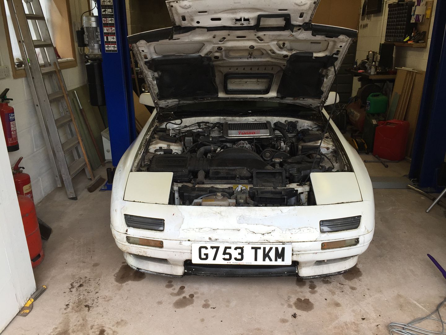

The big empty engine bay it came out of...

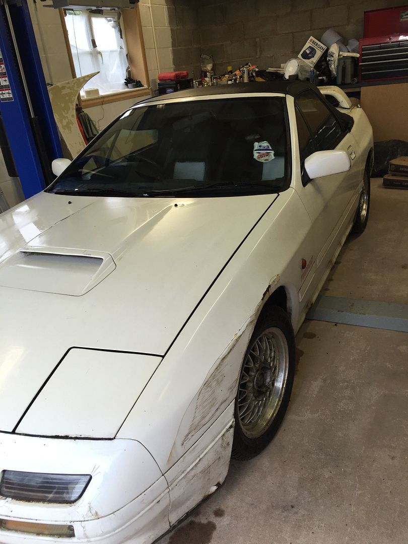

These old cabriolets rust like mad......... I suppose not having a proper roof doesn't help
I pulled the seat belt mounting point out with my bare hands...
I stripped the rest of the shell, dropped the suspension off it and weighed it in...

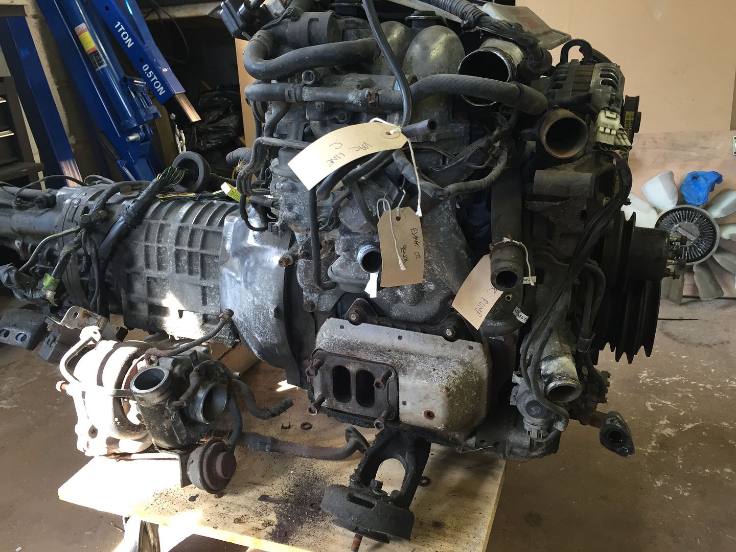

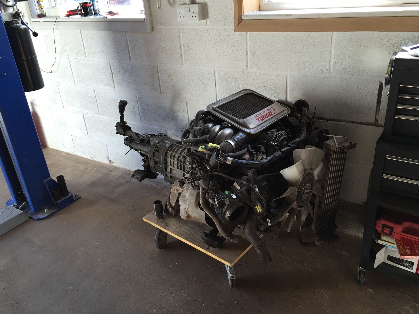

But the main thing was that I was left with this...
This engine looked huge and as if it would never fit into the Fb’s engine bay but underneath the turbo, heat shields, power steering pump, air con compressor etc is an engine hardly any different in size to the 12a so I set to work stripping off the ancillaries...

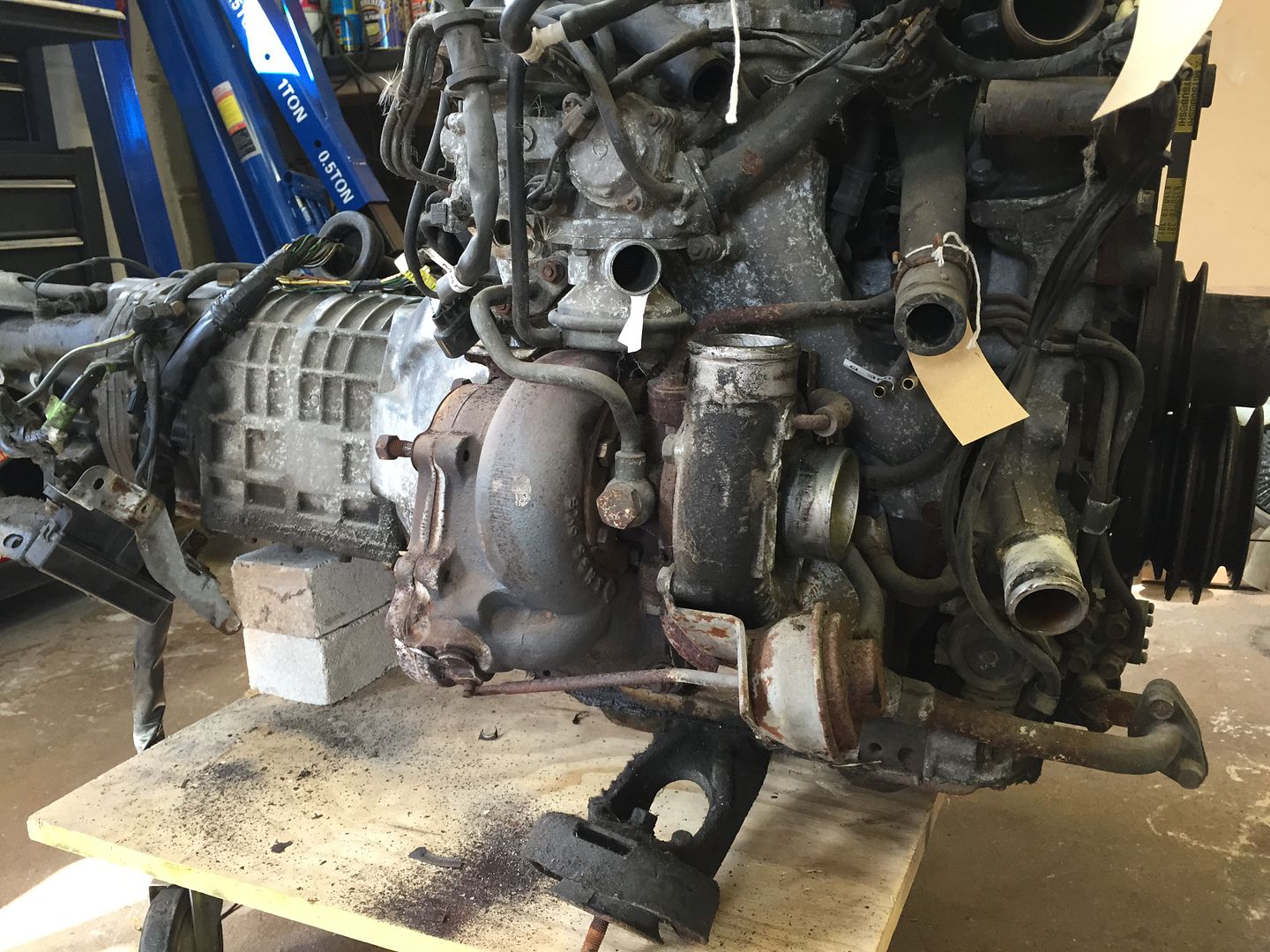

Then the turbo heat shields, downpipe and oxygen sensor...
And finally the turbo itself...
