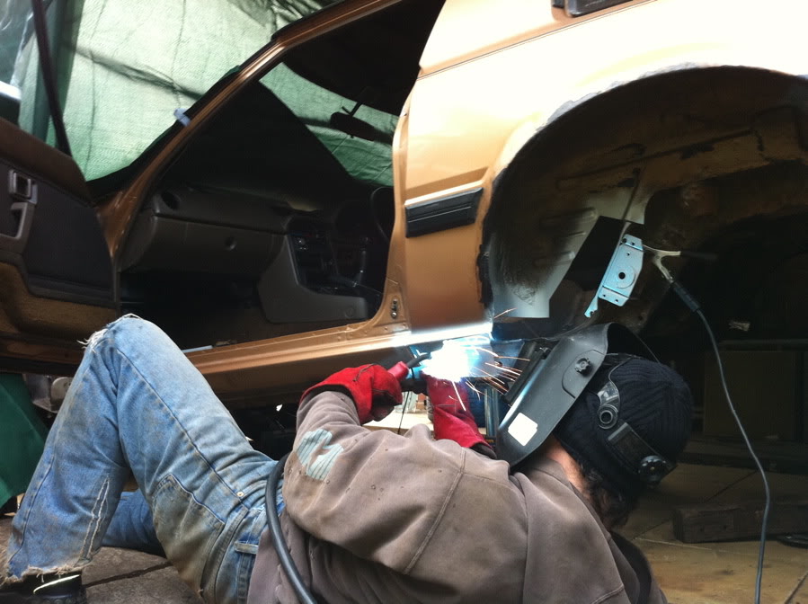

Is this part easy to find new overthere? How much is it? The upper control arm mount. it looks brand new and I need them for both sides, Thanks in advanced.

That upper control arm mount was just the original one cleaned up. The outer plate was rotten but the inner plate was fine.
As far as I know there are no repair panels available. I made all mine from scratch.
