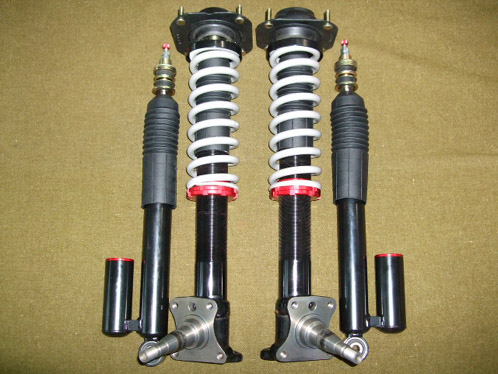

So after reading this thread a few times my understanding is:
MR2 mk1 Rear Shocks for the FB Front
Mustang 79-93 rear shocks for the FB rear
Is this correct? I would like just the straight swap as I just bought some super low king springs from Aus. The welding and chopping and camber plate mods I read from the links seems like more trouble than its worth.
Thanks
Re: Suspension upgrade / shocks
Posted: Sat Apr 18, 2015 3:27 pm
by biznatch
Thats correct. They were a direct replacement front and rear. Note the bottom fixing on the rear mustang shock is about 1 or 2mm thicker than the stock one. I overcame this by removing some material from the shock instead of splaying the shock mount, if that makes sense.
