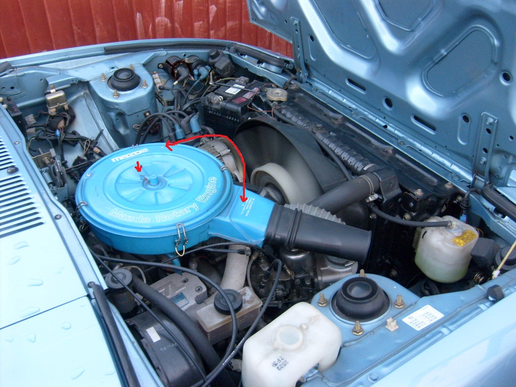

please turn your aircleaner cover only for professional look, because I have replaced your leading spark coil :D :D :D
great car if you ever visit germany (I know you like visit other countries) would be great do it with your Elford and give me some info.
