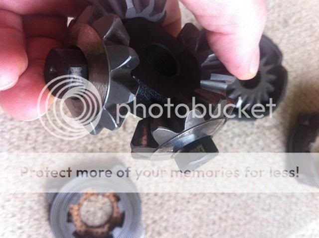

Hi guys,
I thought I would show you a few pics of the FB clutch type LSD.
After removing the diff centre from the carrier, take the centre and remove the 4 screws keeping the top on the casing.

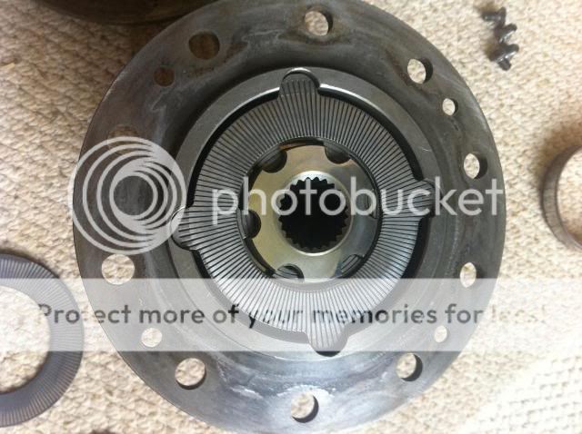

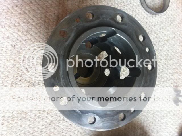

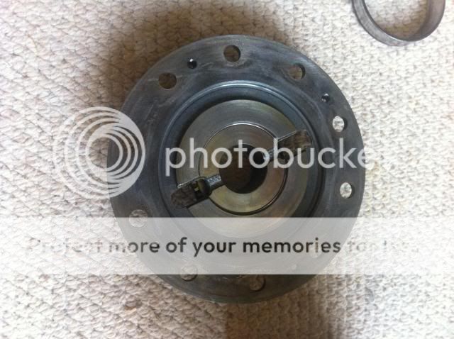

Here is the inside of the top. The inner ring is where the thrust washer sits. The next ring is where the cone spring sits.
Here you can see the copper thrust washer and cone spring in situ.
And this is what they look like.

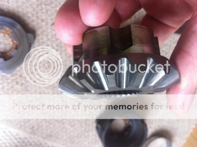

Here you can see one of the clutch plates from the stack, with the splined side gear. These side gears were used in all 10A and 12A powered rotary cars up to 1983 and are very hard to find now.
This is the clutch stack
And this is the surface for the inner clutch stack.

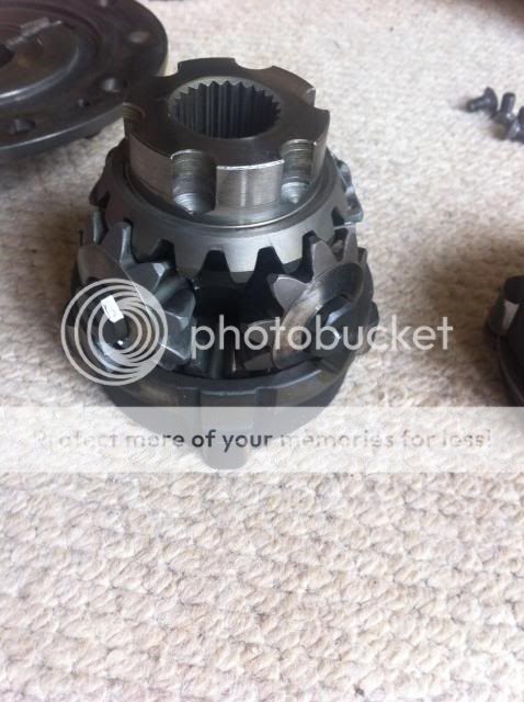

Here’s the spider gears.
And the main LSD casing.
Check and inspect. Replace as required and reassemble. It should look like this again.
