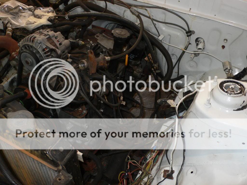

Here are a few pics of the engine bay bfore and after....
BEFORE:
AFTER:
BEFORE:
AFTER:
When I do a full body restore, I want to make up a full custom harness for the car as well as do a full cable tuck and DFIS but that is a while away still.
