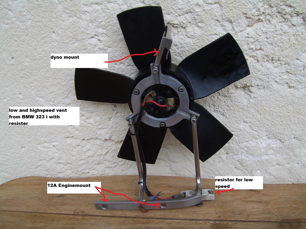

I couldn´t follow all your arguments exactly. But i found out first the hysteresis of the switch point are very important. And second two different position of the
two sensor.
As ian say outlet engine the first switch point will start the vent in low condition. The second switch point (top) on the engine inlet start the vent to high level if the temperature reach a higher point.
Waterflow is from front to the rear in the engine. Oilflow is from rear to the front. Engine cooling with oil, water and important too waste heat.
ou can see the parts i take for a long time (100000km) in for tests in the 90ties.

Forgot to say the BMW 323 i Ventilatorrad is on the exactly same position as the visco ventilatorrad.
