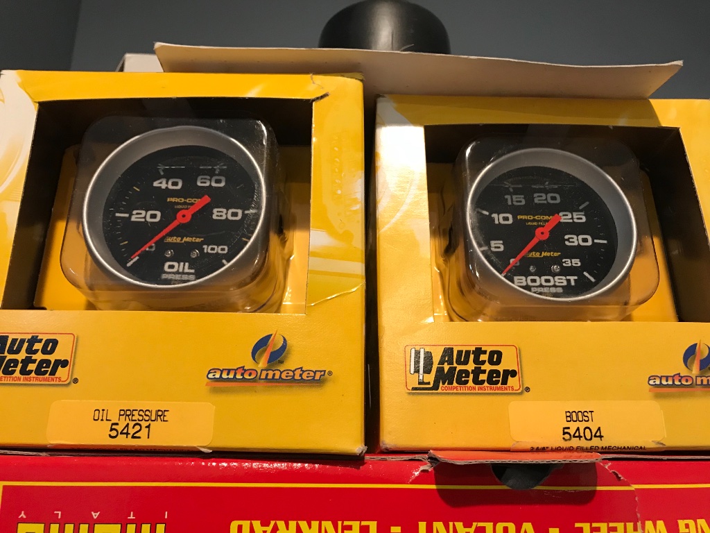

Re: 84GSLSE 13BREW Swap build
Posted: Fri Feb 02, 2018 1:40 am
by DWNUNDR
Couple more little treats...
