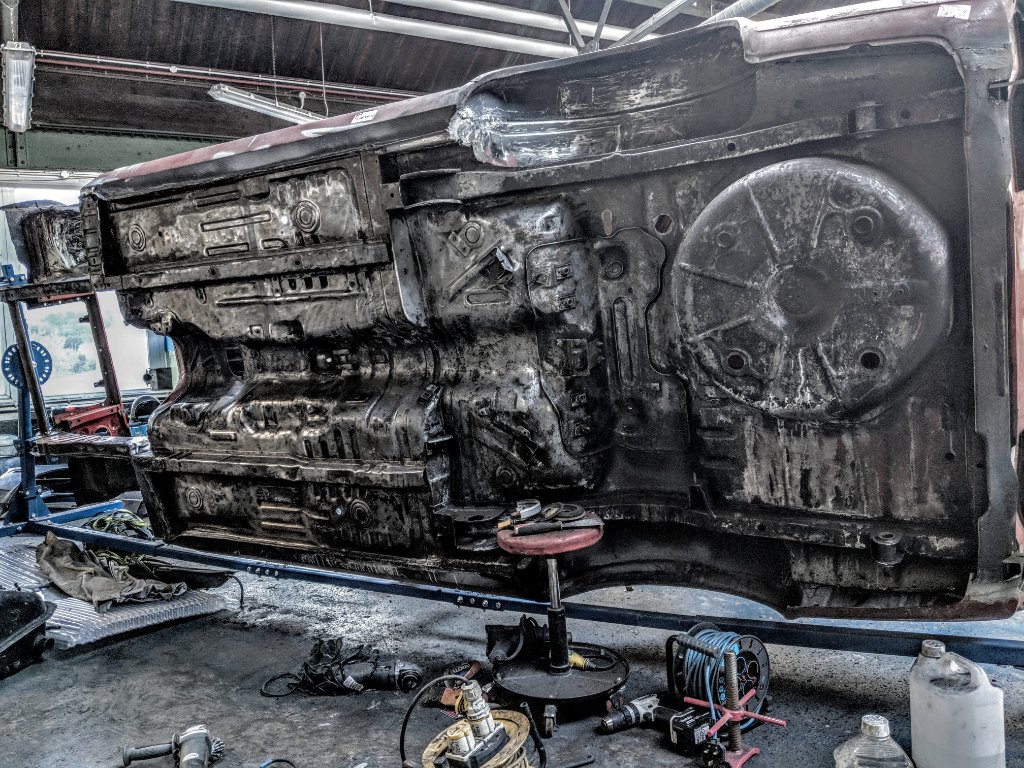

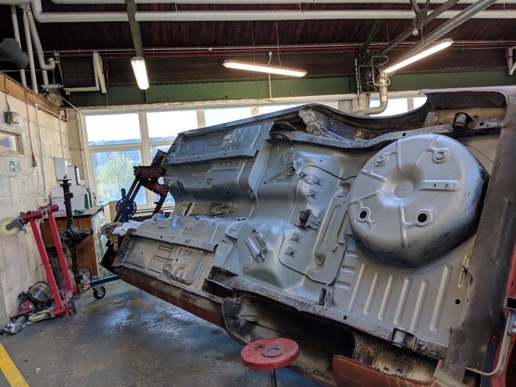

So I've hit the 50 hour mark with working on the underside and this is how it's looking, still needs more work though. :shock:

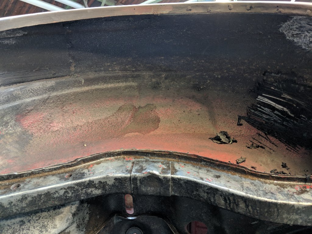

Before scraping the sealant away on the arches

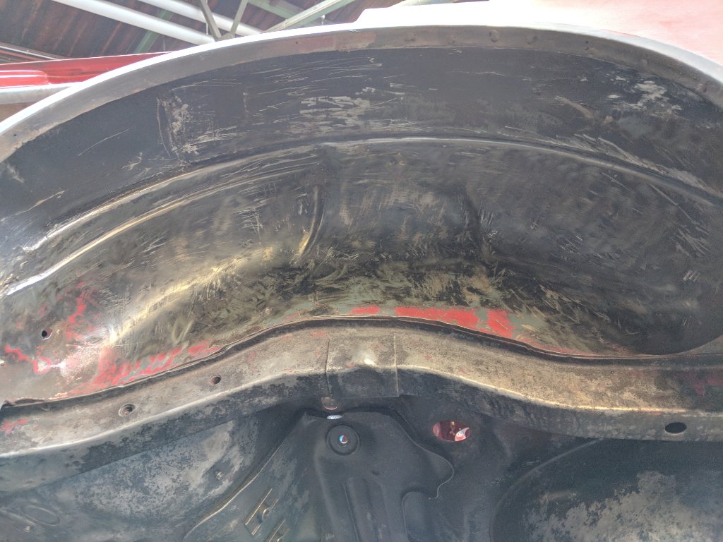

Going to smooth the wheel arches

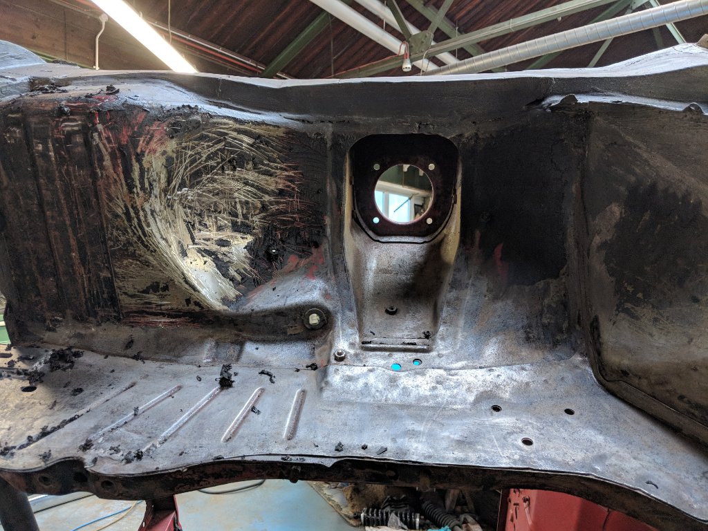

More
Before
Before
Front arches still need working on
More detailed picture of the underside

Certainly looking good underneath! All the hrs of dull work now will pay off mega dividends when the projects finished!!
I think your definition of 'not alot done' and mine are completely different!! h:

It's getting there Rich! I'm using a phosphate rust converter that's really strong and burns the crap out of my skin and slowly grinding it all off and applying more.

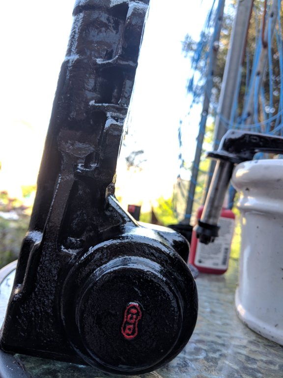

First coat of zinc primer on this evening and all my super pro bushings have arrived.
Spent a good few hours trying to remove the Lower control arm ball join, ended grinding the this off and pressing it out lol.

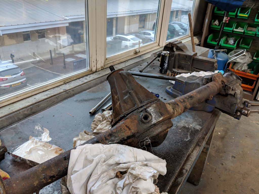

Did some welding last night on the underside covering up the bad welding and pinholes. Also gave it a second coat of primer.

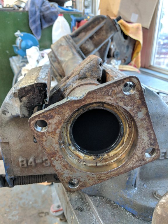

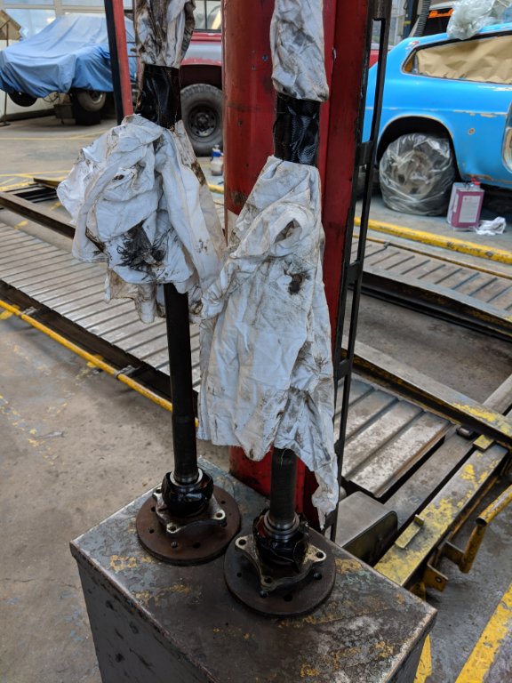

Started to refurbish the diff, sending the axle ends to be drilled and taped to 114.3 to match the fronts. And fitted the lower control arm ball joints (nightmare to get out the old ones were!)
