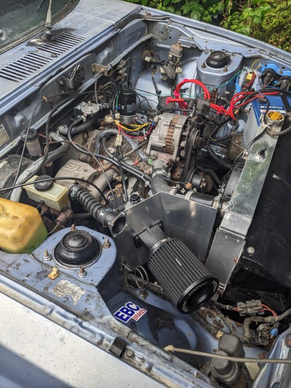

In my quest to make the bloody thing run, I've now gone back to a hugh pressure fuel pump and a malpassi fuel regulator to stop it blowing past the float.
I've reset set the carb again and fitted an AEM Wideband AFR, according the Australian rotary forum it should idle around 12-13 with wide open edging towards 14.7. Rich is best the consensus says.
After letting get nice and hot few twists of the screws and it idles happily at about 950rpm and 12.8 - 13 on the AFR.
Coolant gauge and fuel work again but now the voltage one doesn't and I'm only getting battery voltage at the alternator, I'm assuming it's not being "excited" so that's on the next list.
I also stole Porters2 idea and relocated the fogs into the rear cluster (thanks for the tip) 0-0
My haynes manual wiring diagrams seem completely unrelated (colour wise) to the car.
Is there a wiring diagram for a series 2 '83 floating about? Got to solve the charging issue!
Here's what she looks like under the bonnet now

you have your afr's mixed up.
You want 14-15 at idle and cruise, 12.8 to 13.2 at WOT, and gentle acceleration somewhere in the middle.
You can keep both reverse lights with a fog light with a dual filament LED that does red/white lights.

Oh and lower number is richer, higher number is weaker/leaner

gt_james wrote: Wed Jun 21, 2023 9:00 am you have your afr's mixed up.
😬 Tbh I probably shouldn't even bother until the alternator is out putting a charge voltage.
Think I'll get it tuned on the dyno around the corner, once I've sort the alternator to charging. It pops the "engine" fuse in the fuse box even a 30amp (hp)
