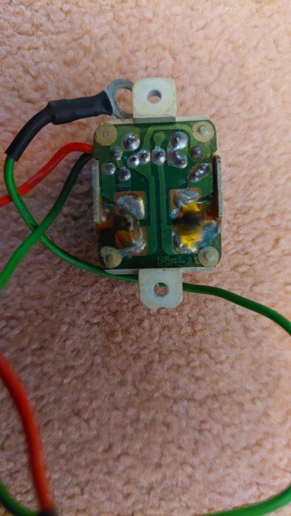

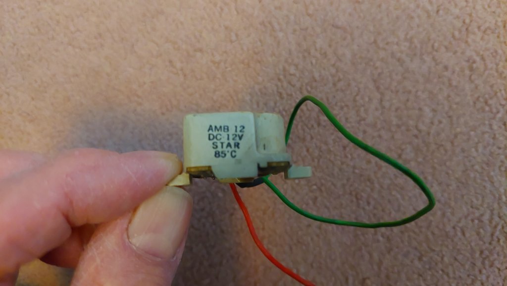

The low fluid levels warning buzzer on the back of the cluster looks like this:
It appears there is some sort of electronic circuitry on the PCB in this sounder. I'm presuming this is an oscillator circuit, as application of 12v DC creates the correct sound that I have heard for low coolant level in my S3.
