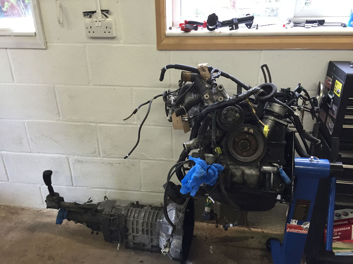

My plan was to run the Elford Turbo setup whilst I prepped the TII conversion but that plan has now gone.
I'm going to pull the knackered Elford engine and begin to convert the car to the 13B Turbo engine...... with that in mind, the prep of the TII engine continues...

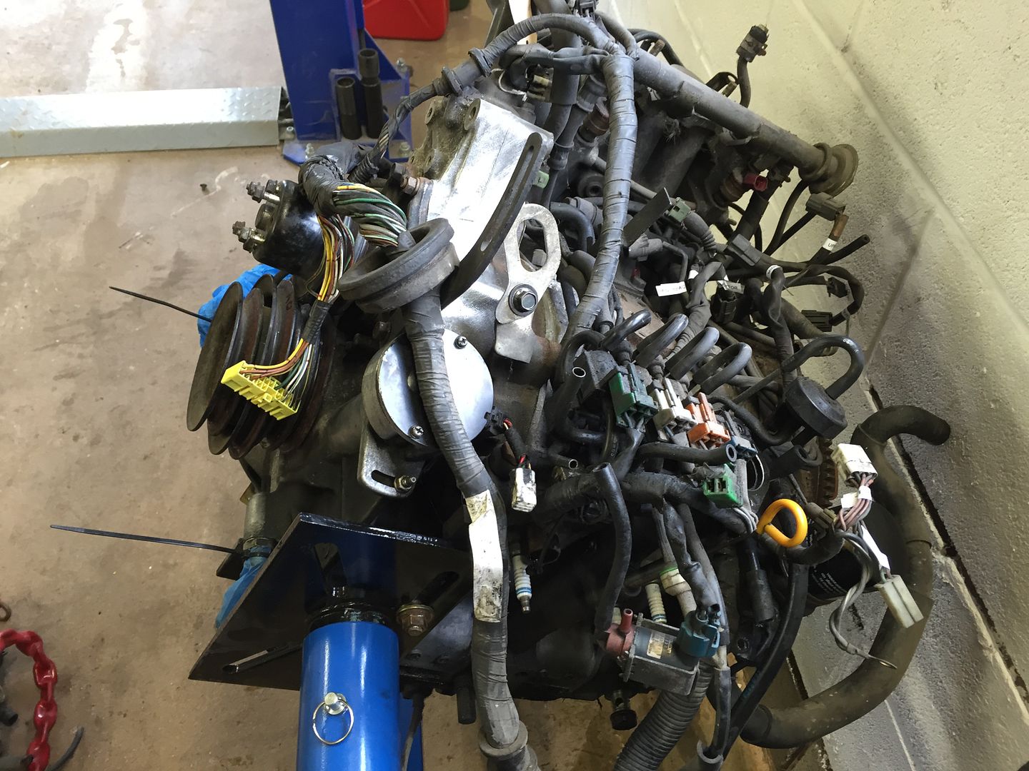

I've got it onto the stand but need to make an adapter bracket.... I'd like one from Pineapple Racing but the shipping is too much to the UK.... still, it's ok for now....

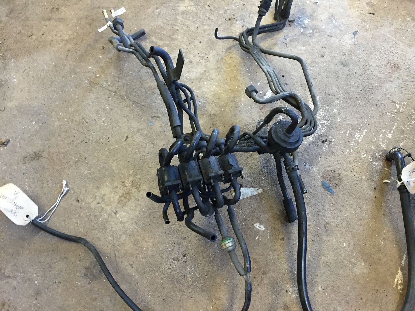

I'm following Aarons guide to Megasquirt it so I've pulled the rats nest...

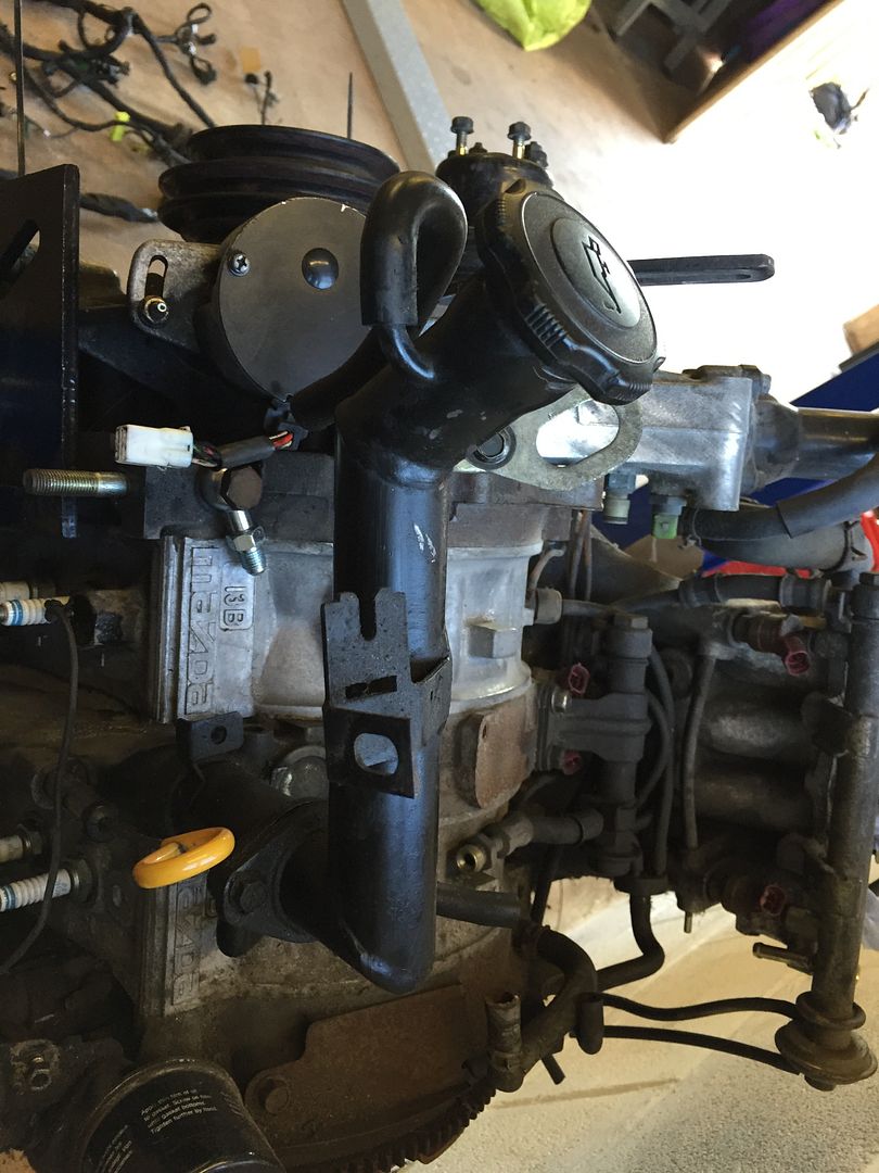

and I've taken the UIM ( upper inlet manifold) and throttle body off...
and the engine loom...
need to remove the LIM (lower inlet manifold)
