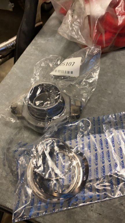

the ring on the clutch coil fell off allowing the bearing to pull out of clutch... aka no pedal.. had a spare (original) that I threw in as I had a couple of car shows on sunday...
well on the way to the second show I lost the clutch again... had to drive 30 miles home with no clutch.. the 7 sets of traffic lights were fun haha as was crossing the freeway using the starter and first gear hahaha
luckily I remembered I had bought a new bearing and a buddy picked up a new cage locally (didnt throw in on weekend as we were doing suspension and exhaust on a mates wifes rx7)
hope to throw these babies in tonight and be back on the road to get the tuning finished off....

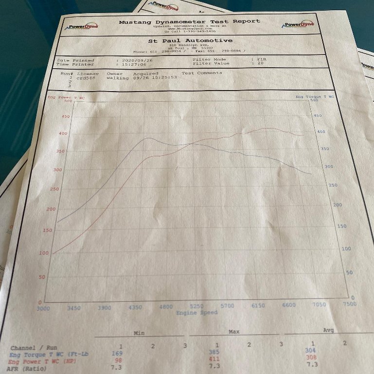

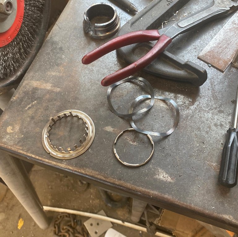

Well saturday started on a crap note.. heading to my sons soccer game with plans to hit the dyno after for 3 pulls for $30... 5miles from home pulling a 3rd gear log and lost the clutch pedal for the 3rd time in 3 weeks.. had just replaced the throwout bearing and little clutch ring/cage.. raced home after soccer and fixed the clutch... little over an hr to pull the little ring etc, straighten and fix, fix a starter bolt that stripped, put it all together, screw in a bolt in place of the clutch pedal stop... I think the clutch was over pushing so stopping the pedal travel may have fixed it.. thanks again @kevin_btz for problem solving across country.. hit the dyno after a quick little sprint 40miles to event.. ended up with 412hp 385tq on a mustang dyno.. low boost as the diaphragm is leaking on wastegate and didnt log so not sure what boost.. going from previous logs it dropped to 14-16psi... aiming for 20 or maybe 25psi.. and the car made it home.. yay
