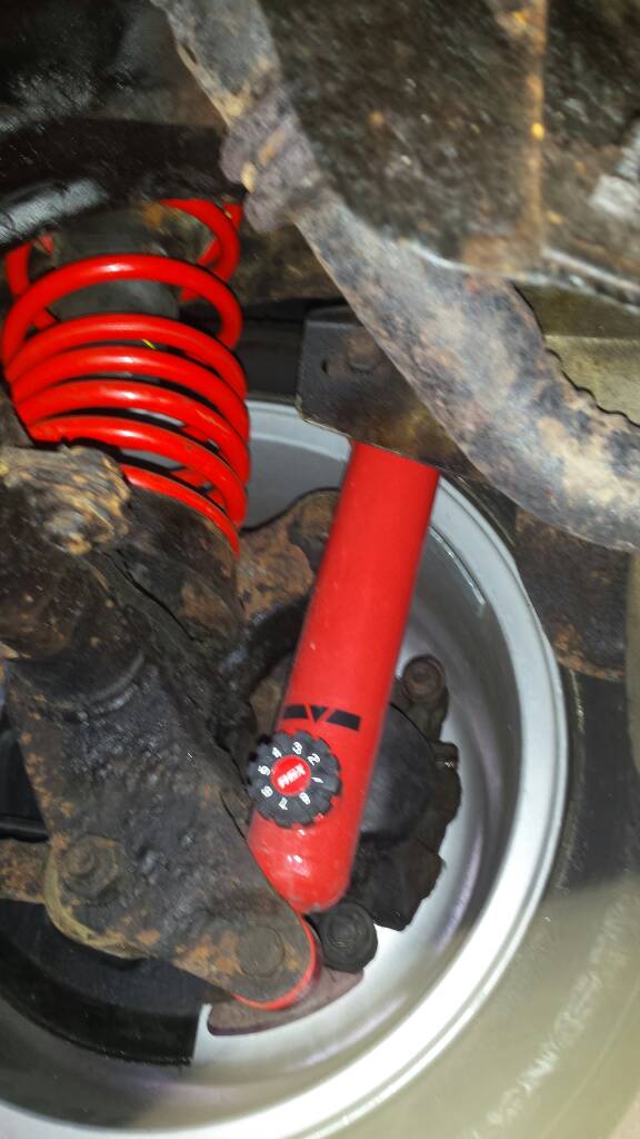

One more pic for good measure. ☺
- 20140831_143739_resize_20150418_151546.jpg (64.4 KiB) Viewed 11159 times

Cool....Where did you buy the MR2 and Stang shocks from? Would you recommend them? Do you think the adjustable option is worth it?

I ordered the Stang shocks from the US. The MR2 ones were Koni sport ones which I managed to get in the UK.
As for recommending them, they seem OK but ive only put about 30 miles on them since taking the car off the road and I had bottoming out issues at the time (which turned out to be the bumpstops) ... They are definitely a firmer and better ride than my old worn out stockers though.
