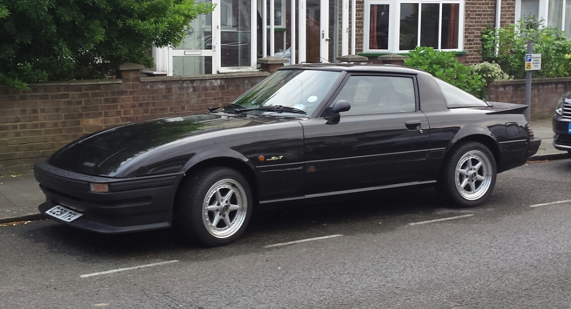

Sneaky peek with the new front bumper but before the front suspension work
- 2014-04-27 22.48.06.jpg (528.9 KiB) Viewed 8079 times

Sweet As .....
10 hours is an marathon effort. My car decided to hang on to every nut and bolt for dear life. Almost every securing piece of hardware had to be cut off, nothing was moving! Except for the watts linkage which simply fell off ... all seized up of course.

I cut of the strut over the license plate to get more air circulation. You must do it befor your coloured it black.

I hadn't thought of that Thomas, might give it a go since I want to do some more fine sanding to the front bumper before spraying. Lucky for me I can check out what it would look like by seeing the pics on your thread
