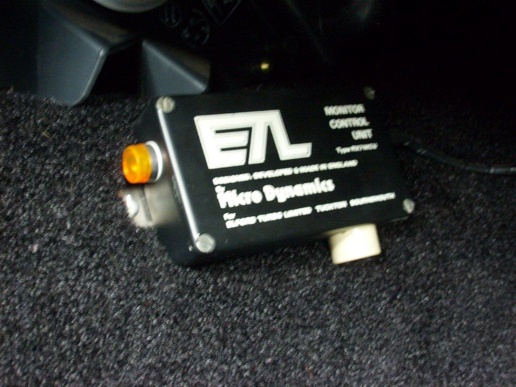

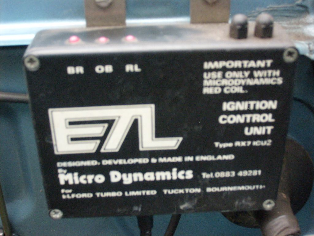

I haven't checked over it yet but I do know there is one unit connected to the engine bay bulkhead and also the IMU on the gearbox tunnel - so it suggests both are fitted.

Over the years, they used 2 different systems:
1. ignition control unit which actively controlled the ignition by retarding the timing and limiting the revs
2. ignition monitor unit which wasn't actually wired into the ignition at all and didn't adjust anything, it just monitored the boost level.
This was because early conversions used a less reliable wastegate system to safeguard the engine and dump any excess boost... in case it failed, the ignition control protected the engine.
Later conversions used a much more reliable swing arm wastegate and elfords decided the ignition control unit was no longer necessary.
the later 'ignition monitor unit' didn't connect through the ignition at all and just provided a light and buzzer if the boost got dangerously high ( due to a stuck waste gate).
If your car has the early, all singing and dancing unit Cliff, it'll be in the engine bay on the bulkhead. If it has a later ignition monitor unit, it'll be in the drivers foot well, fixed to the transmission tunnel. Logic would say that they wouldn't fit a Microtech red coil with the later unit as they don't connect to it but I've seen a few elfords that have both.

Pics of both Control Units

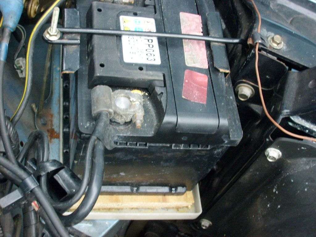

It seems the best way to fit a smaller battery is to put a block of wood underneath it ....
or perhaps it would be better to replace it with the correct sized item
Re: 1983 Elford Turbo - Ex Patrick Motor Museum
Sure that isn't a Mazda Special Accessory, Part # RET-00034-00-87 (battery spacing auxilliary tray grommet [wood])? :? Might be a very expensive and OOP genuine article :lol: Check it carefully for a part number, then flog it on Ausrotary for $400 ;)
