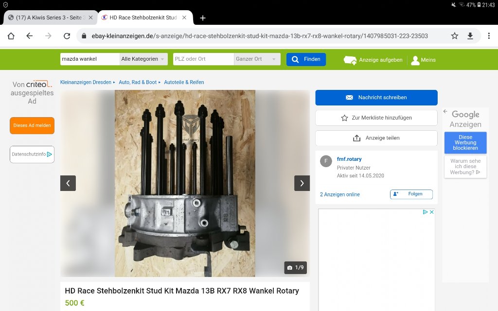

I am so sorry about the engine fault. Perhaps a race stud kit will help too. BTW i take the slightly higher racing beat torque for the stud.
https://www.ebay-kleinanzeigen.de/s-anz ... -223-23503
https://wankelmotorguru.de/WaMoGu-13B-S ... escription

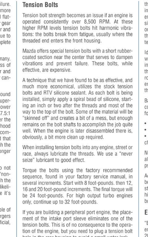

Found these 32 foot-pounds advice from racing beat, hope it helps Jesse.
Screenshot_20201126-063950_Adobe Acrobat.jpg (112.08 KiB) Viewed 16075 times
