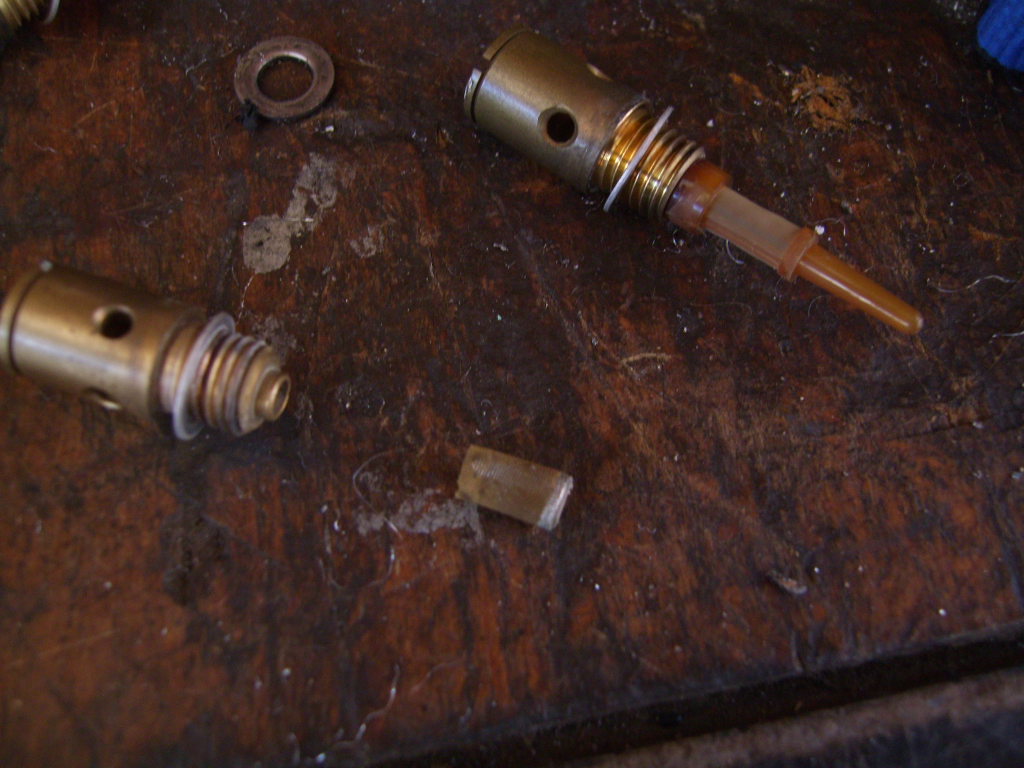

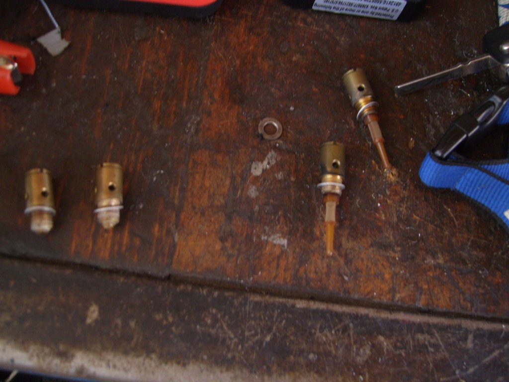

				Ian you talk about these filter. Two different are possible.
						- SV100370.JPG (172.27 KiB) Viewed 4410 times
						- SV100372.JPG (173.5 KiB) Viewed 4410 times
