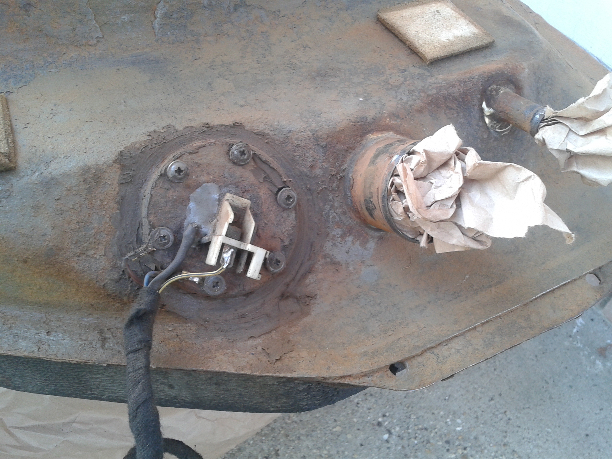

- I had my fuel tank cleaned and painted from the inside and the outside. My aim was to properly clean an treat the inside of the tank, but during the work, it became clear that the outside needs some care too. As I had a very limited time frame for the work, I could do the inside, but on the outside, I couldn't have a "permanent" solution, but it will be ok for 2-3 years I guess. So, after detaching the tank, I first evaluated the damage. Some areas (mainly the sides) were quite rusty, but I think it was not a big problem. However, I found some tinkering unfortunately. The place where the fuel level sensor is attached (I dont know the proper word) was removed before, but when they put it back together, they drilled the holes to make them bigger (or I dont know), and they drilled also into the tank. Ad to get it sealed, they used some siloplast
The way I found it
The way I found it
2014-03-15 09.43.51.jpg (1.45 MiB) Viewed 3734 times
. I also found a broken bit in the tank... Then, I roughly cleaned the outside with brush and sandpaper to remove the most of it . Afterwards I thoroughly cleaned, surface treated and painted the inside using POR-15 fuel tank repair kit. When it was finished, I applied some chemical rust removal on the outside, and then painted it to black. I bought some fuel resistant sealing material and applied it around the flange of the fuel level sensor (had no better idea). I attached some pictures to get a hint about the before&after situation. This work might seem tinkering too, but I'm just a beginner :)
