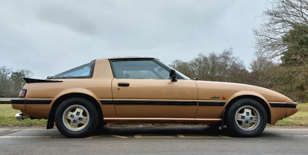

Post by rustyrescue »
Has thanked: 44 times
Re: ongoing re commission of our RX7
Such a pleasure to see that colour. Was quite common in the early 80's but pretty rare theses days
it does look good in gold........interior is classic brown :D
