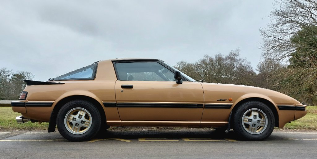

by rustyrescue
it does look good in gold........interior is classic brown :D
