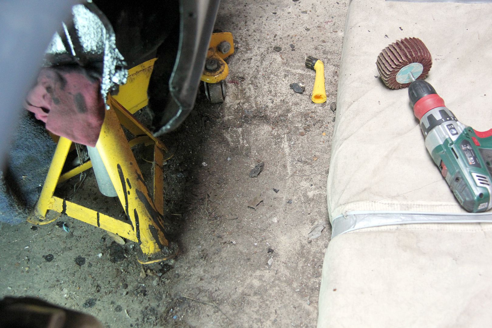

Of course by now the car had done a fair few miles with no liners and I guess it was inevitable that some corrosion had set in. On offering up the new liners I found quite a bit of smeg that needed sorting. The drivers' side was OK (mostly because it was a new wing, replaced after the accident with Moron Boy). The nearside was a bit worse off
It was annoying, but I suppose could have been a lot worse. After all, as we all know these cars dissolve quicker than an Alka-Seltzer if you let them get away from you. It didn't look tooo bad to me, which was just as well cos I didn't have time for a long protracted off-the-road clean up marathon
the best I had time for was to whizz off all the rust I could, treat it with convertor and slap a load of our ol' favourite POR15 on top. And to be fair, it did take quite a lot of wire brushing...
but it's amazing what a good couple of coats of POR15 can hide
that'd have to do for now. And yeah, you just know that's going to come back and bite me in the arse sooner or later, don't you?
