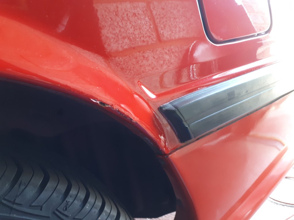

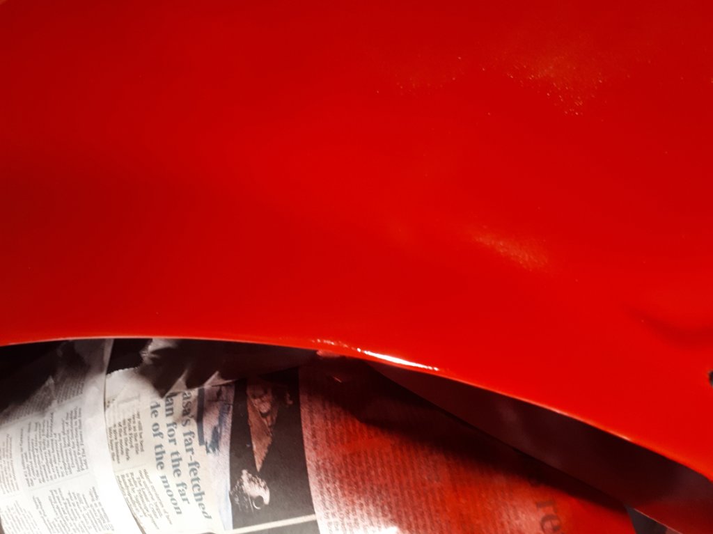

I've been attending to some arch corrosion - happy I've cut out the problem and treated the area, but not 100% happy with my 1st attempt at the shaping and finish. It'll do for now, but will have a 2nd attempt to get a better result.

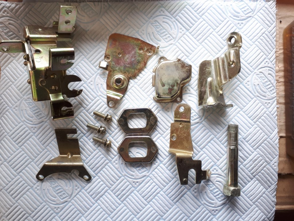

Did some more plating of spare carb pieces and other bits - reasonably happy with results. Yellow passivation better than my previous attempts!
One of the pieces before:
2020-06-03 16.05.19.jpg (136.81 KiB) Viewed 6789 times
Several bits after zinc plating and yellow passivation.
2020-07-09 16.41.04.jpg (232.97 KiB) Viewed 6789 times
Re: KIMI 3 - 1984 Series 3
Posted: Mon Jul 13, 2020 9:11 am
by DKWW2000
That is good Malcolm, a couple of coats of some colour polish over the top & as long as you do not tell anyone they will not notice, suggest you paint some old diesel engine oil on the inside of both arches & leave in hot sun to allow it to permeate into the area. :clap:
Good work on the Carb

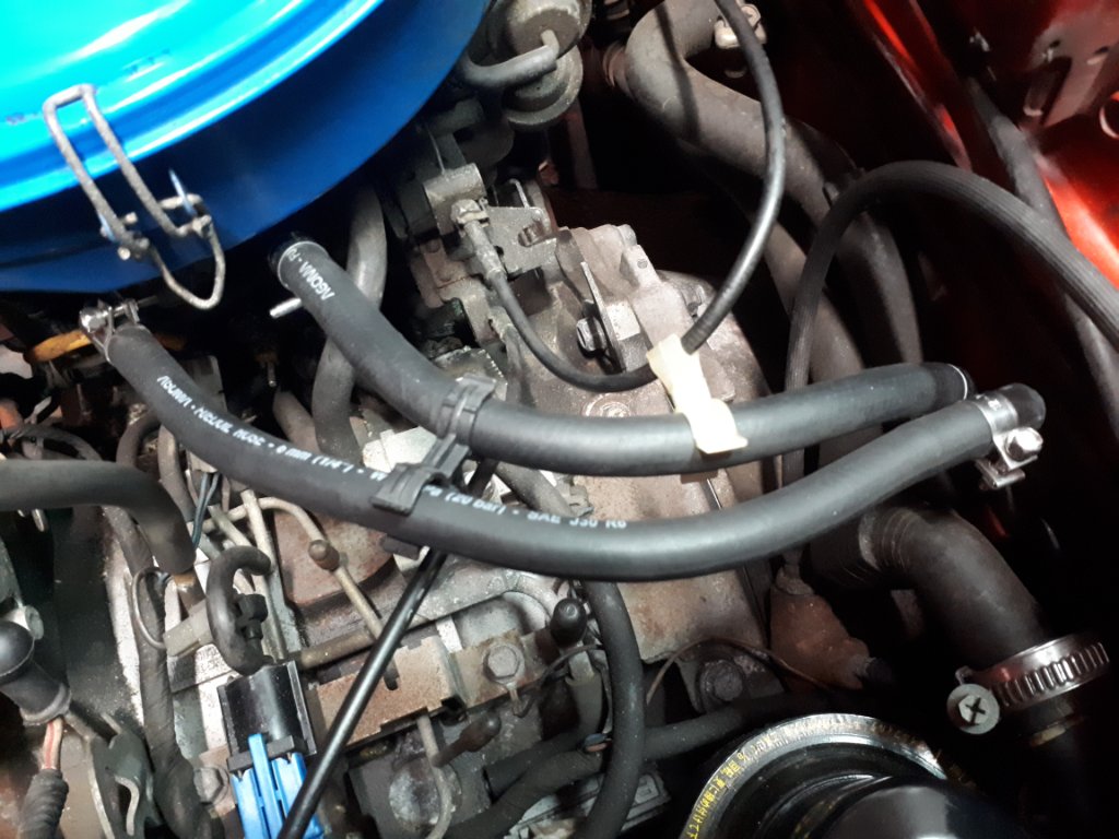

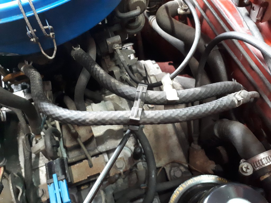

Not much to report, but a couple of satisfying little engine bay jobs done.

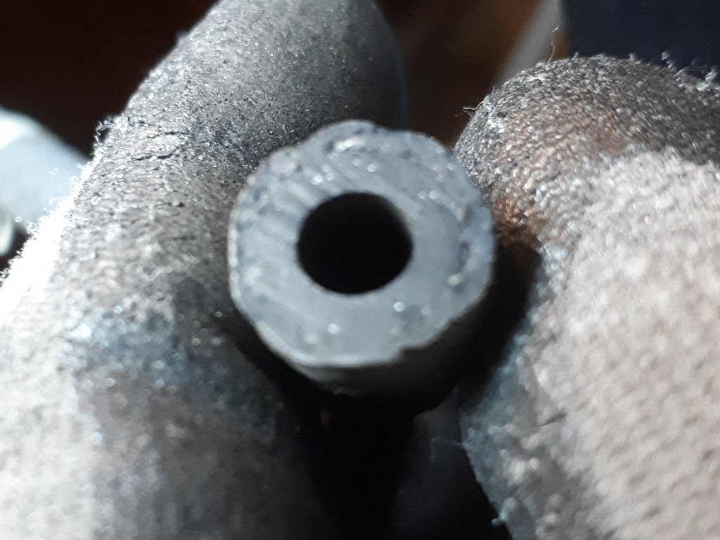

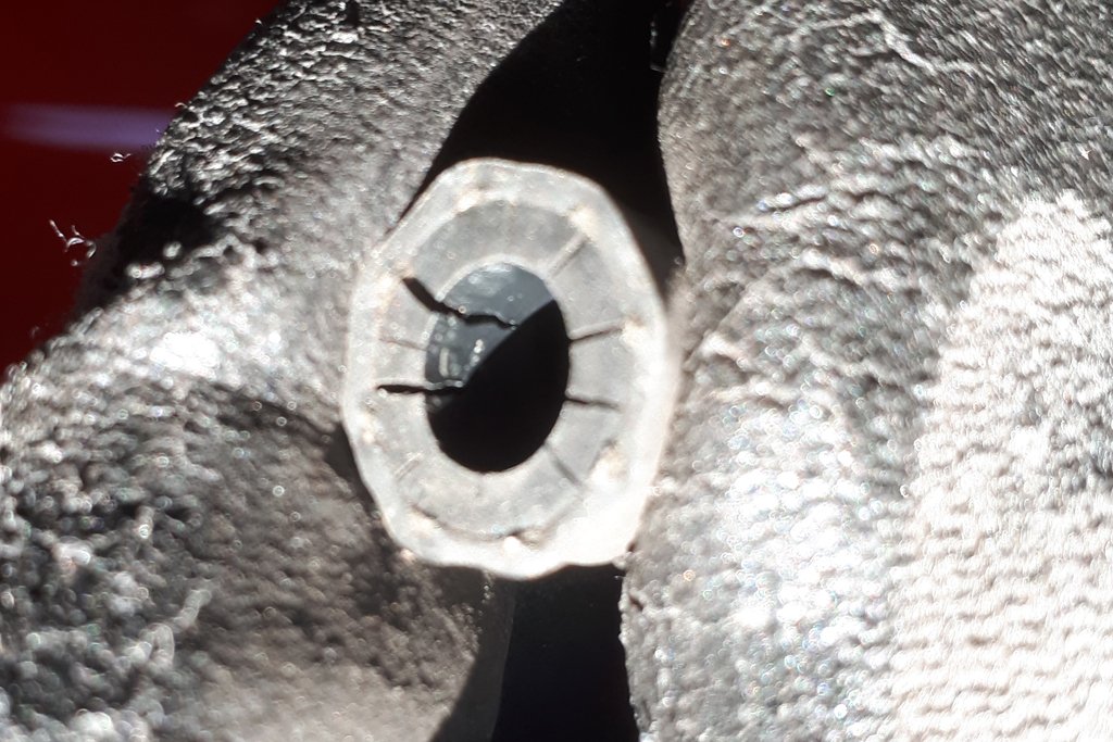

35 year old OEM fuel pipes in engine bay replaced, together with SS fuel clamps. TBF, there was some perishing of the old pipes at the ends:
Fuel Pipe Perish.jpg (186.99 KiB) Viewed 5997 times
But the centre of the pipes were fine:

Before and After:
