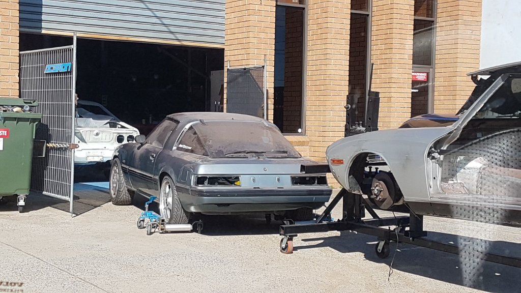

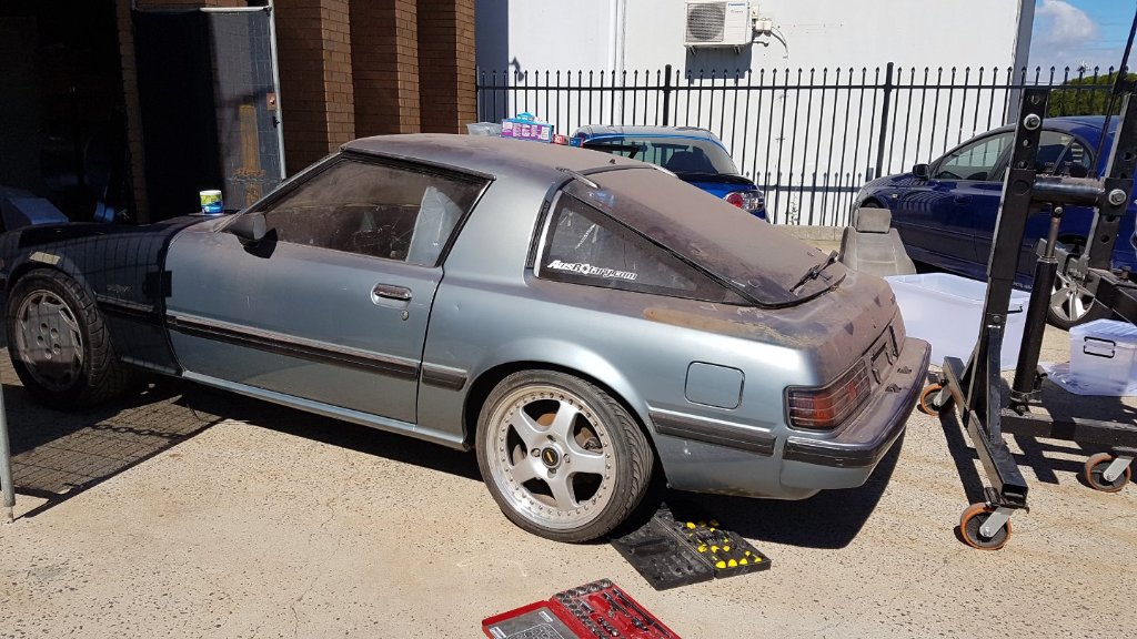

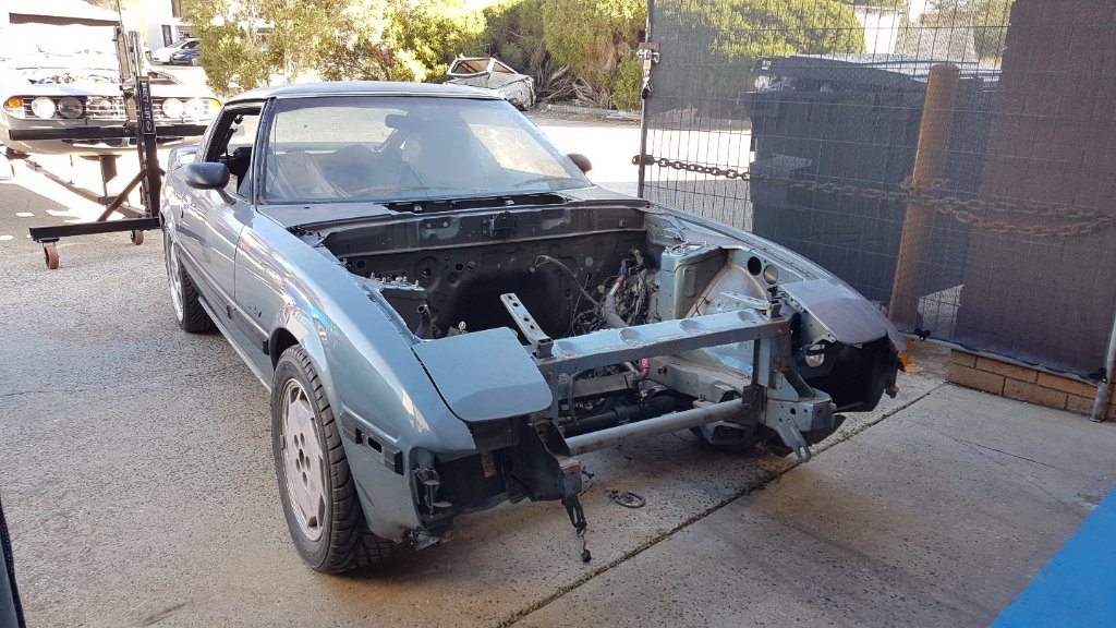

And ramped up things have!
Car completely stripped and spoiler deleted, ready for rust repair and paint.
I've got much more detail on my AusRotary log, but it's time consuming to add photos to both forums. Nevertheless, I'll definitely try to keep updates coming on this board as well.

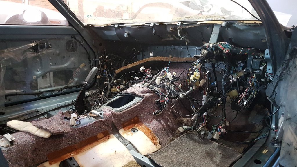

Interior out. A/C and heater box out. Heater tap appears to be gone which explains a small leak I had before I took the car off the road. Luckily I bought a new one from Japan last year, so it should be an easy fix now that everything is out.
Rust mainly affect the hatch sill. Fingers crossed that's the worst of it. Nothing in the wheel arch areas you guys get. Small amount of surface rust in a pillars, cowl and front intrusion bar but it doesn't look serious.
