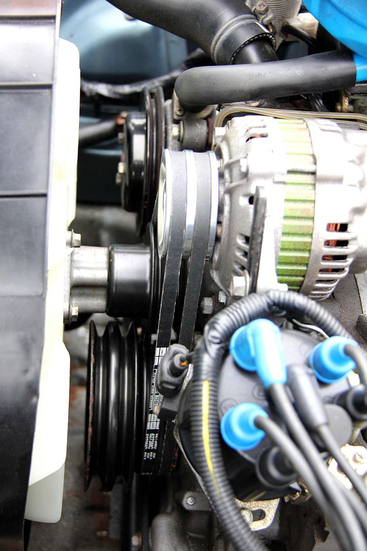

Finally got round to it!
What a lovely piece of bling, and functional too! Winner. Only trouble is now I keep getting urges to polish the alternator and stuff to match. Then I remember what an utter PITA it was doing the FD one and lie down till the feeling wears off :shock:

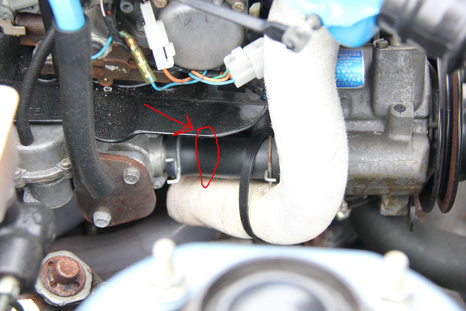

Whilst I've been under the bonnet, I've been thinking (always dangerous, I know :lol: ). It would appear that the airpump is not only completely pointless, what with the header exhaust system, but doesn't even have a drive belt. It would seem to my feeble mind therefore that it's just a gurt big lump of pigiron I could be well advised to throw in the bin. As far as I can see, it's two bolts, then block this pipe;
...block this pipe;
...and chuck it in the bin. Is there any reason why this is NOT a good idea? What am I missing lol?

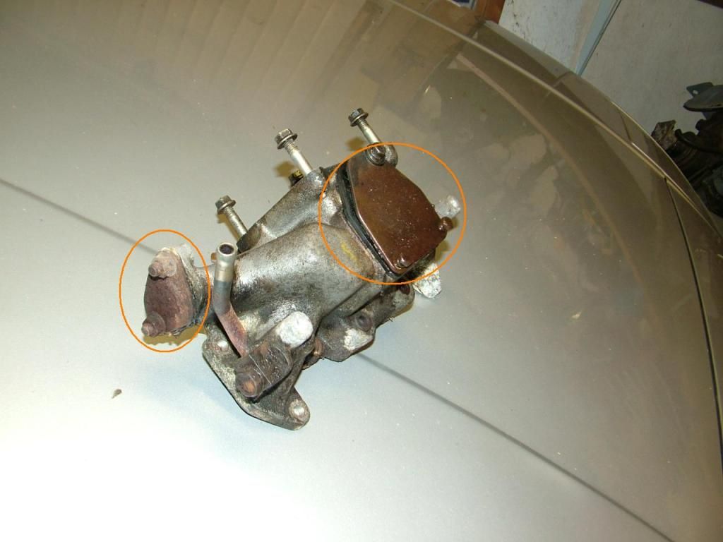

if you remove the air pump, you need to fit 2 blanking plates to the inlet manifold as shown on here...
viewtopic.php?f=33&t=477
that pulley look the dogs.... I'll have to fit mine ( after Keiths copied it)

Thanks for the link, Ian. I have to say, I can't relate that diagram to how the engine looks, but maybe when I get the plates in my hand it'll swim into focus. Any reason why I can't just bung the pipe for now? Don't see where the blanking plate would fit :?

Nik, these pics show the plates in position...
and on these pics, the plates have been removed...

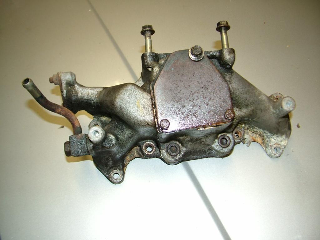

Re: Lucky's Series 3
Thanks again, but unless I'm being really thick here, isn't that mani bit different to mine? No matter which way up I look at it, it doesn't seem to match up. Sorry to keep on being stupid, but is this blanking plate
The same as the one on mine already?
If so, that hose union from the airpump looks completely different :? I guess I need to leave this till I have the manfiold off to fix my water leak, anyway, yeah? Is there another connection from the pump other than the two hoses I highlighted earlier that you can't see without stripping everything back? Hopelessly confused now :oops:
